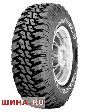

Actually based off the Goodyear Wrangler MTR. Awesome tire overall, I have driven them in like 3" of snow and they held their own. Probably go up from the 245's to 265's once I get my lift in the truck. I have had people tell me the 265's rub in their trucks but each person seams to have a different experience.
Attached Thumbnails A/T tire shopping-goodyear_w_mtr.jpg
