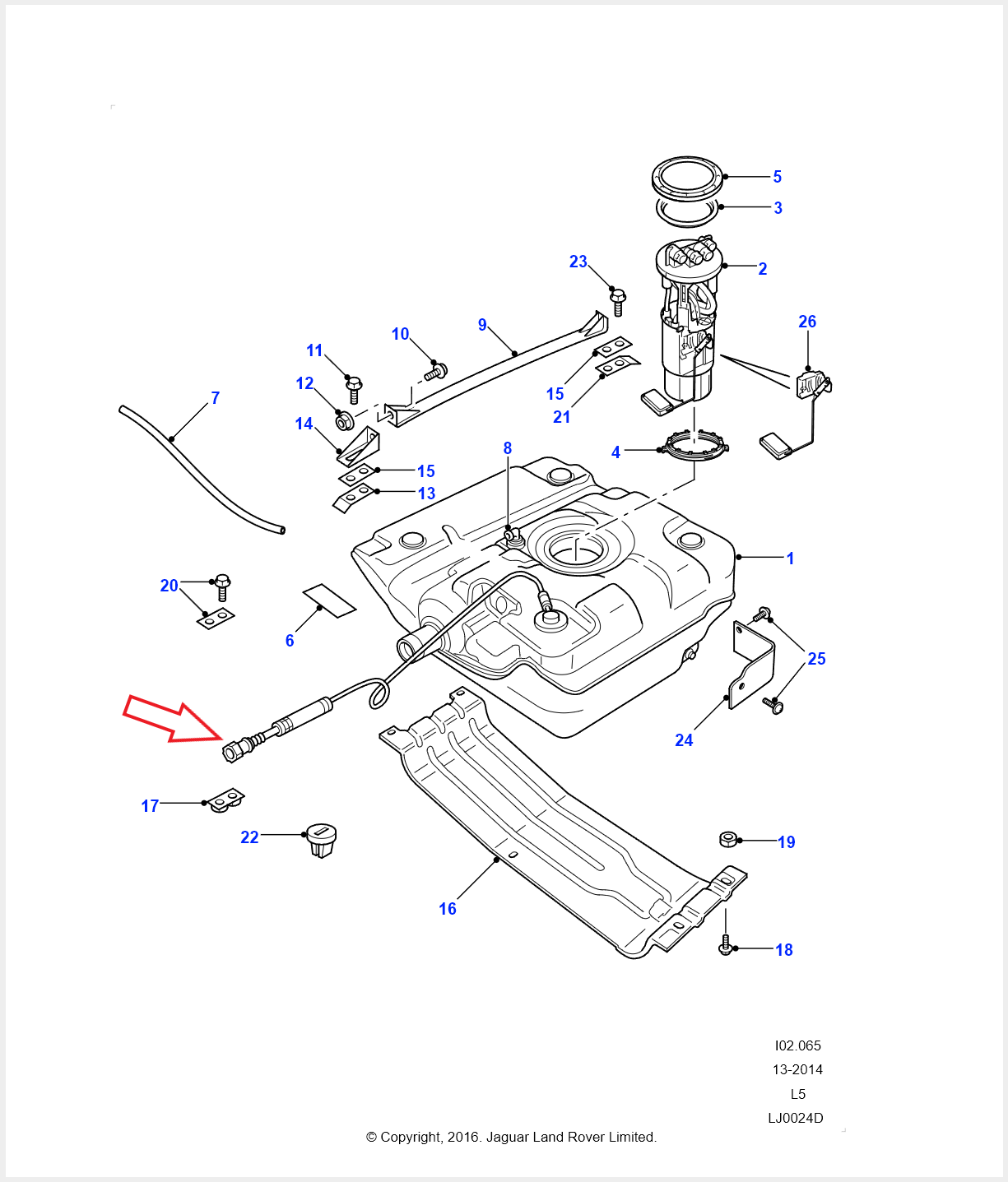

As I have a kind of similiar issue on mine, I have scoured the internet and have found atleast one culprit.
Look for a small breather hose from the fuel tank to the fuel filler.

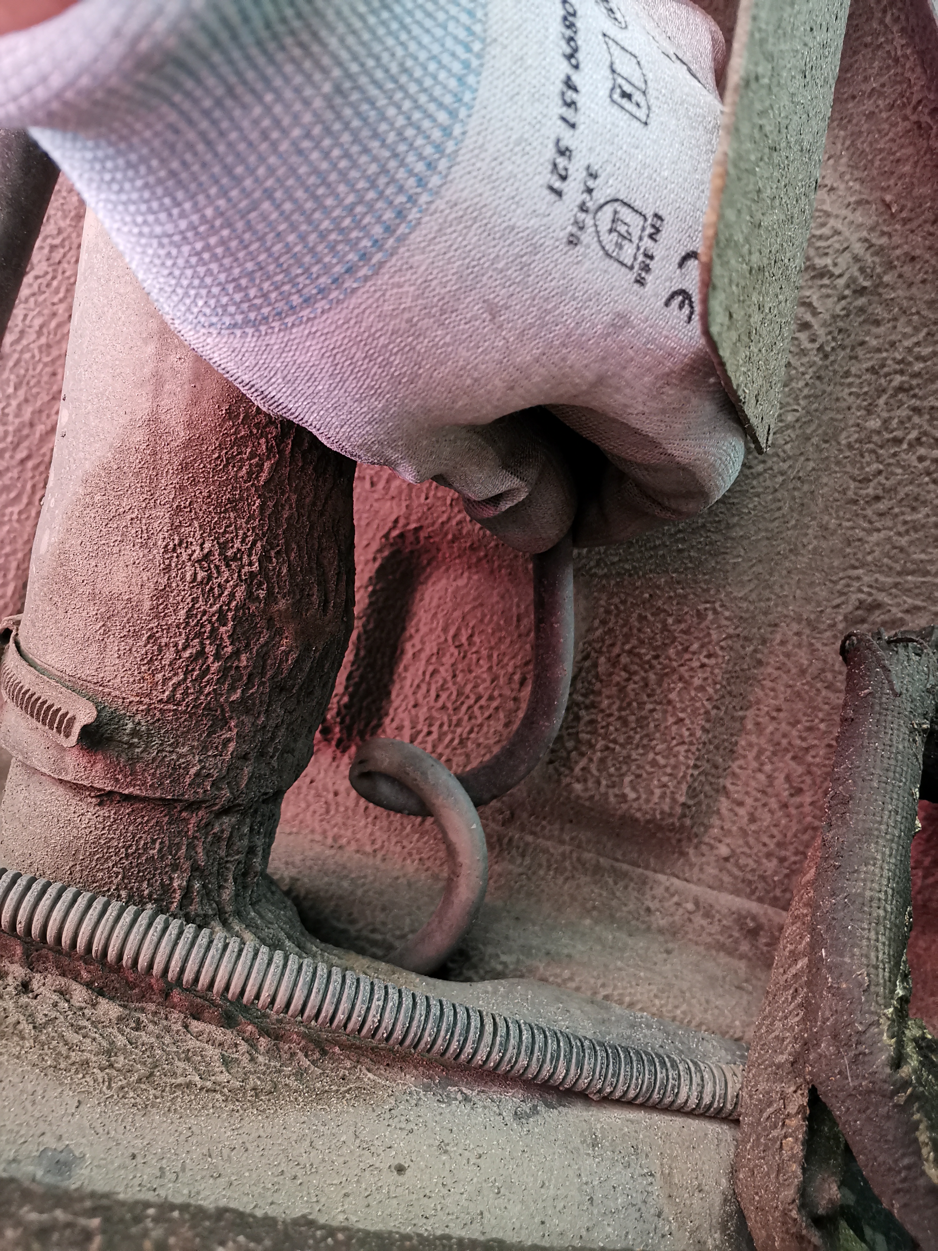

On my TD5 that loop is smashed and this seems cause the fuel to "run out" even if I have over a quarter left.

Putting a spring over it MIGHT help to bend it back, but it would have to be quite robust, and the hose would probably need to come out for this. And as it's not a soft hose, more like a pipe, it might not help.
If I just could find a new/intact one I'd be happy. All the scrappers seem to cut it when removing the fuel tank.
