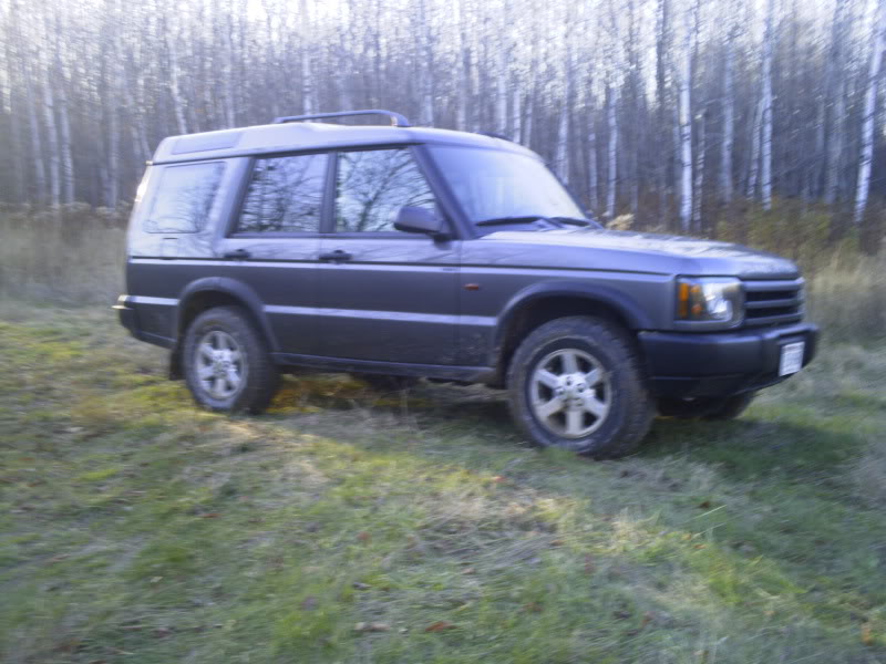

In tears over 03'
oil warning light intermediate, cant afford new engine. I dont want to sell it, butIi can't see how I can keep it!!!
