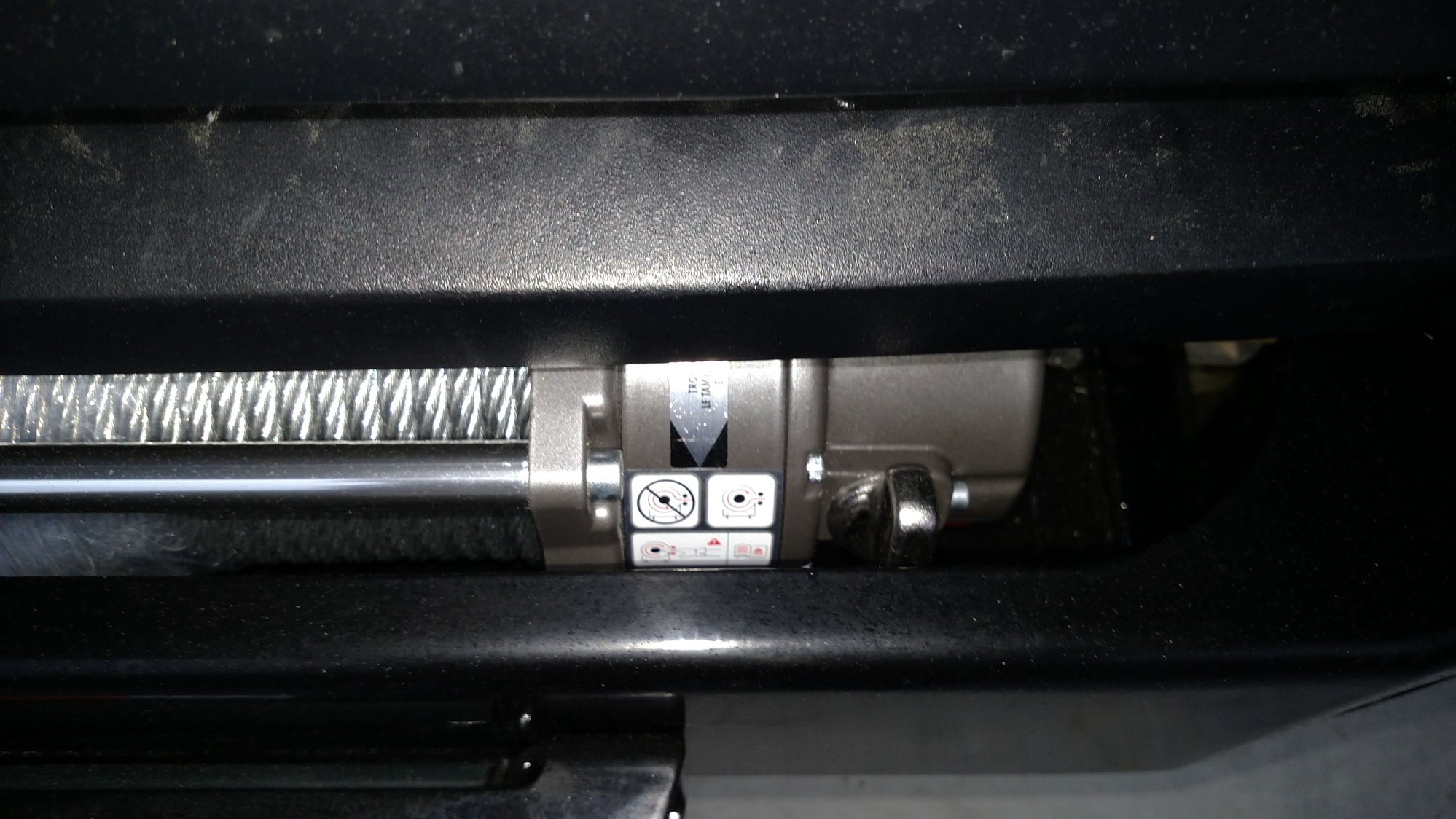

Best4x4, how do you access the winch clutch handle?
I have a cutout in the grill for the clutch handle but not for the solenoid. Will you just pull the grill on the hopefully rare occasions that you need the winch? That's one of the nice advantages of the '03-'04 grill that I too went with; there is no direct connection to the headlight finishers so the grill can be lifted out easily.
I went with an Albright-style contactor instead of the old-fashioned Warn solenoid pack I had and mounted it behind the grill so I didn't need a solenoid cutout.

I simply unbolted the side of the winch with the lever and rotated it down. I will post a pic when I get home, but on the Warn M8000 you can rotate the side with the lever. I knew this because the ARB Bumper instructions for my H3 Alpha showed how to do it.

The Warn M8000 is honestly a perfect fit with this bumper. Then rotating the assembly down with the lever makes it accessible without having to hack the grill. It's not a massive amount of room, but it's useable and I have medium sized hands.
