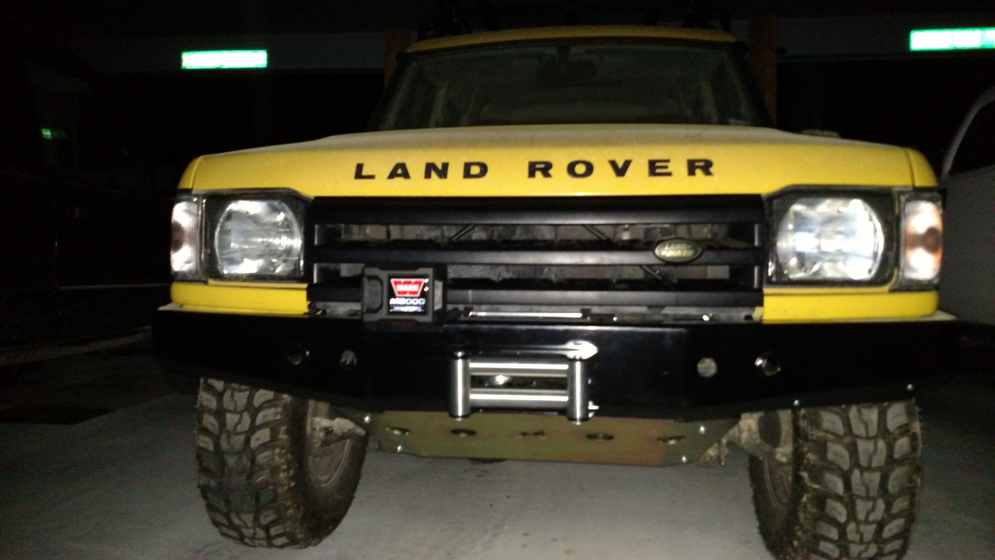

Well I slapped a Warn M8000 into my TF Winch Bumper today. Using an 03/04 grill made it A LOT easier with clearance issues and all I had to do was trim two notches into the lower section of the grill for the ridges of the M8000 to fit into. I wasn't going to place the solenoid box under the hood and cook it here in TX so I went kind of a Jeep setup where the solenoid box is mounted to the bumper just in front of where all the wiring connections need to be.
Yeah if I was a hardcore wheeler and slid off rock ledges all the time it's not ideal, but my D2 is more of an expedition setup vs rock buggy anyhow. I was able to use the Warn Solenoid bracket and just flip it around and drill two holes for the solenoid box to mount up to, then routed all the wires thru the grill and connected them. I consider it a pretty clean install myself.

Pics?

Terrafirma Winch Bumper/Steering Skid & Warn M8000

I like it. That's a smart looking set up.
