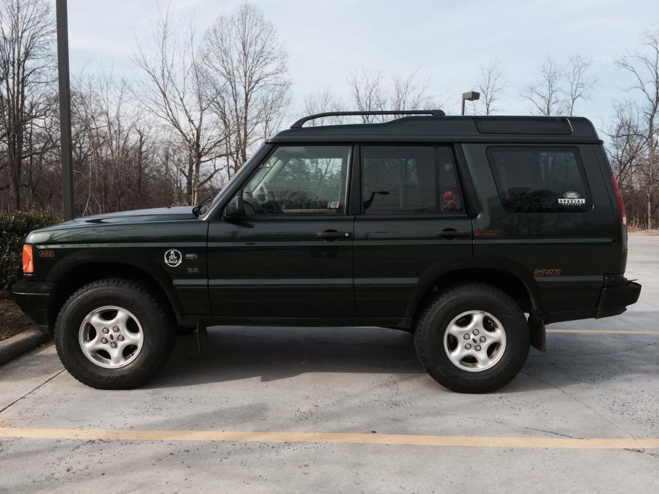

I have the 2" lift kit, purchased from Lucky 8. Installed the extended stainless steel brake lines, but in hindsight I don't think they were necessary. I also fitted 265/75R16 tires, which I think fill out the wheel wells really well (say that 3 times fast). They don't rub, though admittedly I do little off road riding. Can't comment on 18 inch rims, though many on the forums suggest swapping to 16" wheels.
I haven't fitted the offset radius arms - not sure they're necessary but have considered them when I have an extra $400 floating around. Did not use any spacers - I think they would cause you grief by requiring brake lines, ABS lines, new radius arms, etc...
