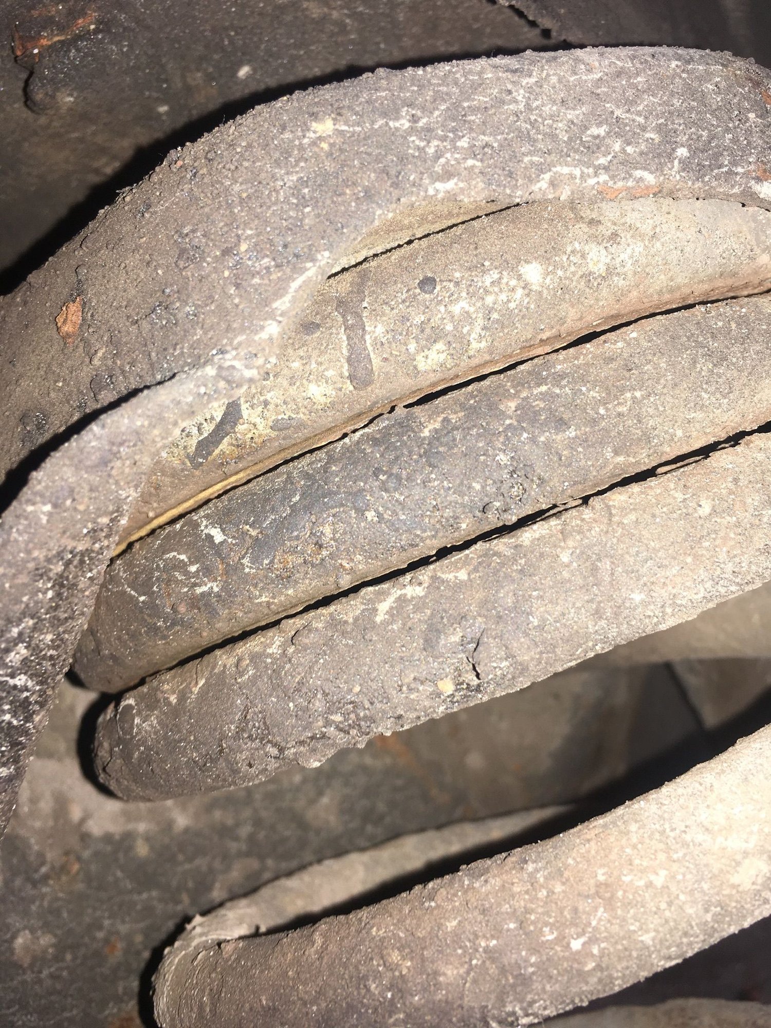

I switched rear coils to the correct handed side and still have almost an inch of variance. From the pic below you can see the Driver Side top coil is compressed more than the Passenger side. Who knows!!!?!?

If each spring is the same length in your photo, then that should not be happening.
Coils should not touch each other unless they are highly loaded.
Did the springs look and measure the same before you put them on?

I had them on the wrong sides. They were marked very faintly on the spring. All good now.

Took a picture of my rear spring with the truck unloaded in the driveway. I am surprised how close the coils are. I have TF medium with stock plastic rear bumper. About 30,000 km on them.
