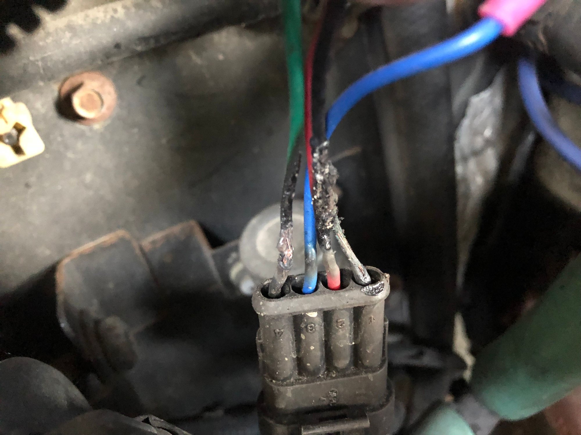

I was driving along today and stopped at a red-light. Light turned green, I mashed the gas and truck started off, then lost power like the engine was going to stop, for less than a second but kicked back in, so fast the car behind me probably didn't even notice and I was able to pull away. I was thinking random misfire or something and everything was running normally.
Went into the store and came back out to find check engine light on. I assumed I was going to have a random misfire, no big deal, but found 13 confirmed and 2 pending codes:

Any thoughts on what happened? I'm thinking electrical blip of some sort. Going to clean up the battery terminals and reset and hope for the best. And travel with a fire extinguisher in reach at all times

I had a similar experience when one of the power (or ground, I cannot remember) cables that goes to the battery got loose and burned through the shielding on the exhaust manifold. When the bar wire contacted the exhaust my dash lit up like a Christmas tree, I then hit a bump and the whole truck went dead. In pitch dark I found the problem with my cell phone as a flashlight and used some zip ties to keep the cable clear so I could get home.

Charlie_V ... you nailed it... an o2 sensor rewire got loose and melted on exhaust manifold.

Crazy, I had almost the exact same wire fire. Mine was a little worse as all the wires were in a single bundle and burned quite badly. Luckily the ones that burned through were long enough to cut and reconnect.

Drivers side?
Glad to help, though I think I merely provided inspiration. I'm rarely right, haha... but a broken clock is right twice a day. The sun shines on a dog's a$$ occasionally. A bind hog finds an acorn. I'm the clock, dog, and hog.
Glad you found it. Are you going to re-insulate the wires?
