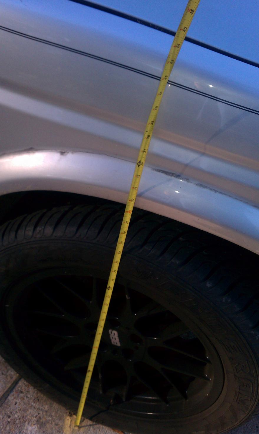

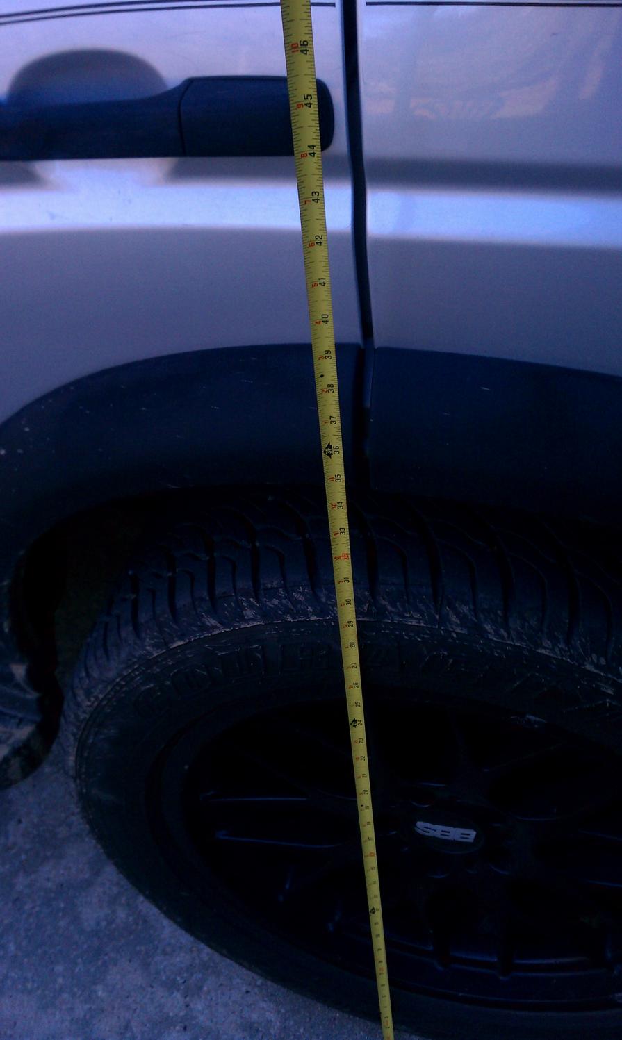

I currently have a 265/50/20 on. My rear sits 4" higher than my front so I hope the lift will event things out.
Old Nov 18, 2012 | 03:44 PM
aarongregor's Avatar
Posts: 688
From: Mississippi
Default front and rear
Front is 38" from ground to bend in metal and 42" at rear from same points. What are others getting?

Old Nov 18, 2012 | 04:15 PM
jafir's Avatar
Joined: Nov 2009
Posts: 5,847
Likes: 106
From: Arkansas
If you measure from the center of the wheel to the wheel arch, you'll get a better idea of lift, without having to worry about tire size. That's how the spec is listed in RAVE.

Old Nov 18, 2012 | 06:07 PM
jafir's Avatar
Joined: Nov 2009
Posts: 5,847
Likes: 106
From: Arkansas
So from the center of the wheel, to the lower edge of the wheel well, I measure 22" in back and 21.5" in front.
So accord to rave it should be:
19.7" front
19.0 " rear
So I'm getting about 3 inches lift for the rear and 2 inches lift for the front. That's with an ARB and winch. I have stock rear bumper so far... haven't installed my new bumper yet and I don't have my spare currently.

Old Nov 18, 2012 | 06:38 PM
Posts: 688
From: Mississippi
Thanks J from the center of wheel I am at 19" front and 21" rear. Thats with Bull bar and blue top. I am cant wait to measure after I add the 3" lift. Your pretty close to me.
