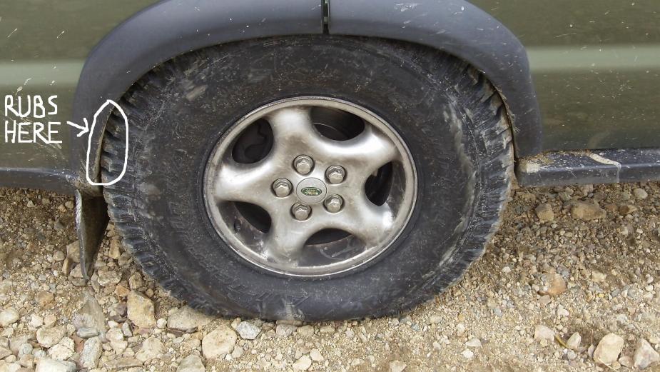

Thanks for those measurements. Where did the tires rub? Was it only on the sliders and front bumper?
I had already cut my front bumper, but I assume it would have rubbed there. The slider rubbed before I cut it (when turning). Other than that the only place is the bottom of the rear arch. See pic. No evidence of rubbing on the front side of the rear arch.

Thanks for the measurements. Going by those, I should be able to fit the 285/75's, between the clearance to my sliders, and my bottorf bumper, I should have enough room to fit them.

I went with JACKSTRAW wheeling when these pictures were taken and I have a 2 inch RTE lift with the same exact tires that he has as well from treadWright 285/75/16 and our trucks pretty much sat identicle in height. We also had the same place of rubbing when we were testing the flex. In my opinion you do not need HD shafts and 4:11's to run these tires. I did not lose that much power at all, If I ended up going with the 265/70/16 I would have definitly been disappointed. The TreadWright tires worked great and took everything we threw at them with no problems. We were both pretty surprise that our trucks were identicle in height with the same shock set up as well. JACKSTRAW would you agree?
