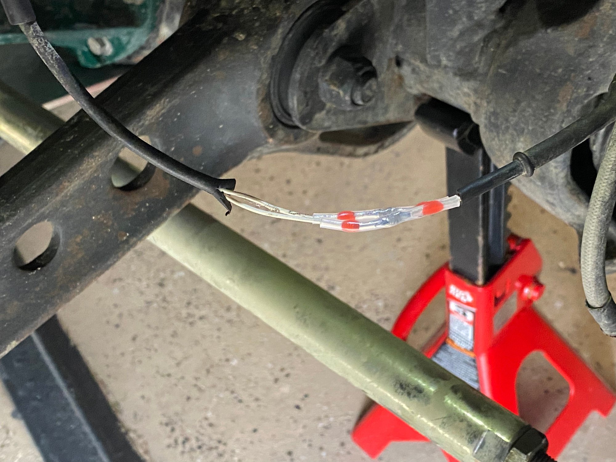

@The Deputy Repaired the cable with low heat soldering connections. I thought a did a good job but apparently not good enough. Brake, hill descent and TC warning lights went off but ABS is still on. Is there a reset procedure or do I just need to swap it out?
Low heat solder connections
Wrapped with shrink wrap

Looks like I got lucky. Light went out after driving it less than a block!

The ABS light goes out only after the truck first gets up to a specified speed that allows the SLABS to "see" that it's getting signals from all four wheel-speed sensors.
You weren't lucky; you were good.
