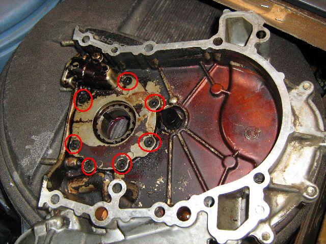

Does anyone have a correct torque spec on the oil pump cover? Phillips bolts on the inside of the timing chain cover. See picture bellow.
Or do I just go a good old "hand tight"?
Thanks!

In the overhaul manual section, found this for 4.0 and 4.6 engines; under torque wrench settings:
Oil pump cover plate screws ** . . . . . . . . . . . . . . . . . 4 Nm 3 lbf.ft
Oil pump cover plate bolt ** . . . . . . . . . . . . . . . . . . . . 8 Nm 6 lbf.ft
Spark plugs . . . . . . . . . . . . . . . . . . . . . . . . . . . . . . . . 20 Nm 15 lbf.ft
** Coat threads with sealant, Part number STC
50552 prior to assembly.
Note: they list every other torque it down setting for places you didn't even know they had bolts...

Thanks Buzz,
I needs to get to know the RAVE a little better I guess.
It looks like "Part number STC 50552" is Loctite (blue).
Thanks again!
