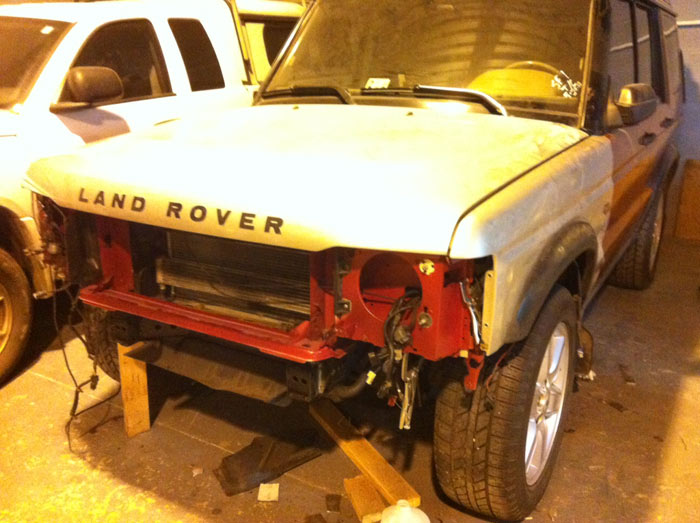

Driver fender is welded into place and aligns well, still tweaking passenger inner fender (didn't need to be replaced) but it's not lining up with core support as well as the one I took off the parts car - I didn't think it was damaged but it is indeed bent a little now that I've got the pieces coming together.

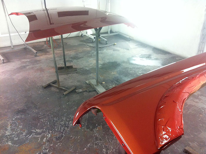

Outer fender and hood were masked prepped and painted today! Kinversand is a PITA to paint - besides the paint being $76 (my cost) for a half-pint, it doesn't cover AT ALL so I had to spray red first, then the cheapo color over the red, THEN the high-dollar PPG that matches.

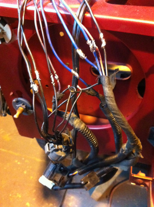

I had to repair the passenger side front harness as well since I very stupidly cut right through it with the cut-off wheel while hacking off the old core support after the crash. In my defense the harness was buried by bent sheet metal. Matching wires is easy but figuring out how the ~8 black grounds were routed was a pain. I believe I got the right combination (one large gauge into the ground splitter, which feeds most of the plugs - another large gauge goes directly into headlight bulb harness and 3rd large gauge goes back into harness (verified by multimeter as this wire wasn't grounded yet so must have come FROM the ground splitter and not to).

Starting point (after tearing away most of the damaged components)
All damaged sheet metal removed and spot-welds taken out for new piece fitment. Mechanically sound minus AC components, aux and clutch fans, new power steering cooler line, and brake components.

Took this back apart after temp fix to actually solder them for permanent install.
Shot the panels today, really pleased with the results considering how difficult the color is to work with.
