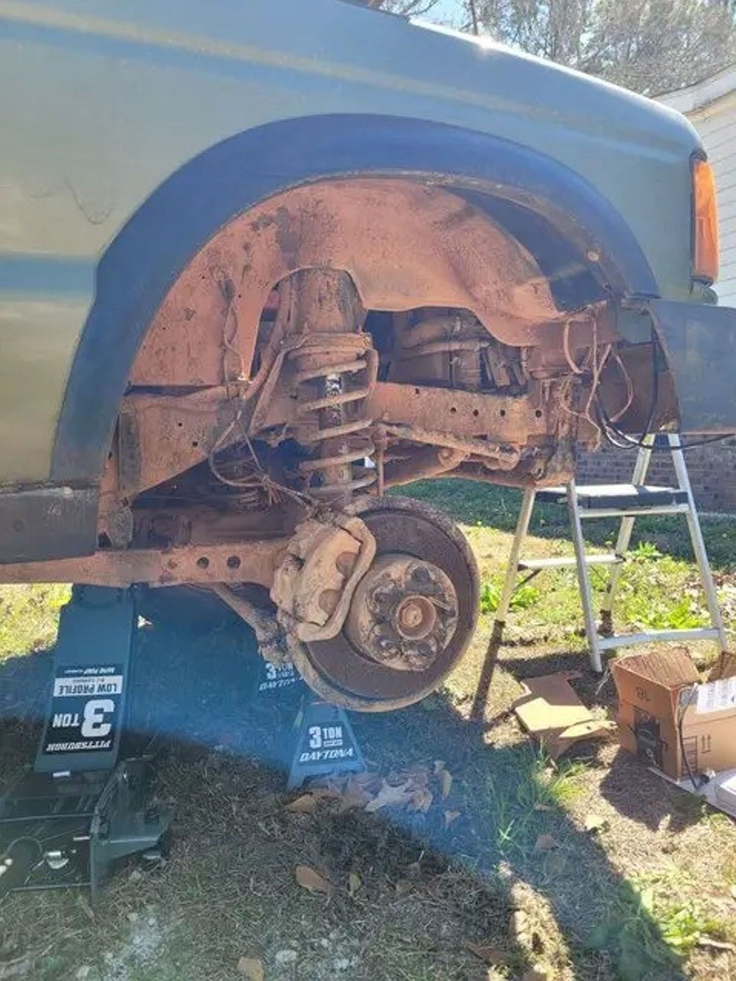

1: Remove the front passenger side tire.
2: Remove plastic wheel cover.

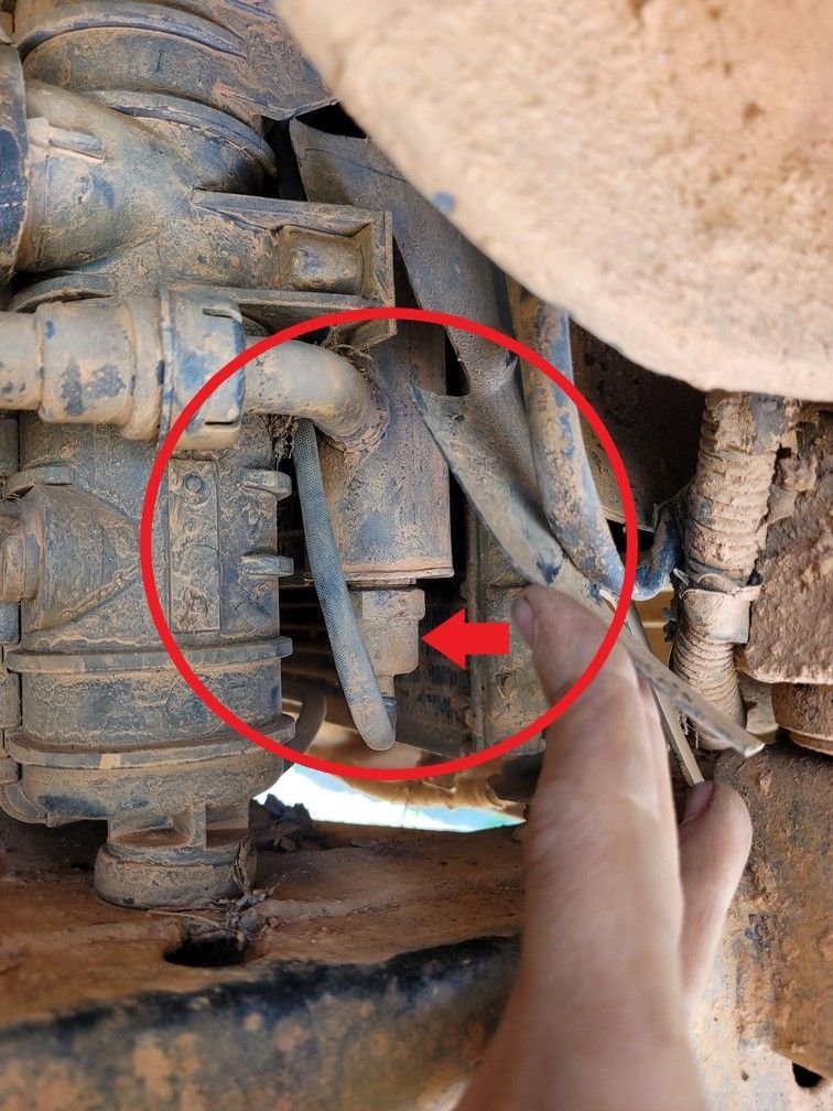

3: Pull back the flap pictured. That is where the temp sensor goes into the radiator.
This is what the sensor looks like and where it goes into the radiator.

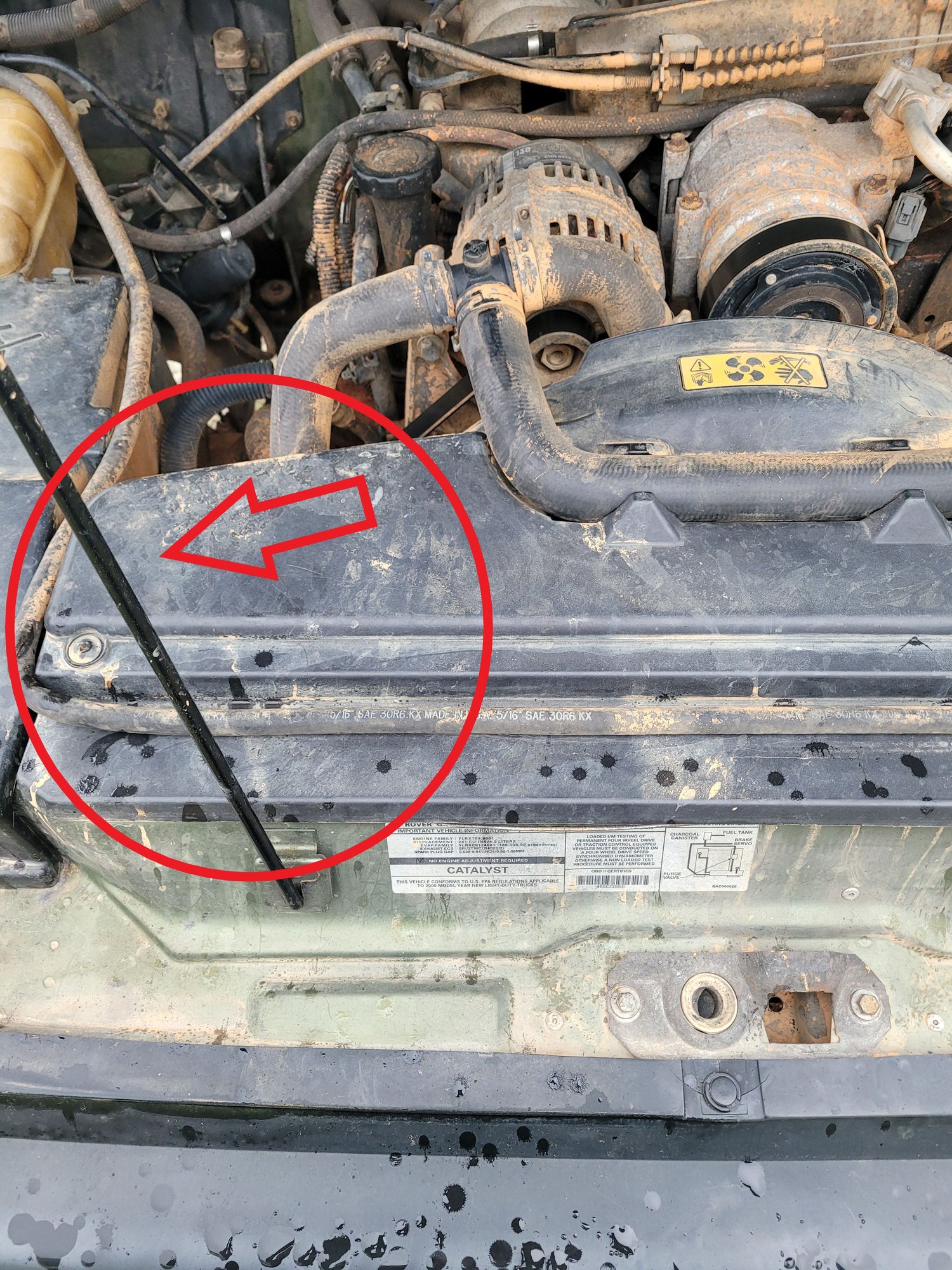

4: Back up top remove the radiator cover and look to the very left of the radiator. It is just next to the battery on the very left of the radiator at the top. This is where you disconnect the old sensor and connect the new one.
5: Disconnect the sensor from the clasp.

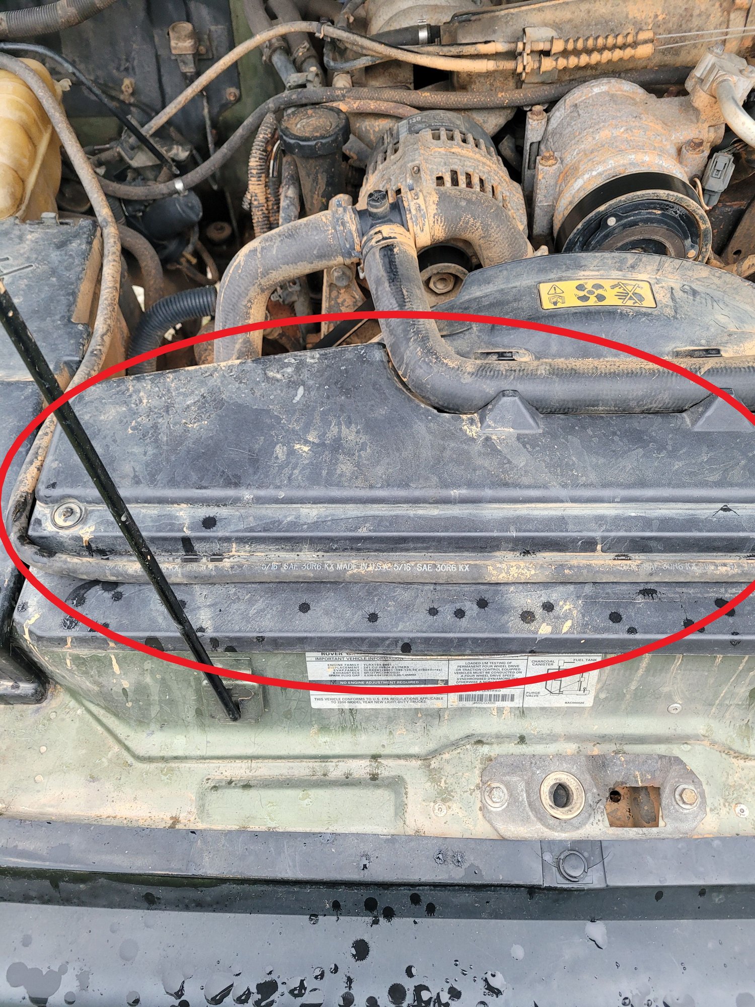

9. Place the sensor mount back into position and tighten the screw back to hold the sensor in place up top.
10. Replace the radiator cover.
