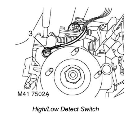

I need to order this sensor but can't find a part number or this part on any website. It is described like this by Land Rover:Neutral sensor
A neutral sensor is fitted for North America and Japan. The sensor is connected to the BCU and is normally in the open position. The sensor provides an earth path for the BCU which then interprets the signal and activates an audible warning generated by the IDM if neutral is selected on the transfer box when the ignition is on.
Also just order the high/low sensor, part number was IGM100000. Picture looked identical but a comment on the forum said the 2004 sensor was different??
A high/low detect switch is fitted in the front output housing and connects to earth when low is selected.The switch is connected to the engine ECM, the SLABS ECU and the BCU. The purpose of the switch is to enable selection of the hill descent feature and to modify the engine fuelling and automatic gearbox gearshift maps stored within the respective ECM’s and ECU’s.
Thanks for help

IGM100000 try google search
Old Mar 26, 2021 | 06:53 AM
redwhitekat's Avatar
Joined: May 2011
Posts: 2,768
Likes: 396
From: kitchener, canada
Transfer box switch low range part number IGM100000 for all models of the Land Rover Defender year 1987 onwards and Discovery 2.

Yes I found high/low switch but still need the neutral position sensor. Can’t seem to find it anywhere or even determine part number.

I found number on Russian website after extensive searching, Part number for neutral sensor on transfer case is AMR6666.
