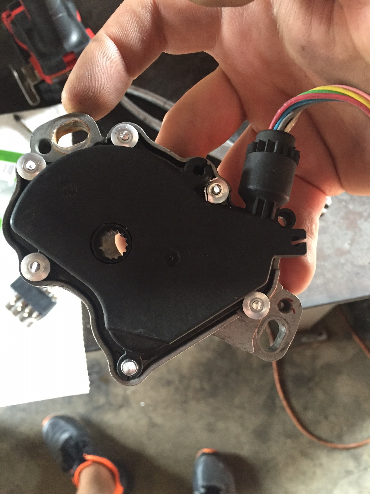

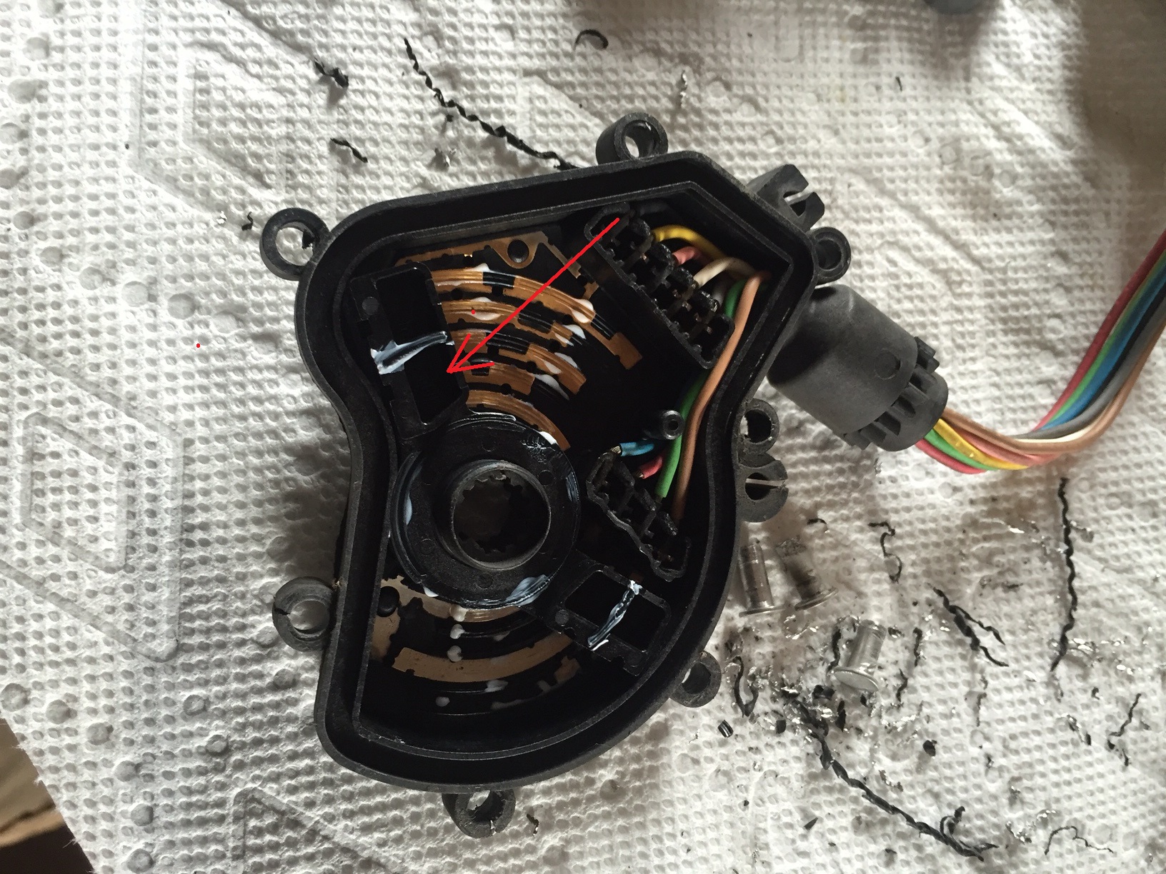

fixed xyz switch ,the contacts wasn't touching the contact lines,so just bent them out , put it back,now all working perfect.used rivets.
Attached Thumbnails Transmission blinking M and S same time-img_1769.jpg   Transmission blinking M and S same time-img_1775.jpg

Well done.
