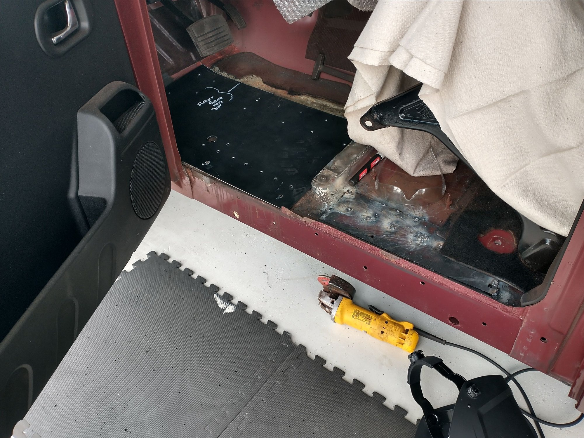

Here is where I'm at re: fixing the floor rot in my disco:

new panel welded in....now onto the door lip for the gasket...plan is grind the old piece off and weld a new one on ....should be solid now.

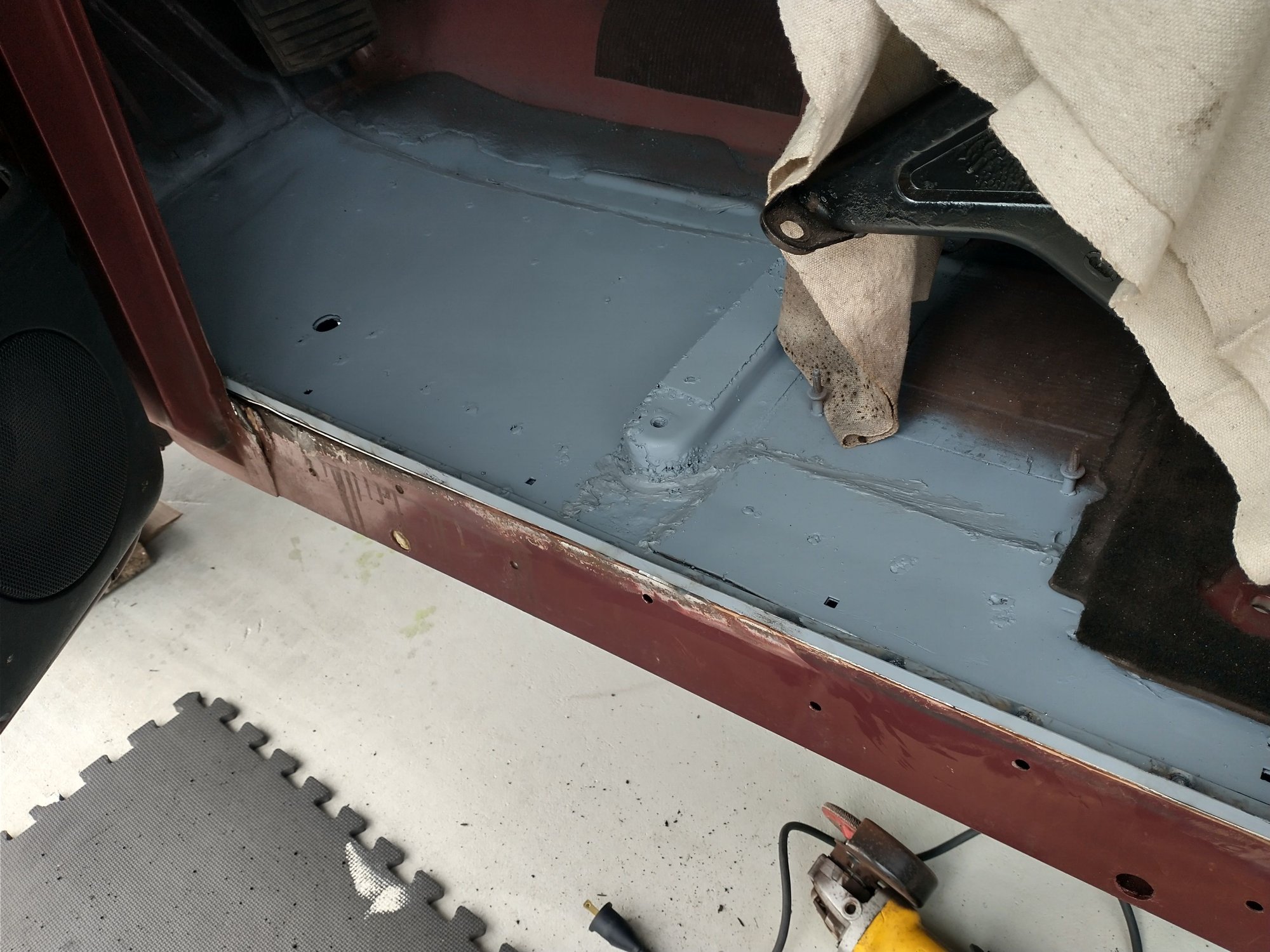

finished up the trim piece for the door gasket to rest on. seam sealed everything...one little corner transition from the horizontal run to the vertical for the door gasket trim.
here she is:

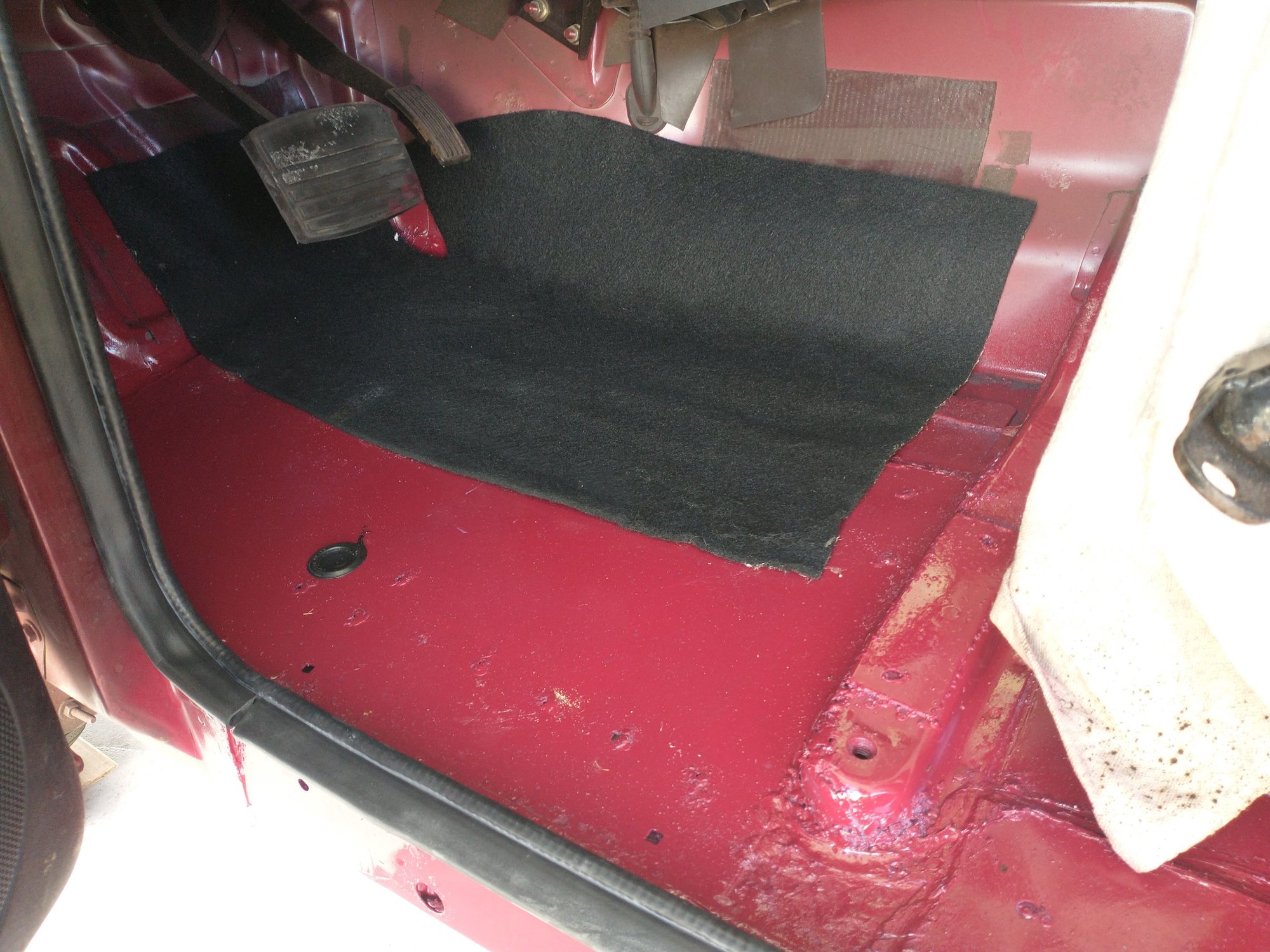

and I do have the rubber cover for that access hole for removing the chassis bolt. another score at the U-pick....

got her all done. just have to let the final coat of paint dry good before installing the carpet (which I had to remove a ton of rust stains from it). then the seat gets rebolted.
here it it today:
