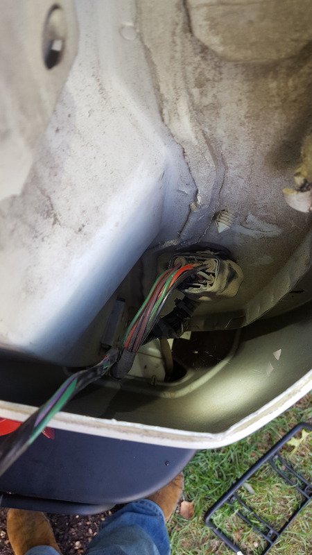

I've never had a vehicle that could tow anything so I'm honestly not sure if it's rigged or not. I did take the taillight off but couldn't make sense of what I saw. Maybe this will help.
The wires going toward the bottom of the photo are the ones connected to the taillight. I'm not sure what that is that's attached to the frame and I have no idea how to remove it.

No splices there, that big plug is the factory female plug for connecting a factory trailer wiring kit. Kit runs from that plug to trailer hitch area. That plug is up high to keep out of water if fording a stream. On the cheap, you can splice a cheap converter into that bundle of wires. No damage to blinker wire apparent there. Other than checking the bulb in the taillight, you are finished there.
I would check dash bulb, maybe, and connector there. There are two screws between dash and steering column. Notorious for coming loose. I am not immediately aware if blinkers are on separate circuits/fuses/relays. One more thing, problem could be the turn lever on steering column. Either loose connector or bad lever.
