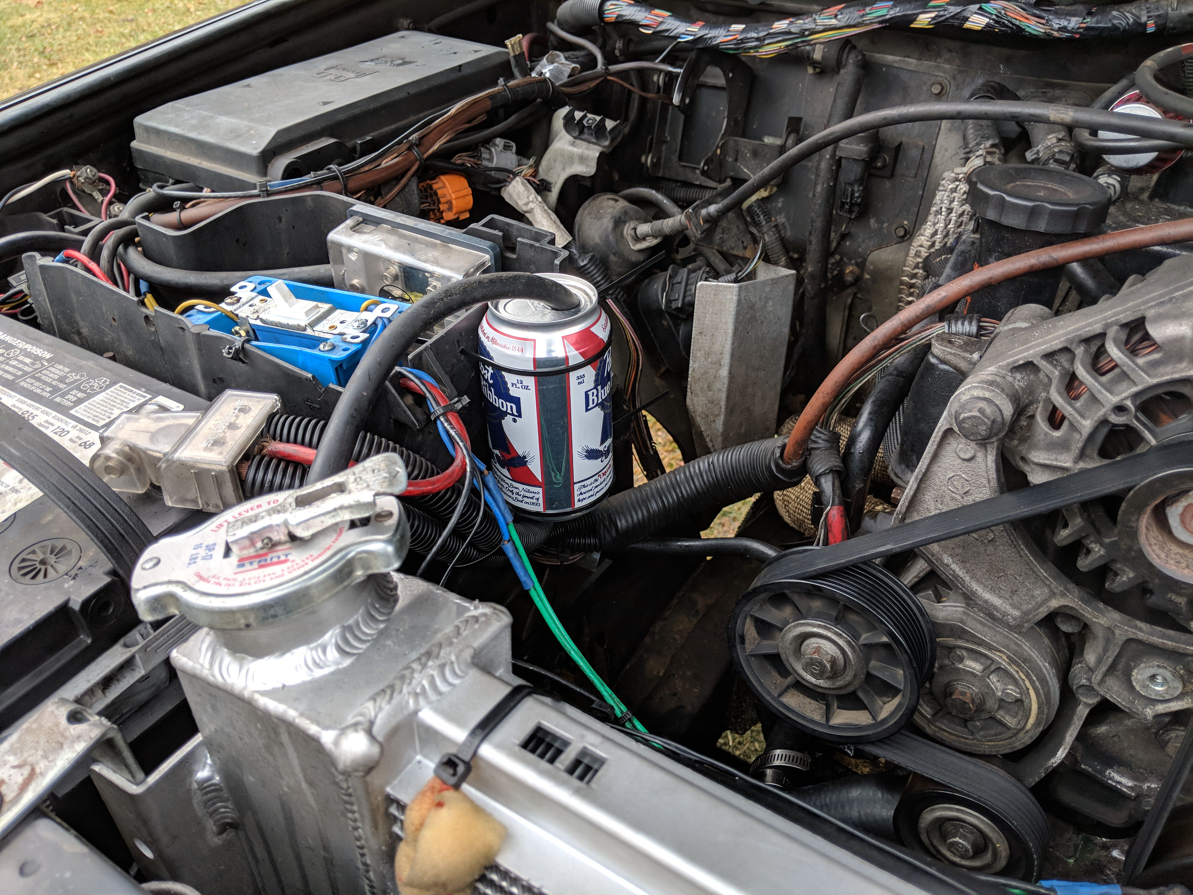

At any rate, I've got one "catch can" completed and now working on extras.

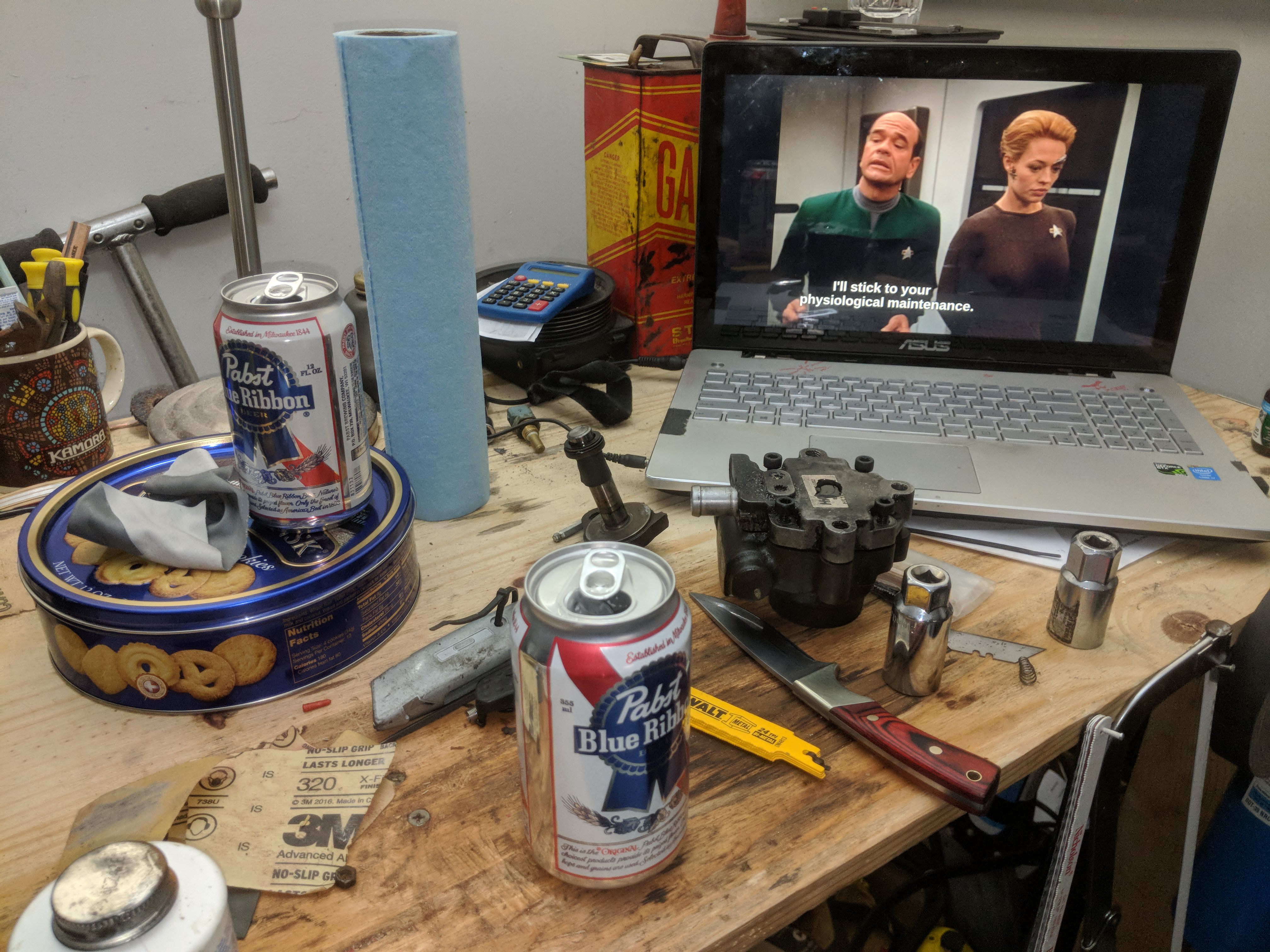

Can also see my power steering pump there. Rebuild write up (with video) coming soon.

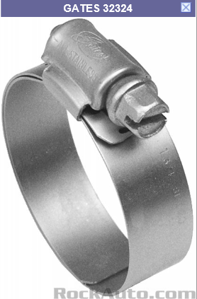

Those are the Belleville Springs and it helps keep constant tension on the clamp.
These are real slick clamps.
> https://www.mcmaster.com/#hose-clamps/=1b1ni0y
Have a look at the NORMA/ABA site, they make great clamps. The ABA Safe is more of a traditional worm clamp, but it has the protective extra "tail" that keep the hose from getting pinched.
> Hose Clamps | NORMA Americas Distribution Services
http://www.normagroup.com.au/CA2579B...ant_Torque.pdf

Alex, if you want to try another quality hose clamp with the inner liner, then go for a GATES 32320 or 32324. Rockauto has them for about $1.42, but you can get them locally.
If I need them quick I call a local hydraulic hose repair shop and they carry tons of sizes.
> More Information for GATES 32320
> More Information for GATES 32324

That's great info. I really like the ability to get them locally. I don't keep a ton of spares of stuff like this, so when I need them I usually just run to town. Might pick a couple of these up, too, and compare the three styles.
In other news, got my "catch can" installed and she seems to be doing her job.
I also have been watching my temp with the 187 thermostat. I switched back to the big hole. It might not be optimal for 16 degree weather, but it seems to be doing very well from 20 degrees up to 53 degrees today! Glad it's warmed up some. I hate the cold.
It seems to be cruising right around 188-190 degrees, going up a grade (holding 4th, not downshifting) around 190-194, and about 194-195 on acceleration whether it be light, medium, or hard accel. Idle seems to be 188-194 also. I'm very pleased. We'll see if these temps hold as it warms up more or if I end up going back to the 180 degree thermostat.

OMG, somehow I missed seeing that great light switch in the plastic box, whatzit for, and it needs a cover plate.

Haha, I knew that was gonna get some questions. Don't judge me too hard on it. That was a temporary fix for my radiator fan that never got replaced. I've got another switch in the cab now that I just need to run a relay for.
