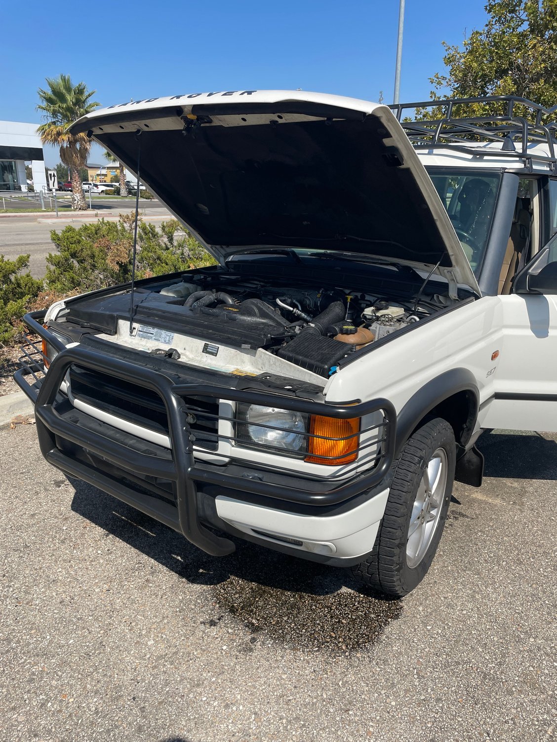

Was driving along having a chat with the wife and beep beep beep! 220 water temp. I pulled over (conveniently into a tractor supply parking lot) and shut the engine off at 230. Somehow the upper radiator hose blew off and coolant was everywhere.
I replaced the stock clamp with a spare screw clamp, refilled and with coolant and was on the way within 10 minutes.
Meanwhile the dash gauge didn’t budge from middle. Crazy.
Anyway. Get an ultra gauge.
