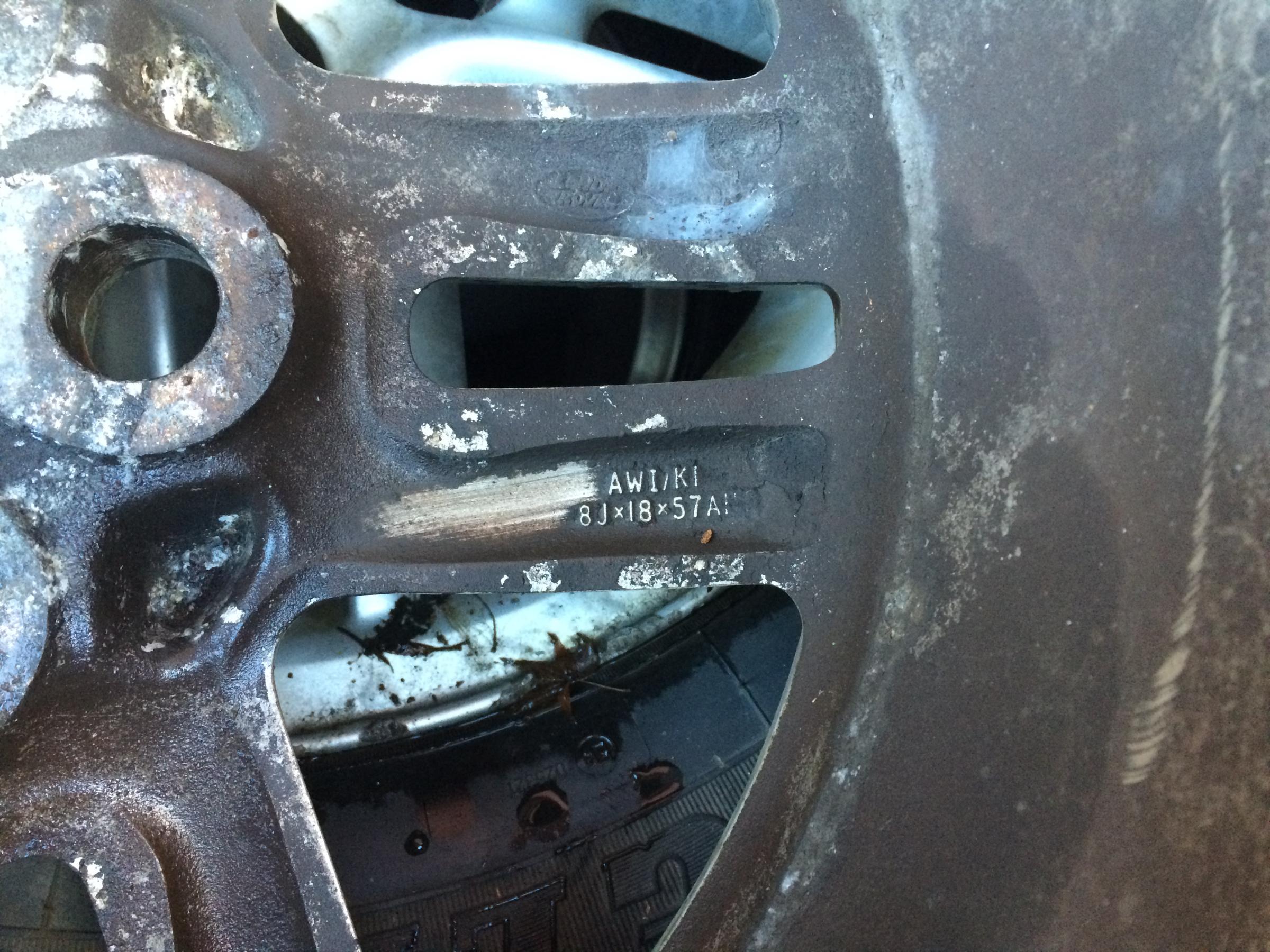

I was actually looking at my spare set of Hurricane 18" wheels to replace the Jeep wheels on my off-road trailer. Trying to calculate the wheel adapter needed to change from the 5 x 4.5" to the 5 x 120 bolt circle.
The Hurricanes are 18 x 8J x 57ET
8J = 8" width
57ET = 57mm offset
8J = 8" width
57ET = 57mm offset
5x4.5" to 5x4.75"
