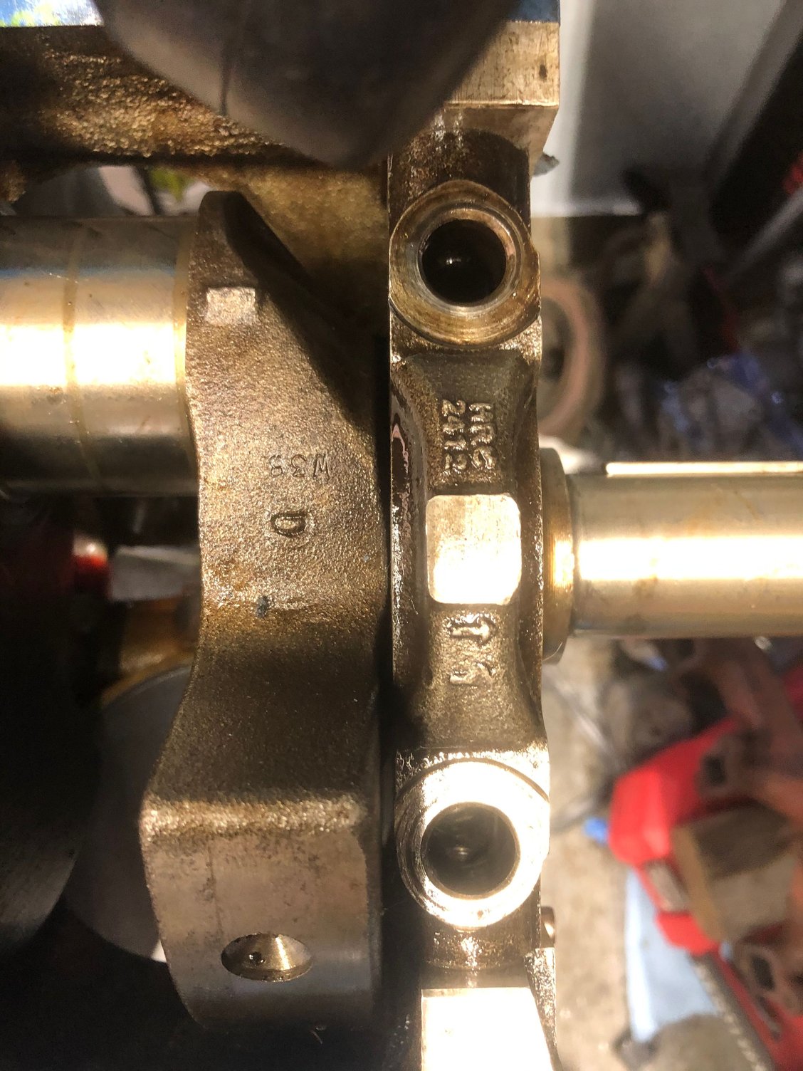

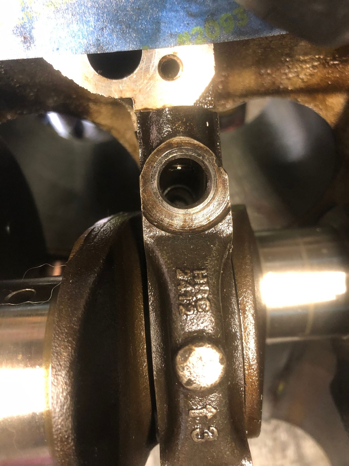

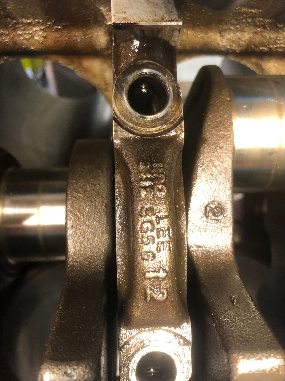

Main caps are marked 2, 3, 4, etc. Post a pic of the assembly and we will see if we can help.
Old Apr 12, 2021 | 03:10 PM
  #25
merebel's Avatar
Joined: Jun 2016
Posts: 482
Likes: 62
From: Brunswick, Maine
Ok here are the pics all of the numbers are on drivers side if looking right side up and in front of it
1st cap
Second cap
3rd cap
4th cap

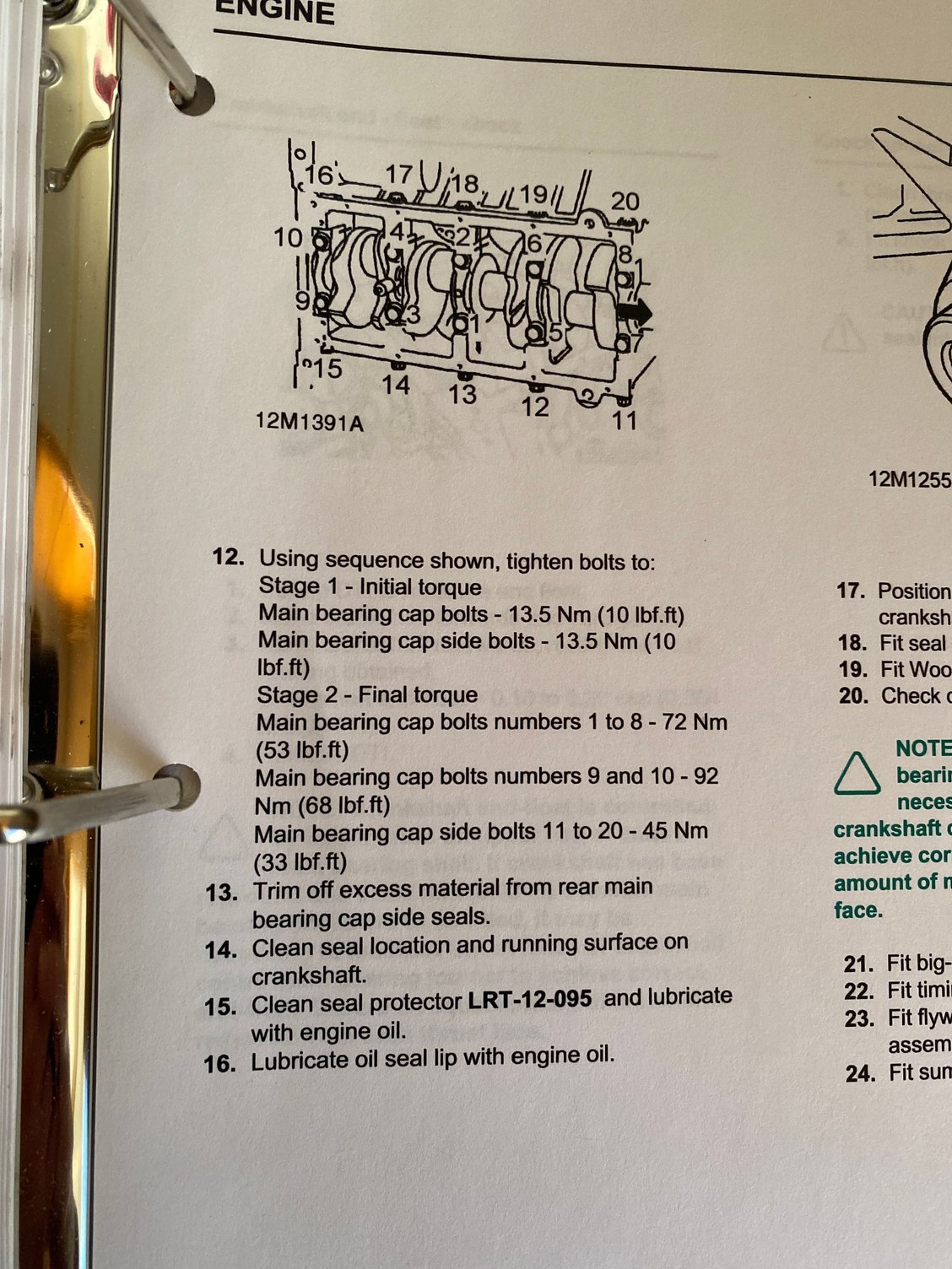

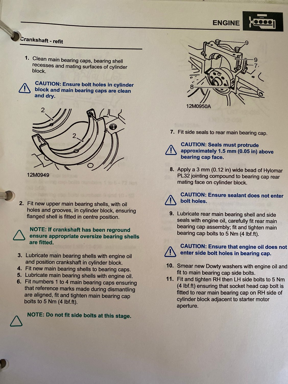

I’ve been following this thread because I’m about to start the reinstall of my crankshaft soon (block comes home from the machine shop tomorrow). Just out of curiosity, did you follow the crankshaft refit procedure in the rebuild manual? There’s a pretty specific torque sequence for the bolts and they aren’t all torqued to the same value. I’ll try and post a picture.
