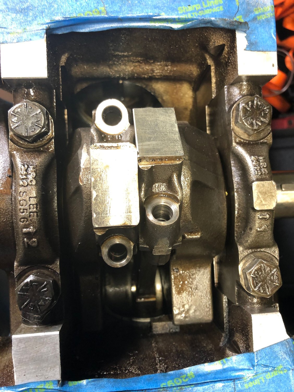

Ok now what the heck, I am trying to get the pistons in and aligned with the crank. I can the first one in no problem but the second one the connection rod and cap I can not get to slip in next to the first one with out it binding.
at first I got my left and right messed up as lock is upside down. but with the second one it’s not going in pass at all. Is there some trick to get theses lined up ??

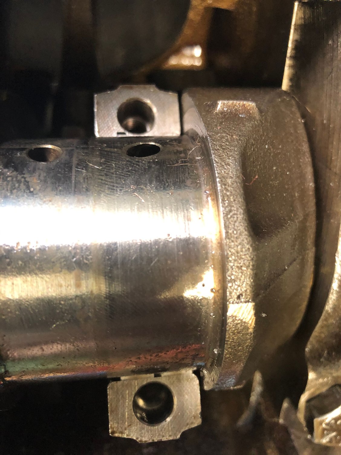

Ok so this is so tight they will not slip by each other with out some work. So I have cylinder one when looking at the front of the engine on the right of it (if sitting in drivers seat it would be drivers side) and the domed shape boos facing the front of engine. Cylinder two opsisote side the domed shape bossed facing rear of engine. When you look at the rod ends the is a chamfer one side so if I have pistons still in same order they should face to ???
I have a couple pics here too
This the cylinder 1 with cap setting on it and number 2 cap squished in there.

Ok so I am doing something wrong and I think I just getting messed up in terminology on this.
so the domed shape boss on the connection rod faces towards the front of engine on RH Bank. So my dumb *** question is which side is RH Bank ? Is it RH side from facing the engine from the front to the back ( If in front seat be the drivers side where the cps sensor goes?)

The engine is always referenced as you are looking at it from behind (page 1 form the rebuild manual, if you are looking for a source). Pistons 1,3,5, and 7 are on the left and 2,4,6, and 8 are on the right. The CPS is on the left and the starter is on the right.

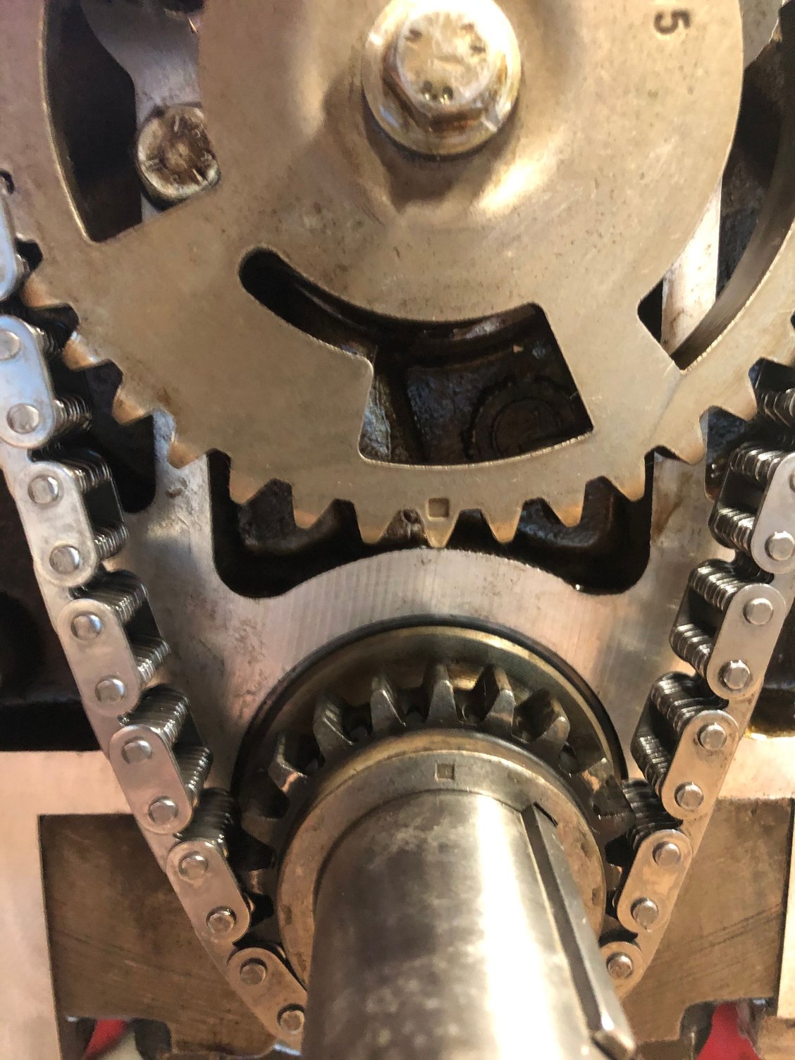

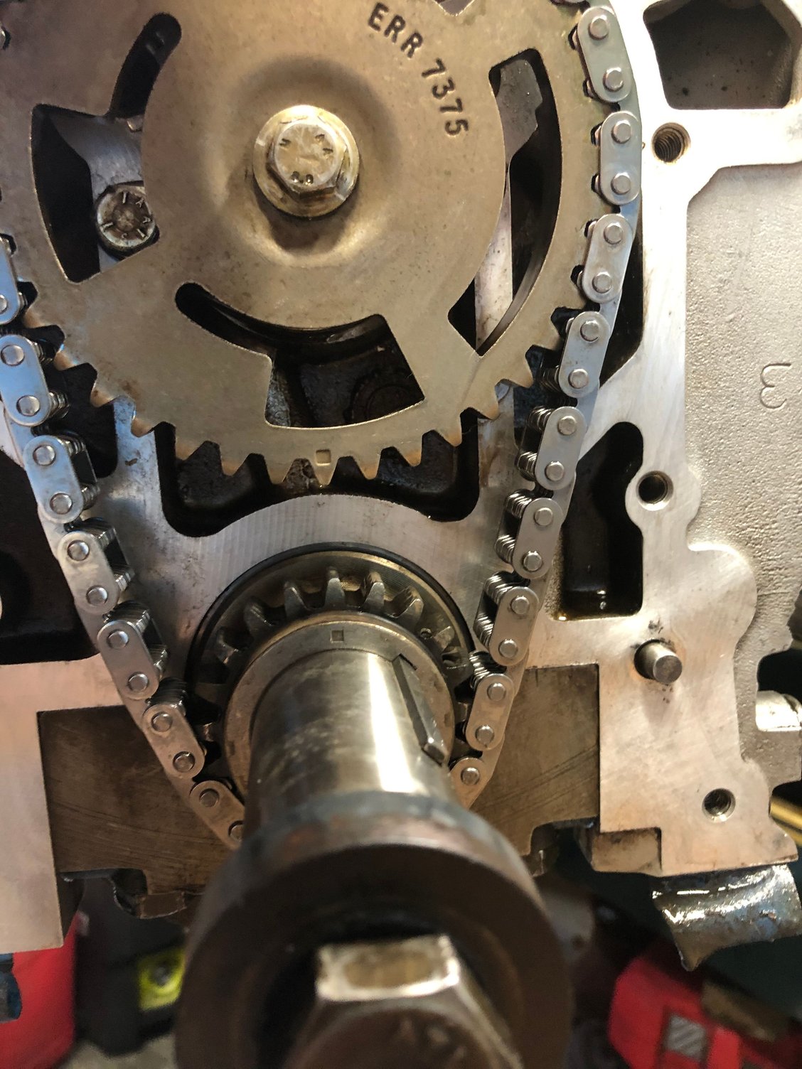

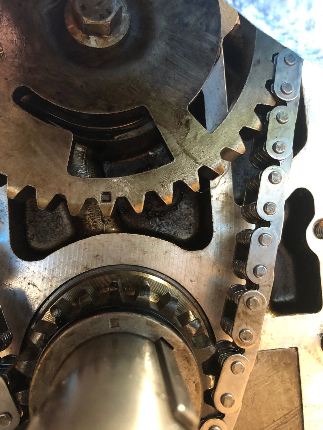

So timing chain and alignment so just 12 and 6 o’clock per manual. And this where I be.
