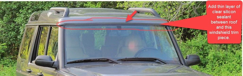

I had this problem after my windshield was replaced. The solution was to add a thin layer of silicon sealant between the roof and the upper windshield rubber molding. I used a plastic trim tool to pry it up, and then slid along while squeezing the tube of sealant into the gap. Worked great!

Thanks Tim that’s what I’ll try next. I went through the car wash no leaks. Going to hit it with a hose one more time before I put the trim back on
