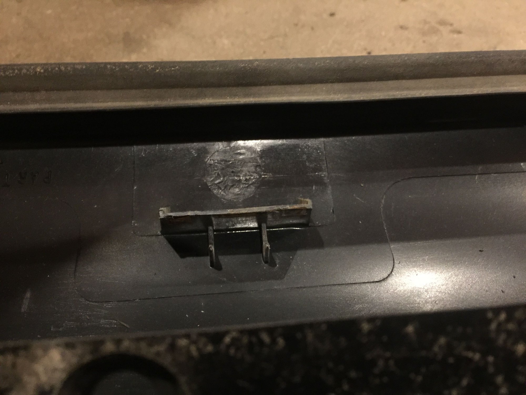

I jinxed myself!
My driver's side A-Pillar cover is cracked all to hell, the clips pulled away from the windscreen and 2 of the 3 plastic rivets that hold it in tore through the cover.
This sucks. Now I'll replace both of them.

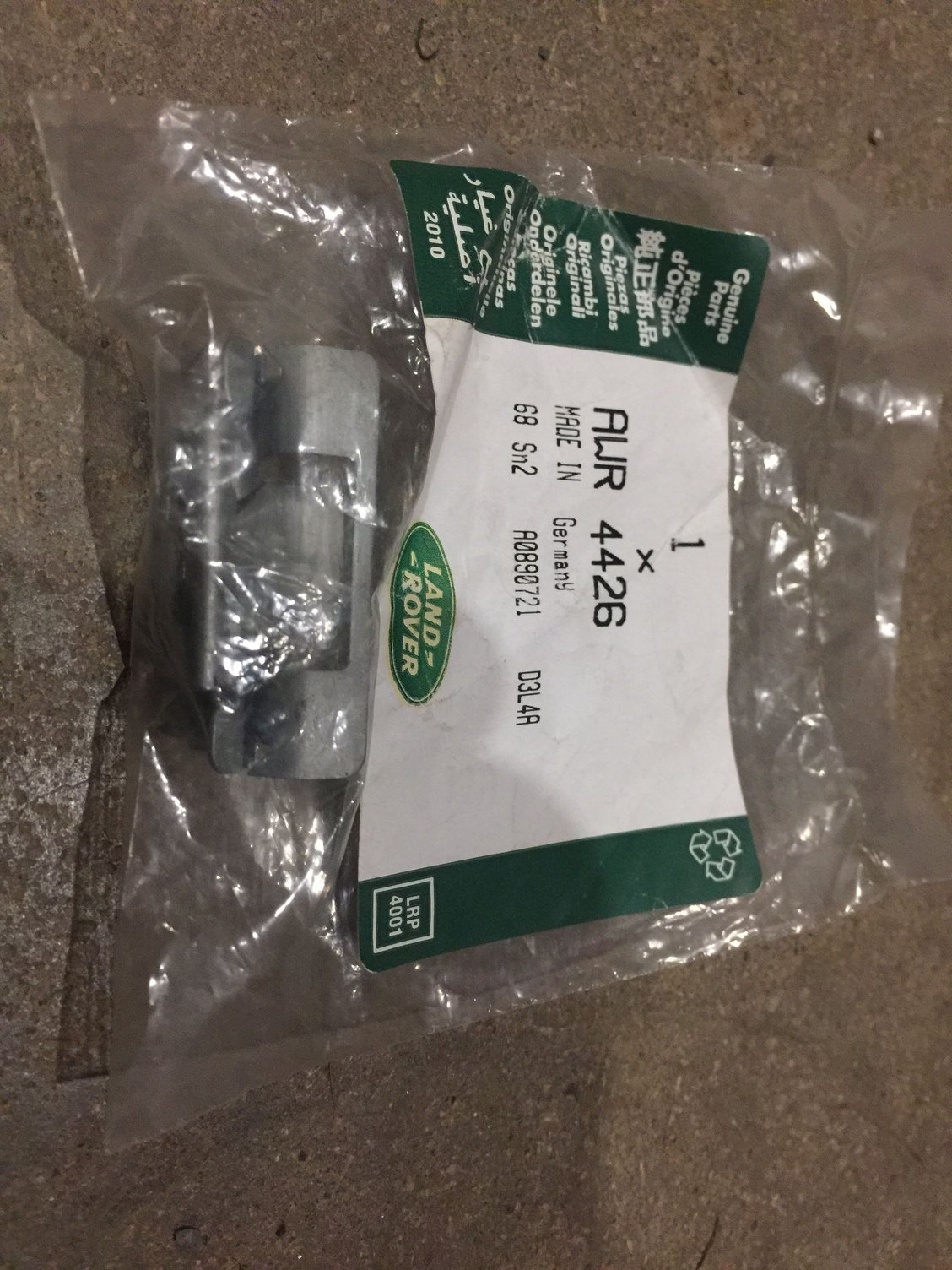

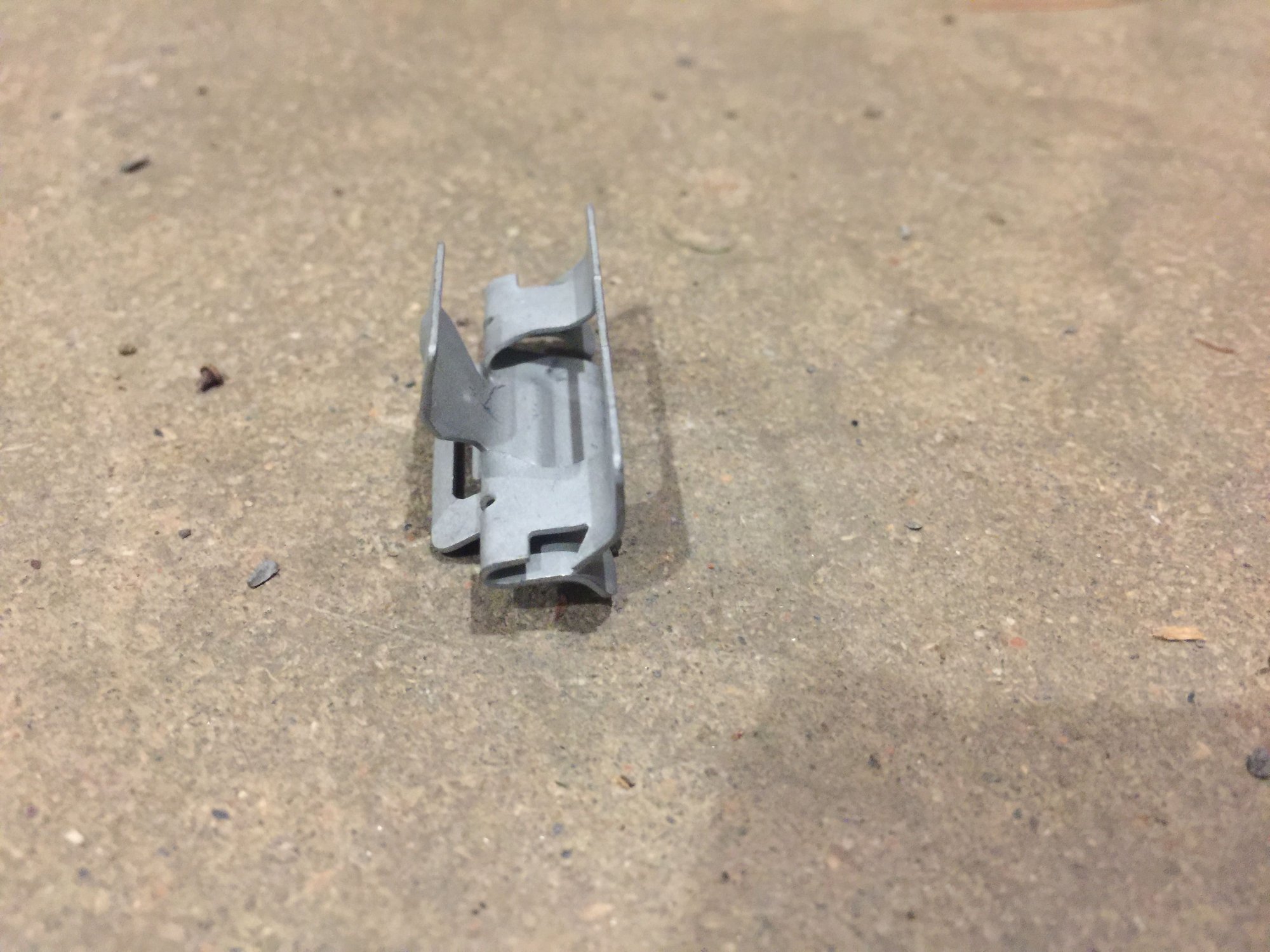

Hello,
I'm trying to start this repair.
I've taken the A pillar covers off my parts truck - they're in really good shape.
I've got new rivets and clips.
I took this in to a vehicle window shop and they wouldn't work on it - said it needed body fill, that I could use silicon but it would retain moisture and rust it worse.
I've looked at the TSB - says to remove quite a bit but it seems like I can see what I need to seal without removing anything...?
A few questions:
-What sealant do I use?
-How do I reattach the A pillar covers with the clips?
Really appreciate your advice, please see photos of everything below.
Thanks!

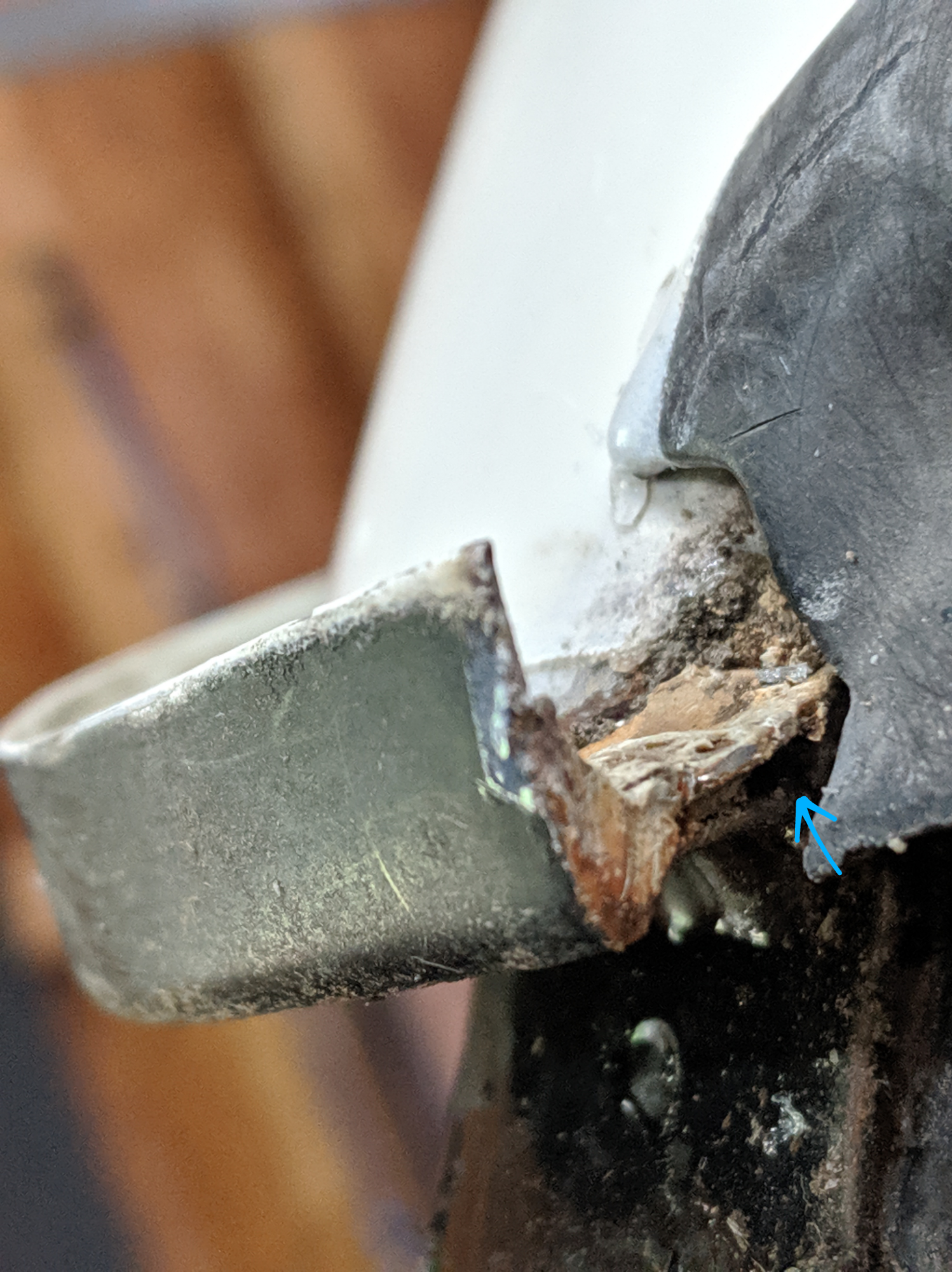

I think I finally found the true source of my leak. The water is rolling off the edge and through this opening at the end of the rain gutter near the windshield. I have some Sikaflex 295 uv on the way to reseal the entire rain gutter.
