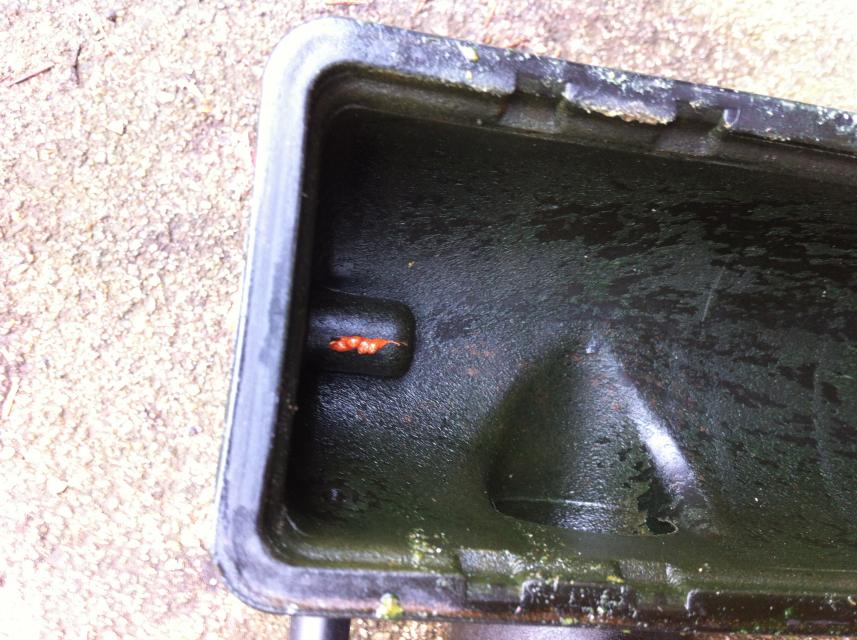

The plastic rad has a screw boss in the top of the tank. Too much force, wrong size screw, and small crack is formed that will leak.
