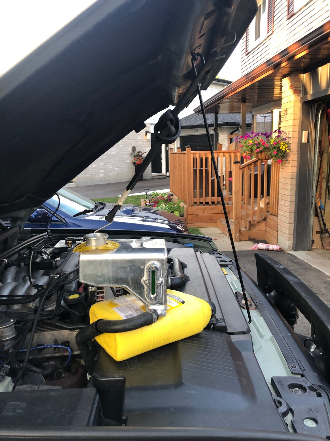

i cannot for the life of me get rid of sound of coolant flowing through the heater core, i can start hearing it right around 150 degrees when stuff starts to flow, ive tried every bleeding method, im not losing coolant, not overheating, etc
i had the car on 2 ramps yesterday lifted the tank all the way up, even opened bleed screw on the inline thermostat
i had the tank held up with a bungie cord for 30 min to see if air would come out cold
i had the tank held up high while i rev the engine to 2k for 2 min to see if air would get pushed out
ive driven around with the cap loose
ive driven around with the cap half loose
i remember on my 03 after a coolant repair and refill i would do the normal bleeding procedure and still get the water fall sound for maybe 30 min but would go away right after , this 04 is being a pain in the ***

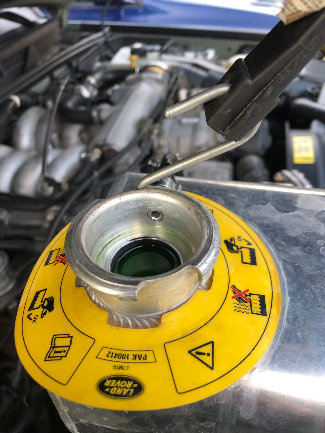

Well after 1 hour of topping this to the rim it goes down maybe 2 inch after 20 min. Kept topping it up until it stopped going down. It’s a bit better but still there. I think it needs another round of this. It’s a slow process
