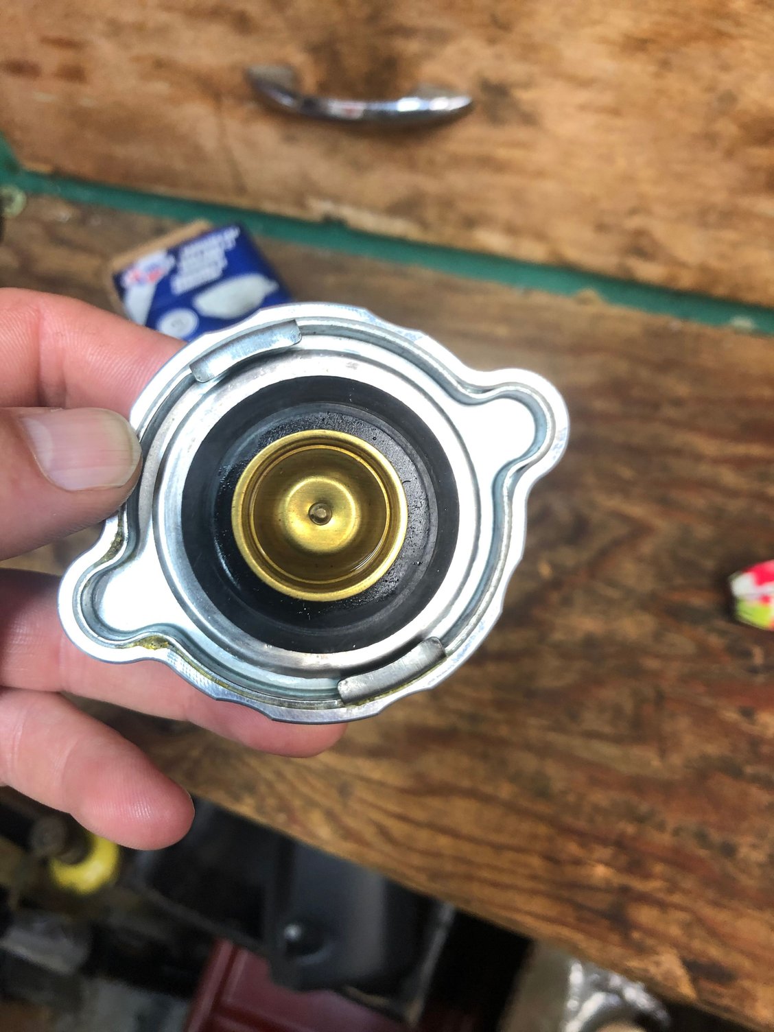

So trying to do process of elimination
bought a new rad cap Stant 10231 old style 16 psi for a 97 Chevy 5.7
the allisport cap is much heavy duty the spring is way bigger and heavy on the allisport not sure what the psi is
drove this morning waterfall sound still there right around 170 when thermostat starts opening and flow is moving
the one thing I notice about the allisport tank vs the oem tank is that the level on the allisport tank stays near the top
where the level on the oem tank would correct itself near middle and even lower with the inline thermostat
so now I’m thinking if the heater core is a bit plugged at one spot and the flow starts happening when tstat is opening the water pump can be pulling more coolant then it’s feeding on the one spot of the clog causing the sound.
