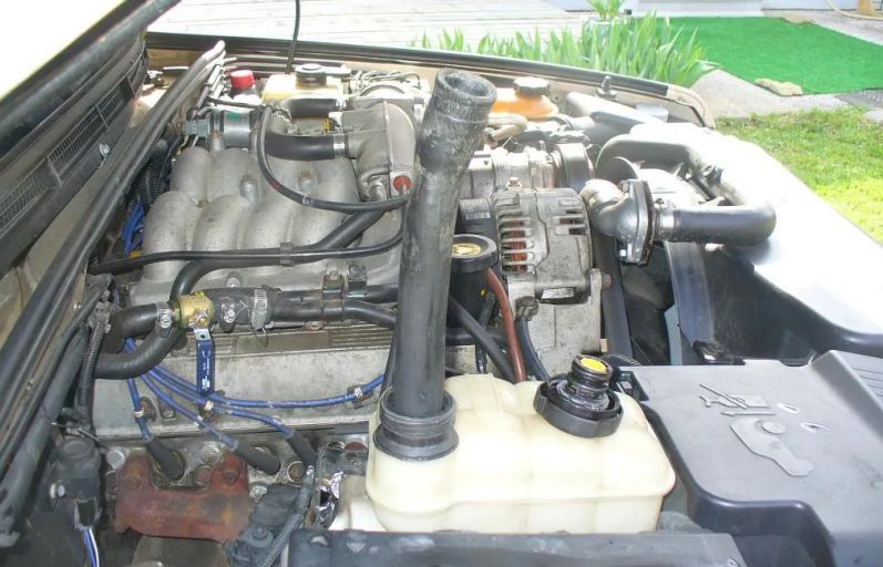

Old Jun 19, 2021 | 04:58 PM
Externet's Avatar
Joined: Jul 2012
Posts: 983
Likes: 156
From: Mideast US
Lightbulb
Shutting off flow to the heater core in warm seasons cures the noise at least half year. It is a 3/4" quarter turn ball valve from Lowe's inserted in the heater hose (golden and blue).
-Ignore the filler rising hose-
