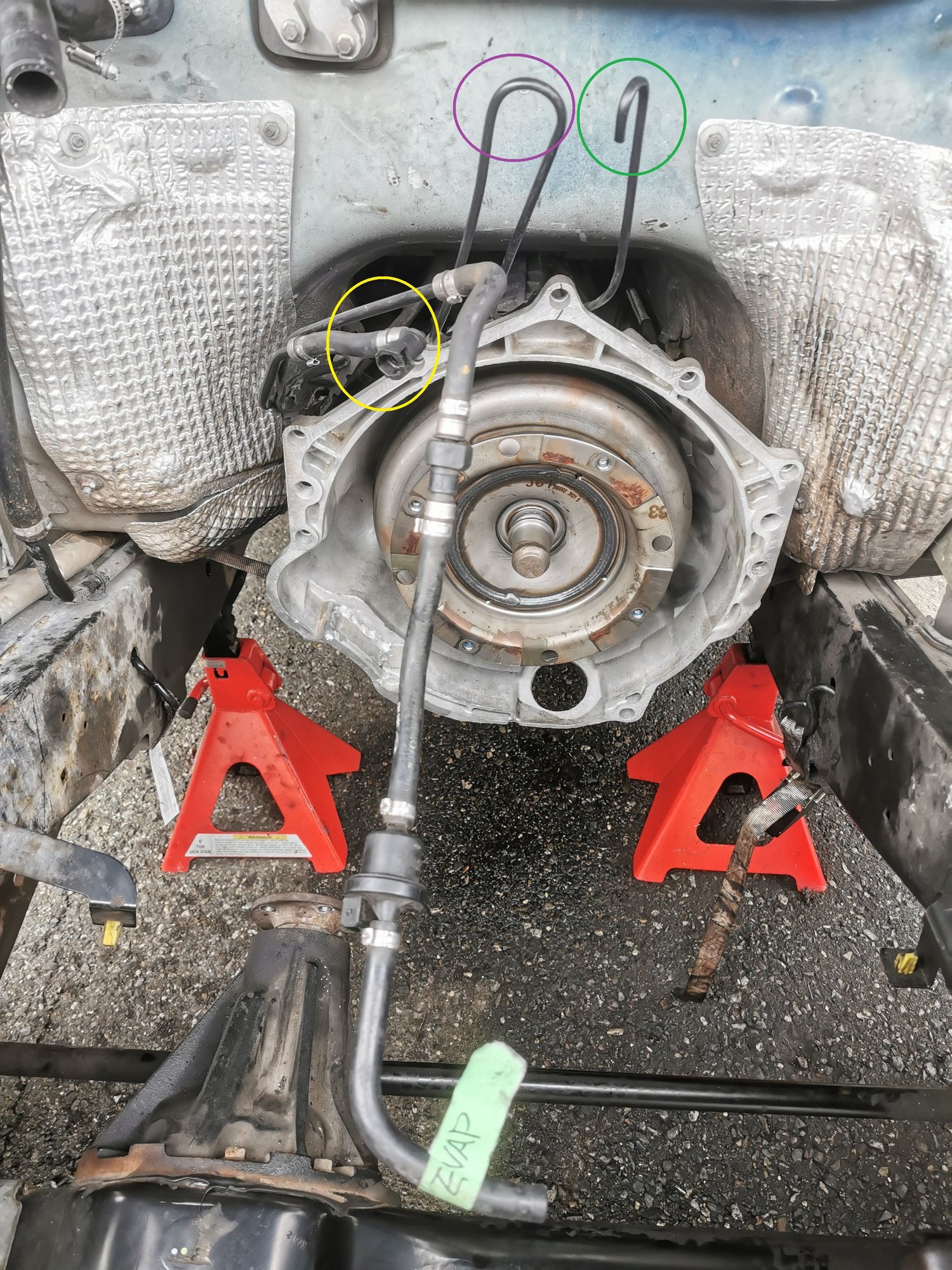

Hello Rover Fam,
I made the foolish mistake of not labelling these things when I pulled the engine. I'm about ready to swap my LS in now, I've got these couple of stragglers left and I'm not sure what they are exactly.
I'm thinking the Yellow circle is the Fuel Line, and I'm not sure about the Green Circle...unless I have these backwards.
I know the purple one is closed loop and doesn't really matter but I'd still like to know what it is.
As always, much appreciated. Thanks in advance.

Yellow is fuel, other ones are transfer case and transmission vents.

Where does this vent tube typically connect to?

@604x4BC it just attaches to the firewall and stays open

Just found this in another thread;
The breather lines on the Disco should be snapped into a plastic clip on the firewall, next to the brake booster.
Now I'm set. Build thread coming soon..

RH Side Head should have a little bracket which holds the lines into place from the factory. Most vehicles if they've had a HG Job or any upper engine work done = it gets left off.
