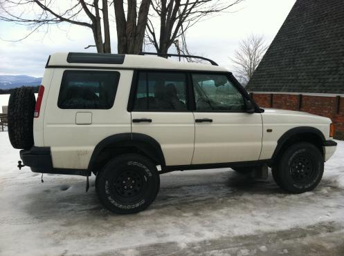

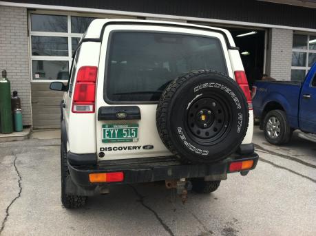

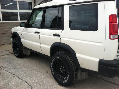

Finally got everything mounted and balanced.

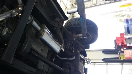

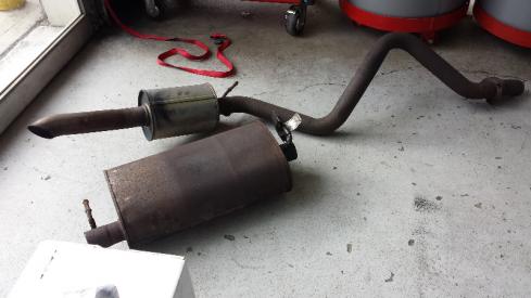

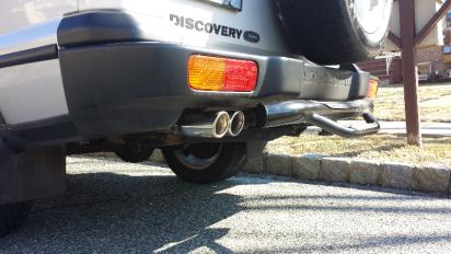

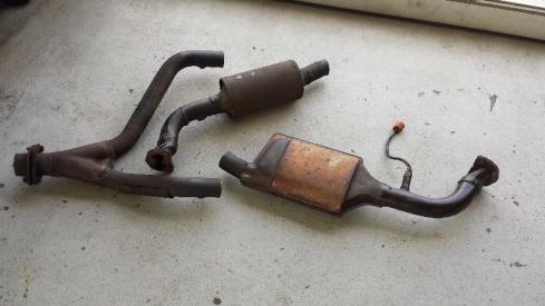

Did quite a bit actually. Fitted the quality used guage cluster cover.
Did this...
It sounds so nice.. it's a shame I can barely hear it over the fan.

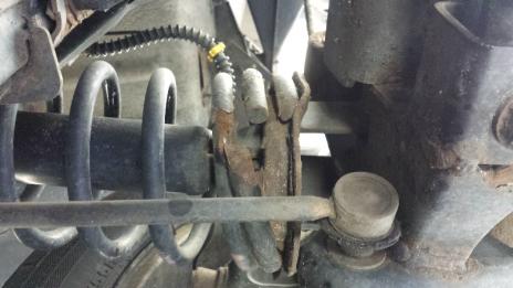

Found this broken spring.
It has been said by many.. fix one issue and another will rear it's ugly head. I replaced the entire exhaust with all.new magnaflow equipment only to find that the right front spring is broken, the front output shaft on the transfercase is actually bent ever so slightly, and the rear output seal is leaking like like a siv.

Are you able to open your rear door with the tire on? If not flip the tire carrier. You will need to drill two holes in the carrier but should not take long at all. Easiest way is to flip the carrier bolt up the top and bottom holes. Take a drill bit through the inside of the door panel where the existing hole is, then drill through the carrier.

I was worried my door wouldn't close either, but it does! I might still flip the carrier to get some extra room. Thanks for the how to!

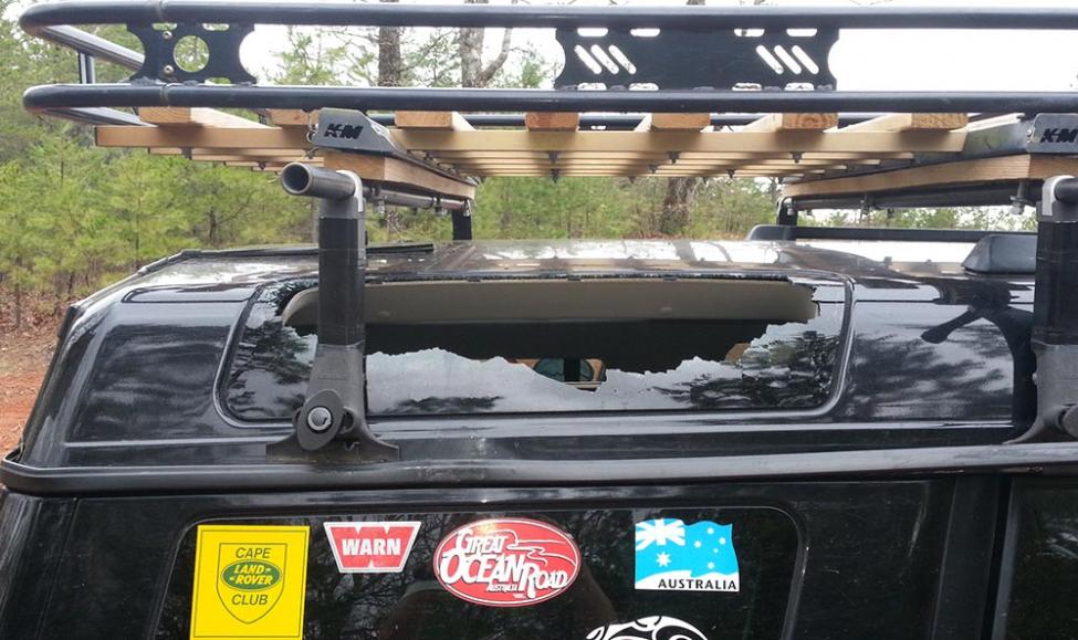

Ordered a replacement alpine window for the one that I broke at SCARR last weekend. Got it on ebay for $50 after shipping.
