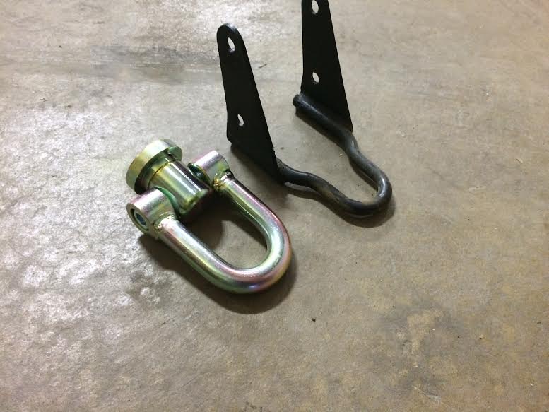

Originally Posted by potxoli
Well, I decided that I needed some kind of recovery point/hook with the new bumper, but I did not want to spend the $80
I full understand that,
So I figured that if I cut the top of the OEM towhook bracket off on the same side, it should fit and still be sturdy.
I would really like to see you upgrade the hardware used to holding the the bracket to number 8. The bolts that come with the bumper are made only of the finest quality butter. One more thing, if you insist on using this as a recovery point I really do not like the fact that you've got only one bolt holding that bracket to the frame. I have an old tiedown bracket from of a D1 you're more than welcome to it for free. Just cover the shipping. This will at least allow you to get two bolts in there.
And just for reference here's a picture of the tiedown bracket next to Terrafirma recovery swivel. It gives you an idea just how thin that metal is.

The only thing I would caution on that setup is avoiding dynamic recoveries, it might be fine but I wouldn't risk it personally.

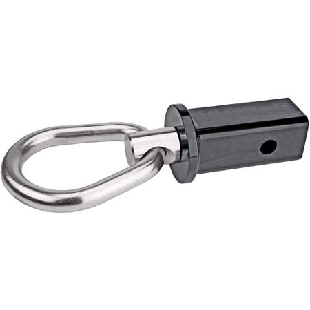

I use the Reese recovery ring. 25 bucks and hooks into the factory hitch and safe for 10,000lbs.

Wow, lots of thoughts on the recovery issue. Thanks everyone for your input. I've learned a fair bit from this forum and continue to learn.
Thank you for the offer! It is very generous. As I mentioned I bought another one from ebay, so I don't need yours. Also I seem to not have explained what I did properly. The bracket that you show has two holes on both side "flanges" for the two bolts to go through. So the bolt goes through both sides of the bracket. I only cut one of the two flanges to clear my aftermarket bumper. The other I did not cut. So the bolt at the bottom, goes through both the left and right flange and the bolt on the top only goes through the right flange. So kind of like having 1.5 bolts
Great visual! Those terrafirm swivel recovery points are much beefier. They will be on my xmas-list.
Just saw this sentence. What does it mean? Is there a bolt that is harder meta than the stock bolts? Thanks!
Old Oct 28, 2014 | 03:42 PM
  #2269
ZGPhoto's Avatar
Joined: Apr 2012
Posts: 4,533
Likes: 103
From: Burlington, VT
He meant grade 8, not number 8. Grade 8 is a strength rating of bolts that you should use for your bumper and recovery points.
