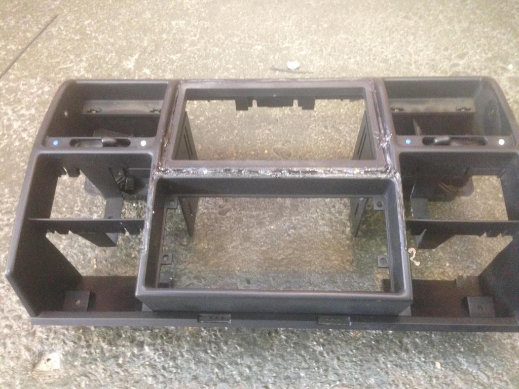

Take pics if you do this please. I put in a kenwood bluetooth regular din size unit, but would love a double din. Does not seem like it would fit, but could come out nice.
Will do. The basic plan is to cut a second dash that i bought, extending the heater controls downwards, creating a space for a double din unit. The trick will be to take my time with the cutting and make sure that I end up with a clean looking plastic facia once done. lots of sanding!

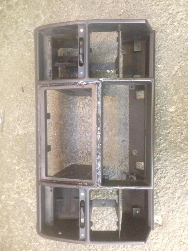

Here's the Dash with the cut made for the Double Din, heater controls moved down. A Double Din kit off of a Mazda fit into the Rover Dash pretty easily. It's all glued together, now it needs filled, sanded and painted.

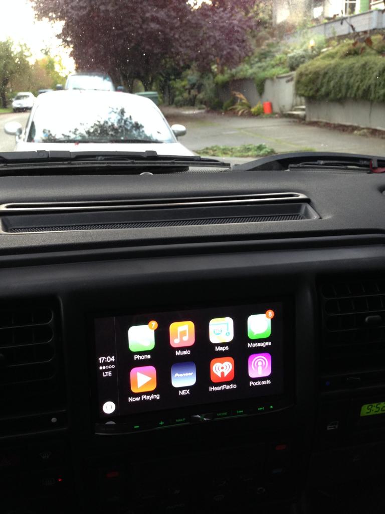

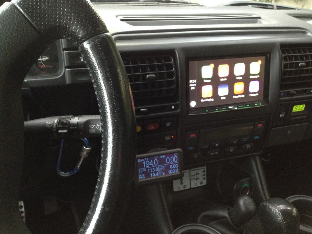

Finished off painting the Dash and the NEX8000 was installed yesterday. For others doing this mod, the NEX8000 is really tight for room at the back of the Dash. I flashed the firmware to 1.08 to provide Carplay support.
A couple of learnings.
The installation manual and operating manual are very vague and plain misleading when it comes to the video mirroring feature. The only supported video out to the rear monitors is RCA (analogue). What this means is that all of those really cool integrations with iPhone and Android devices using HDMI are pretty much useless when it comes to using the NEX8000 to drive a full car video system.
I'm (hopefully) getting round this problem using a digital HDMI to RCA converter.
Amazon.com: Etekcity® HDMI to AV Composite RCA CVBS Video + Audio Converter For TV PS3 VHS VCR DVD: Electronics Amazon.com: Etekcity® HDMI to AV Composite RCA CVBS Video + Audio Converter For TV PS3 VHS VCR DVD: Electronics
Either Pioneer needs to convert the rear monitor video to analogue internally or they need to add a HDMI out on their Headunit. Now I have to pull the Dash again, and switch the input into the NEX from HDMI to RCA.
Other than that, the sound is superb, in car siri is great and even the NEX inbuilt Nav works really well and comes with an offroad mode for me to play with.

It does look good, but to be honest, I think a flip up unit might be better in a Disco 2 because the height of the dash is so low. I noticed that tonight when I was moving my wife's LR4 into the garage, her dash nav is much much higher. I went with the in dash system because I want to install a bunch of gauges in a mudpod right where the rubber piece sits on top of the dash.
