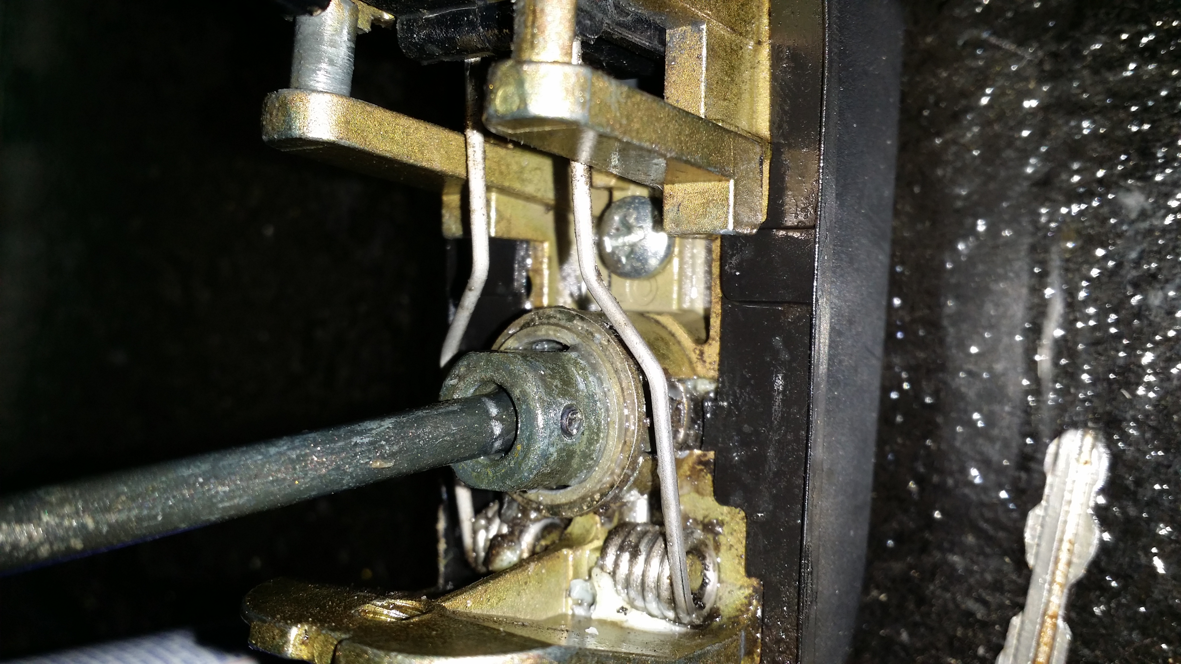

Originally Posted by LRDISCONEWBIE777
Did you check continuity of the + and - terminations? Did you check each conductor of your circuit for zero resistance?
There's a 'arm' that attaches to a lever and that lever is attached to the lock. Mine came loose a week after I bought the vehicle.
I took the door handle out to take a good look at it at home...but the key doesnt turn even when it is disattached. it is driving me crazy.

Originally Posted by cmmoyer
Replaced the drivers side door lock actuator as well as the broken key cylinder pin. Need to to take it up to someone who has the proper computer to enable single point entry.
what does it do when the pin is broken?
I am trying to find a solution to my problem. Key goes into the cylinder but doesnt turn. I tried wd40, dodnt help at all.

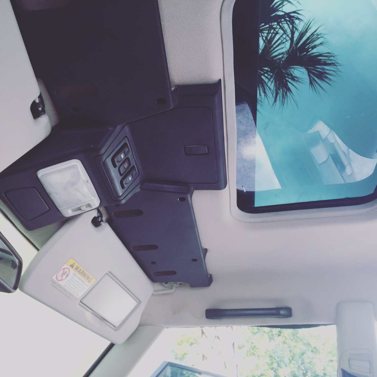

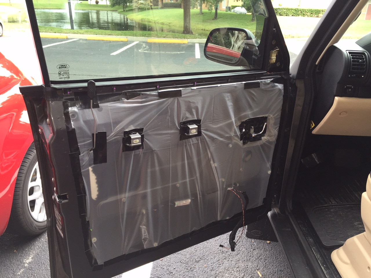

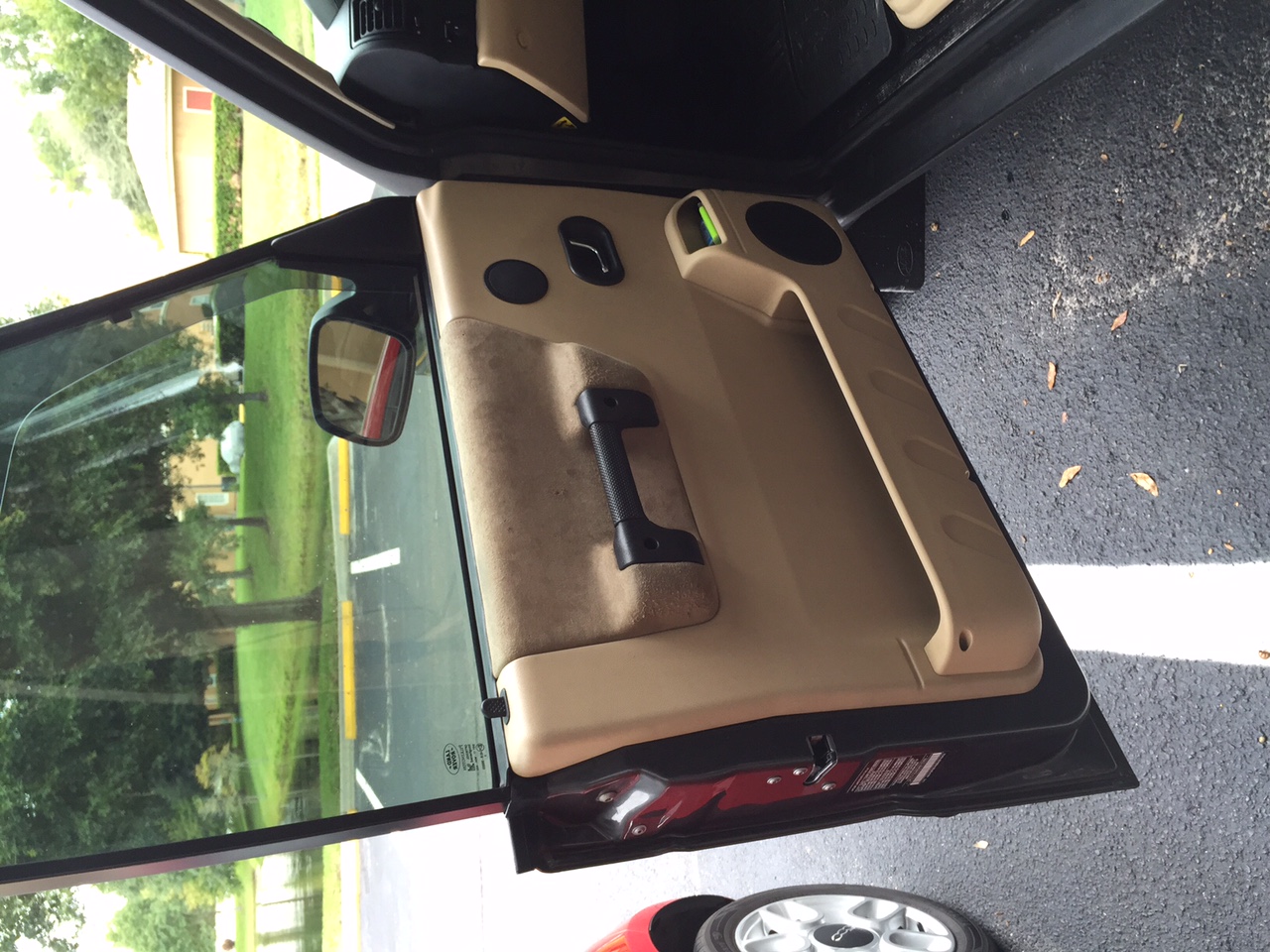

Fitted a new vapor barrier over the front driver's door panel and reinstalled the door card with new black pull handles. Also painted the overhead dash panel. Looks pretty nice if I do say so myself.
Attached Thumbnails What did you do with your DII today?-img_0364.jpg   What did you do with your DII today?-img_0363.jpg   What did you do with your DII today?-img_0365.jpg
The pin is a little linkage that connects the cylinder in the door handle to the lock motor assembly. They tend to break where they are held in place in the door handle. If it is indeed broken the cylinder will spin freely inside the handle. Mine always takes a little bit of wiggling the key to get it to want it to turn.

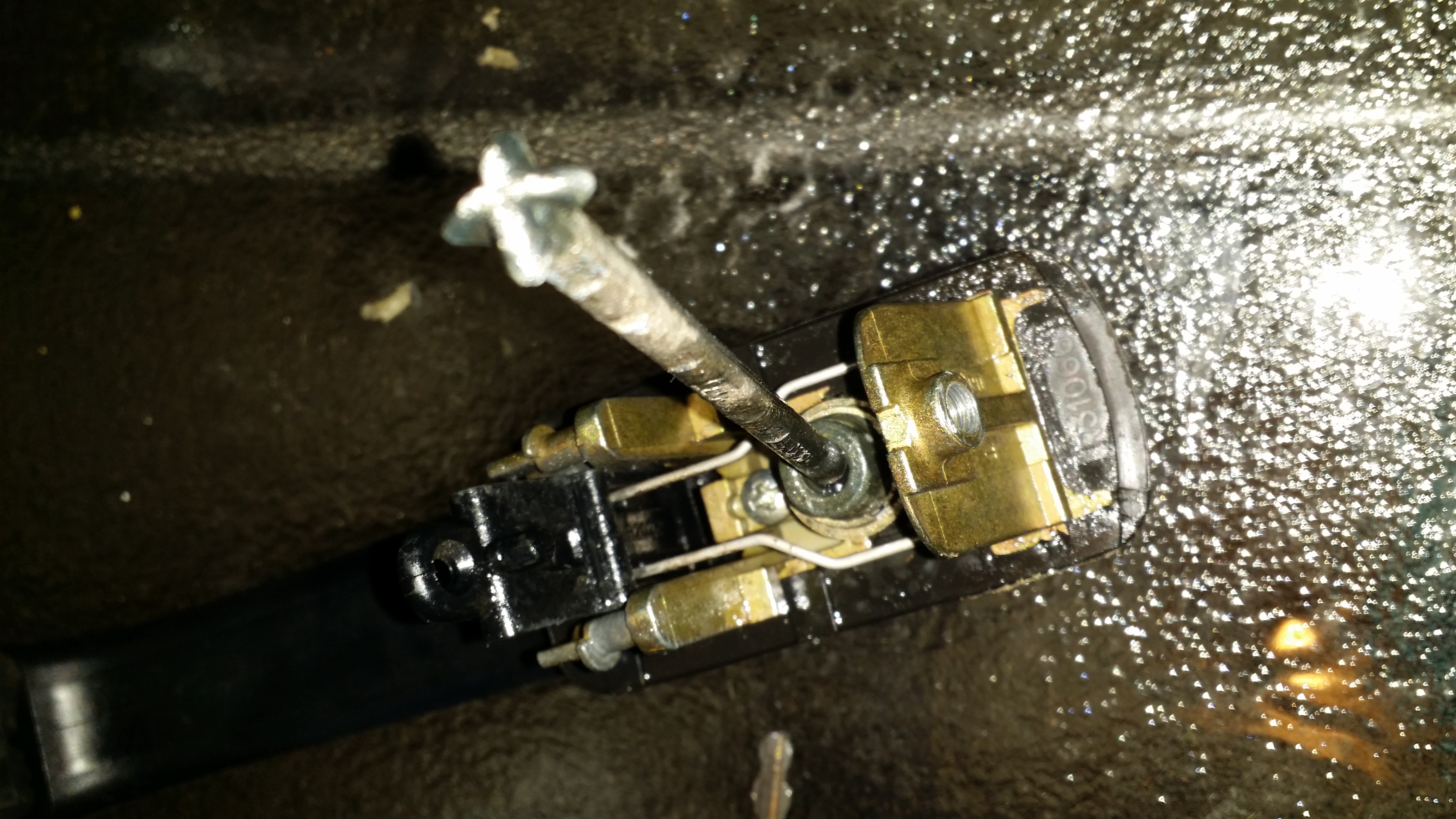

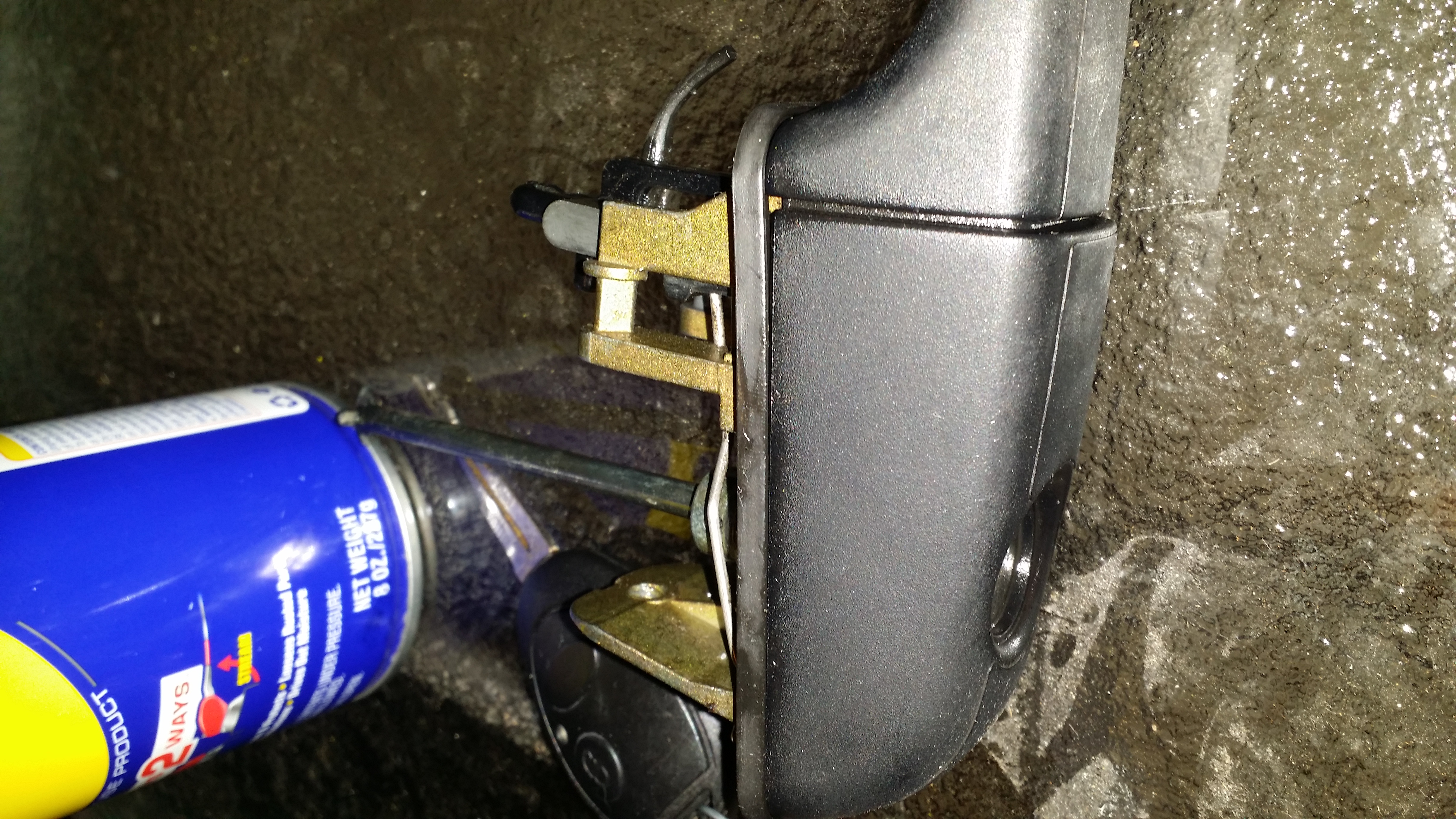

this is what mine looks like by the way, it is not spinning freely. it is the opposite, it doesnt turn at all, not even a little bit.
