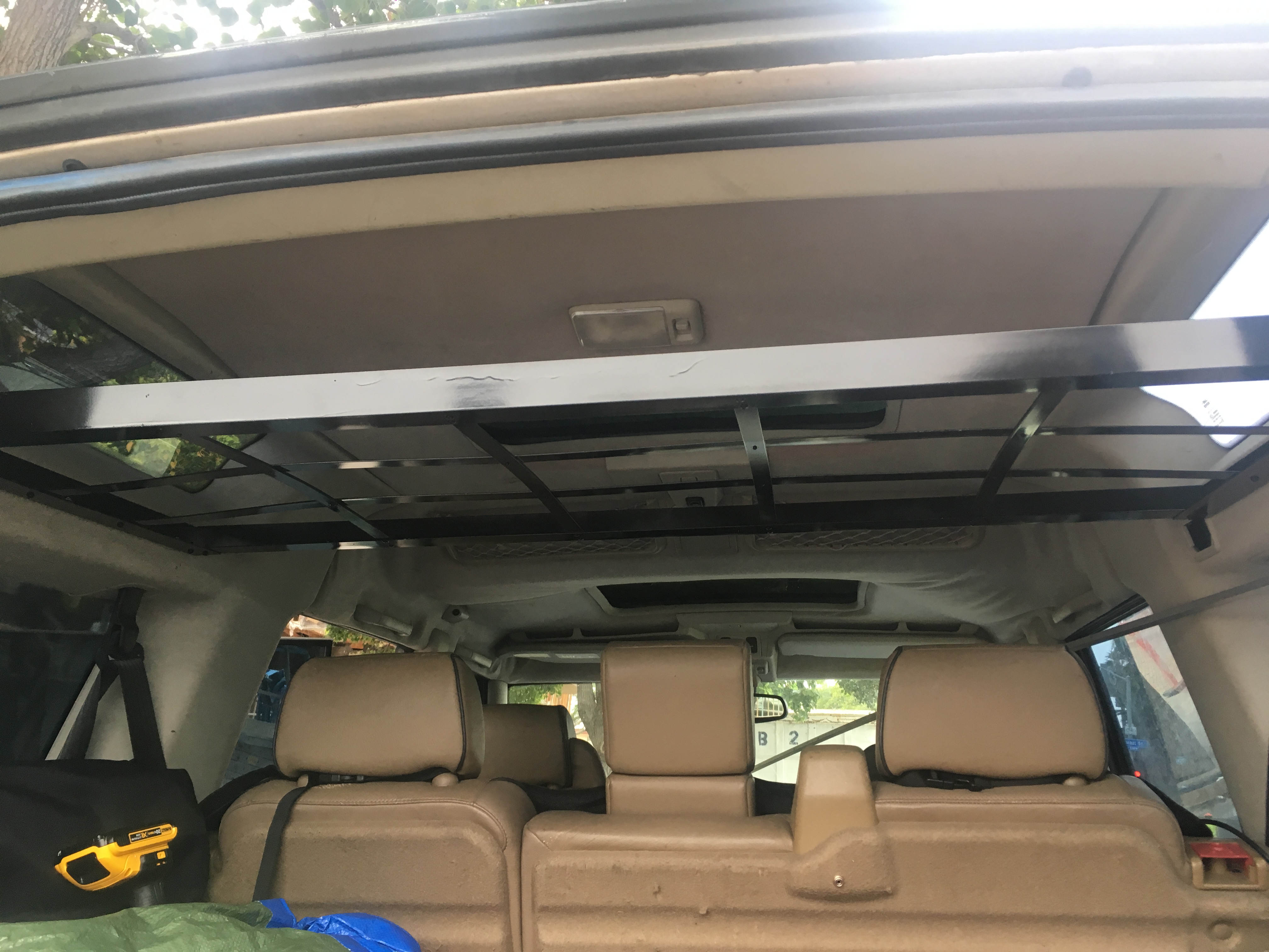

Inspired by the Mantec load lugga but completely unwilling to shell out £150 plus overseas shipping, I finally got around to building and installing this. Came out to around $50 and a few hours of labor. Could've spent a few more making it look less janky but doesn't bother me a bit. If I had to do it again I'd go for some square stock instead of L to stiffen it up, but so far so good.

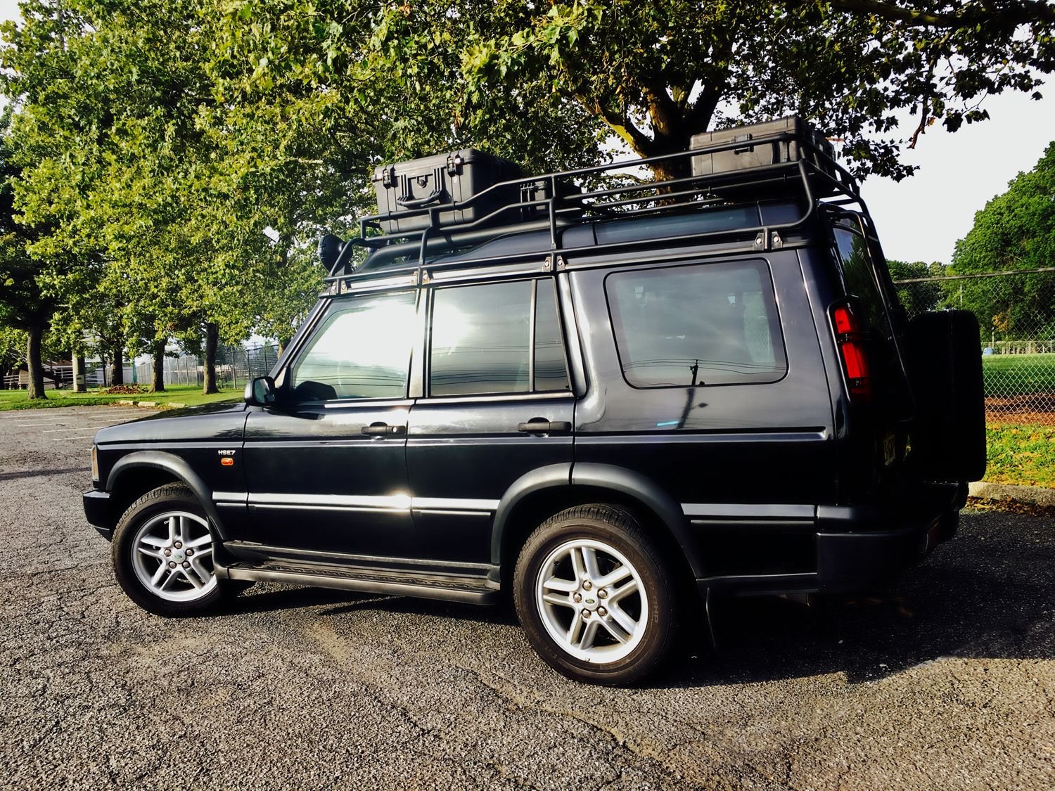

Clean the rust first as good as possible. Wire brush or circular metal brush attached to grinder. Then clean up with alcohol or some sort. Apply Krud Kutter rust converter, wait till rust comes off. Spray rustoleum (black) rust reformer then spray with flat black. Or you can under coat with rubberized undercoating paint. Do it when humidity is less. In NJ weather and salt during winter, very very few visible rust showed after 4.5 and 1.5 years ago when I did my other discos. Those spots were probably spots where I rushed off.

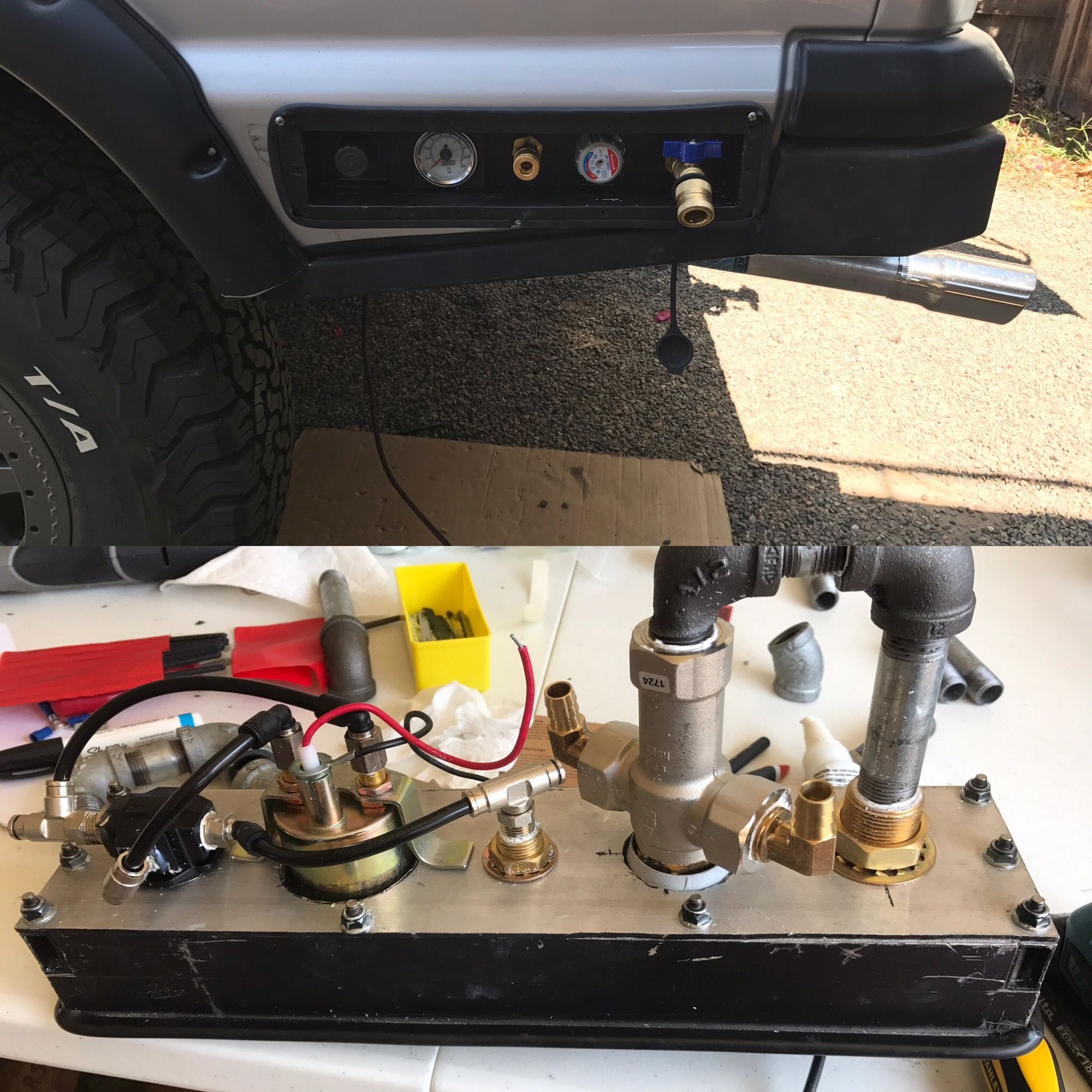

Home stretch for onboard air and water
Gotta mount the heat exchanger, plumb it up, and test it out

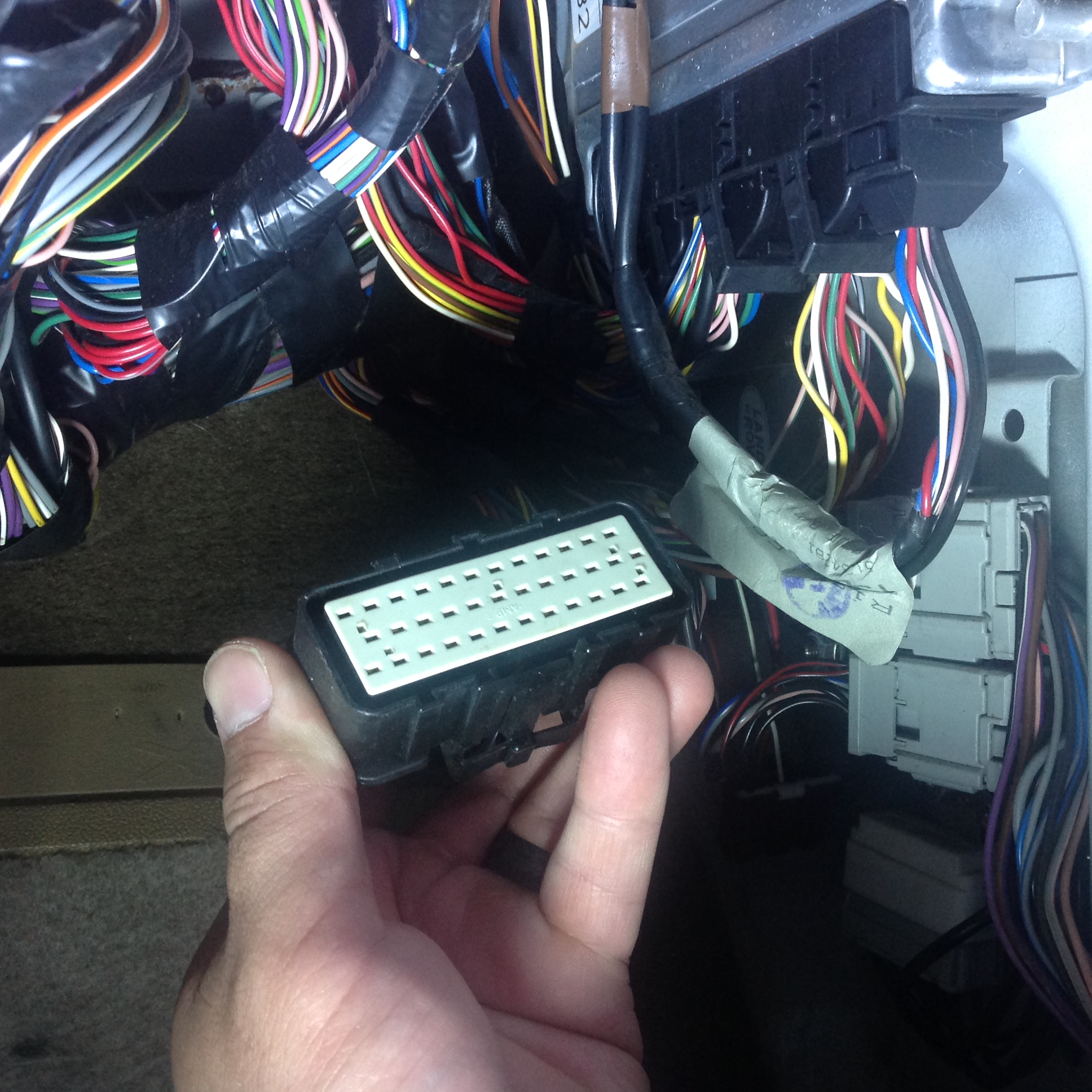

Found a connector just hanging out under the passenger side of the dash. Any thoughts on where it may go?? Or should i say, used to go?

Fingered it out. Ace ecu plug.
