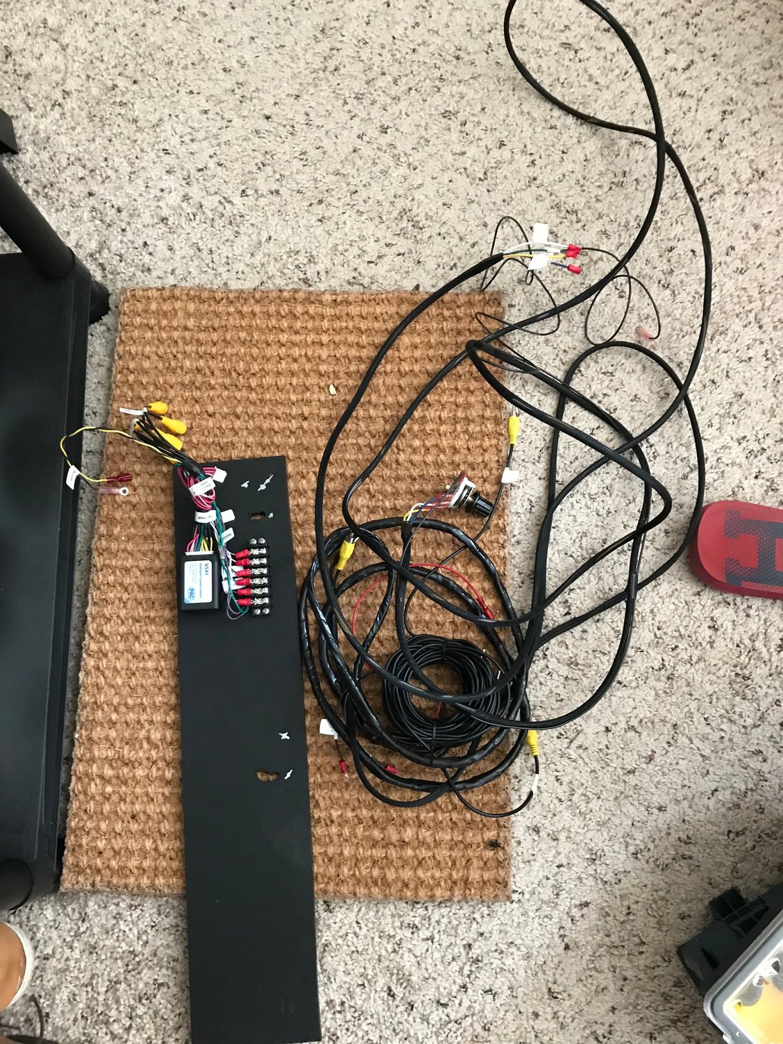

Working on a 4 channel camera system.
1. backup
2. under car, front axle, facing rear
3. under car, rear axle, left side
4. under car, rear axle right side
2-4 are for spotting lines on the trail as I mostly travel single vehicle
A rotary switch will go up front to toggle between the different cameras.
Mostly just a fun project, hopefully it will actually turn out to be useful. Finished pics tomorrow
each camera has LED's on them. I have rock lights as well
