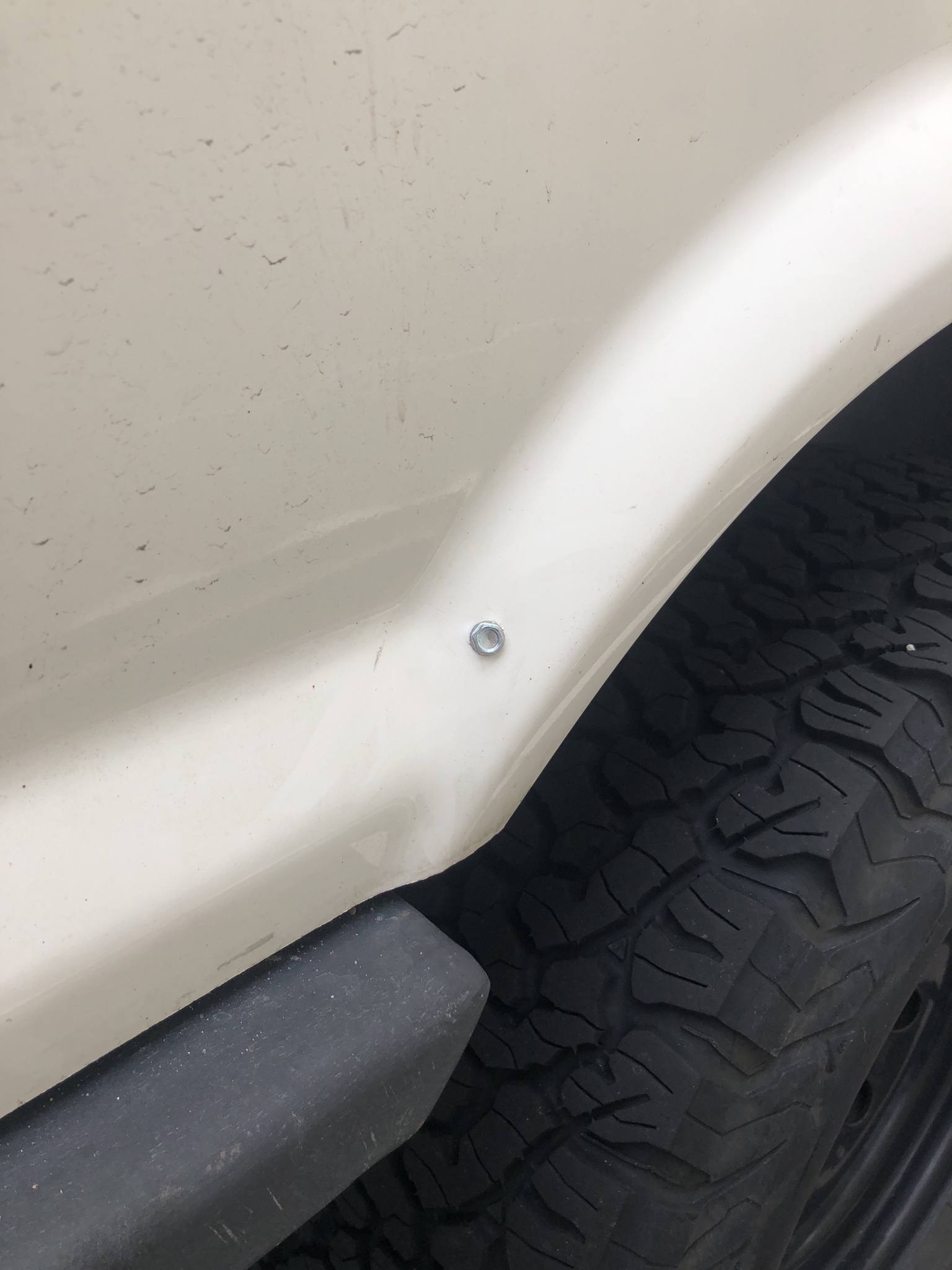

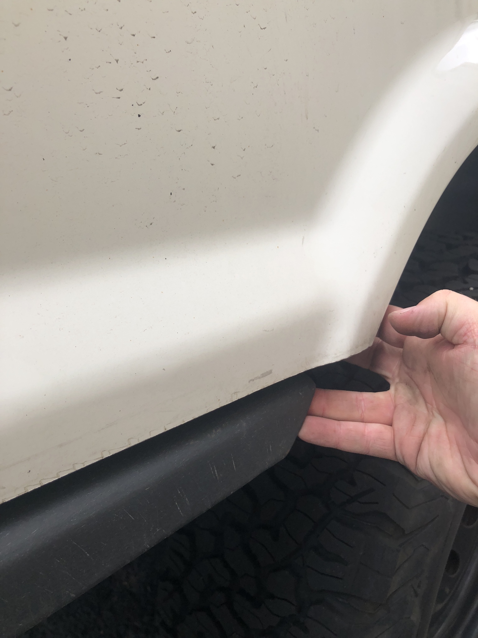

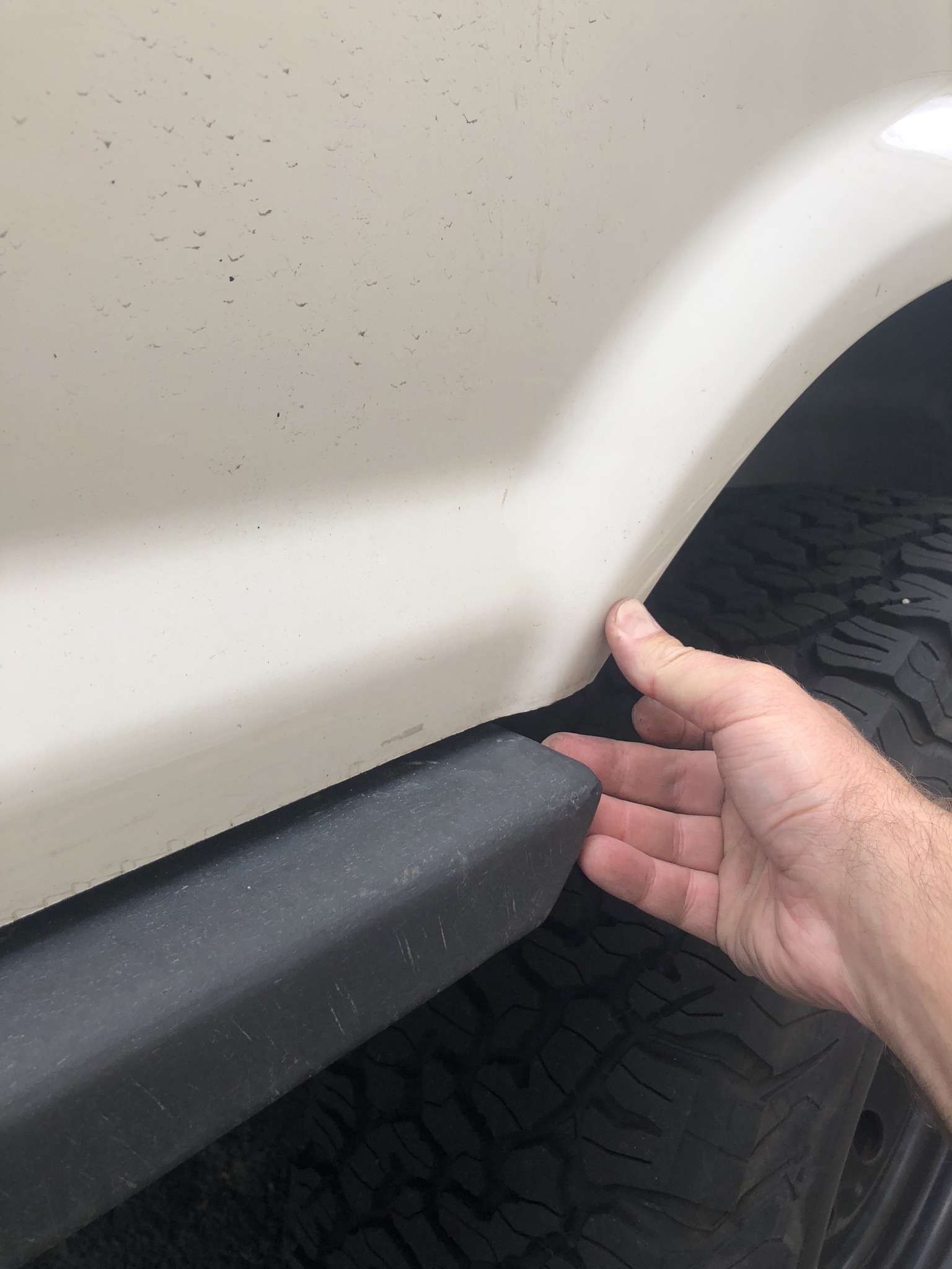

Did some body work with 2 tech screws today. The rear quarter panels were cut down for the install of the rear bumper but were never secured etc -- AKA they are super flimsy and make noise when driving on the HWY. 1 screw on each side solved that problem
Panel pushed in:
Panel pulled out:
SCREWED
Panel pushed in:
Panel pulled out:
SCREWED
