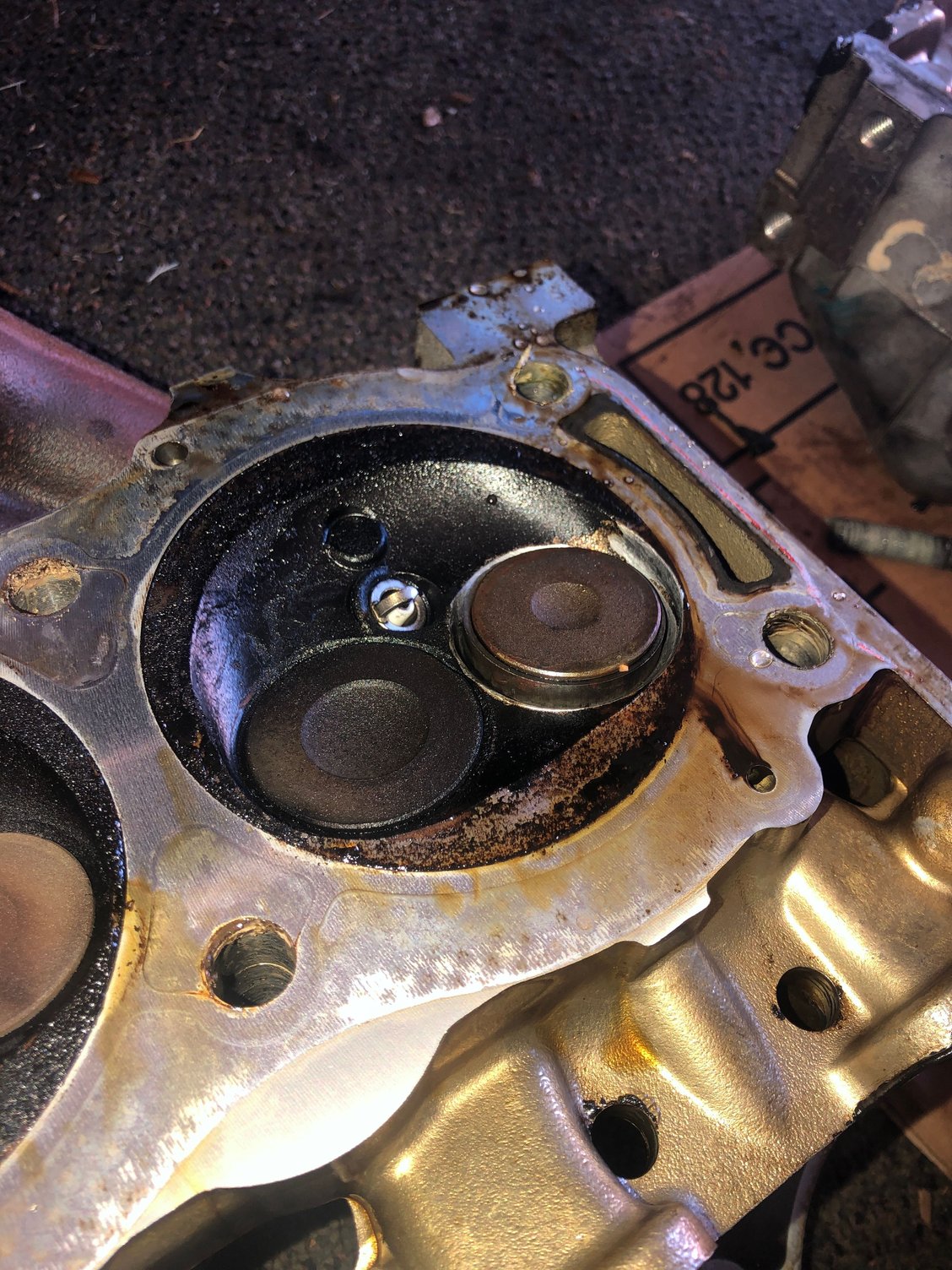

Yeah, looks like valve seat came out. Not common, but it happens. A severely overheated engine can sometimes do this, heads expand so much...seat drops out. Not always the case, but it happens.

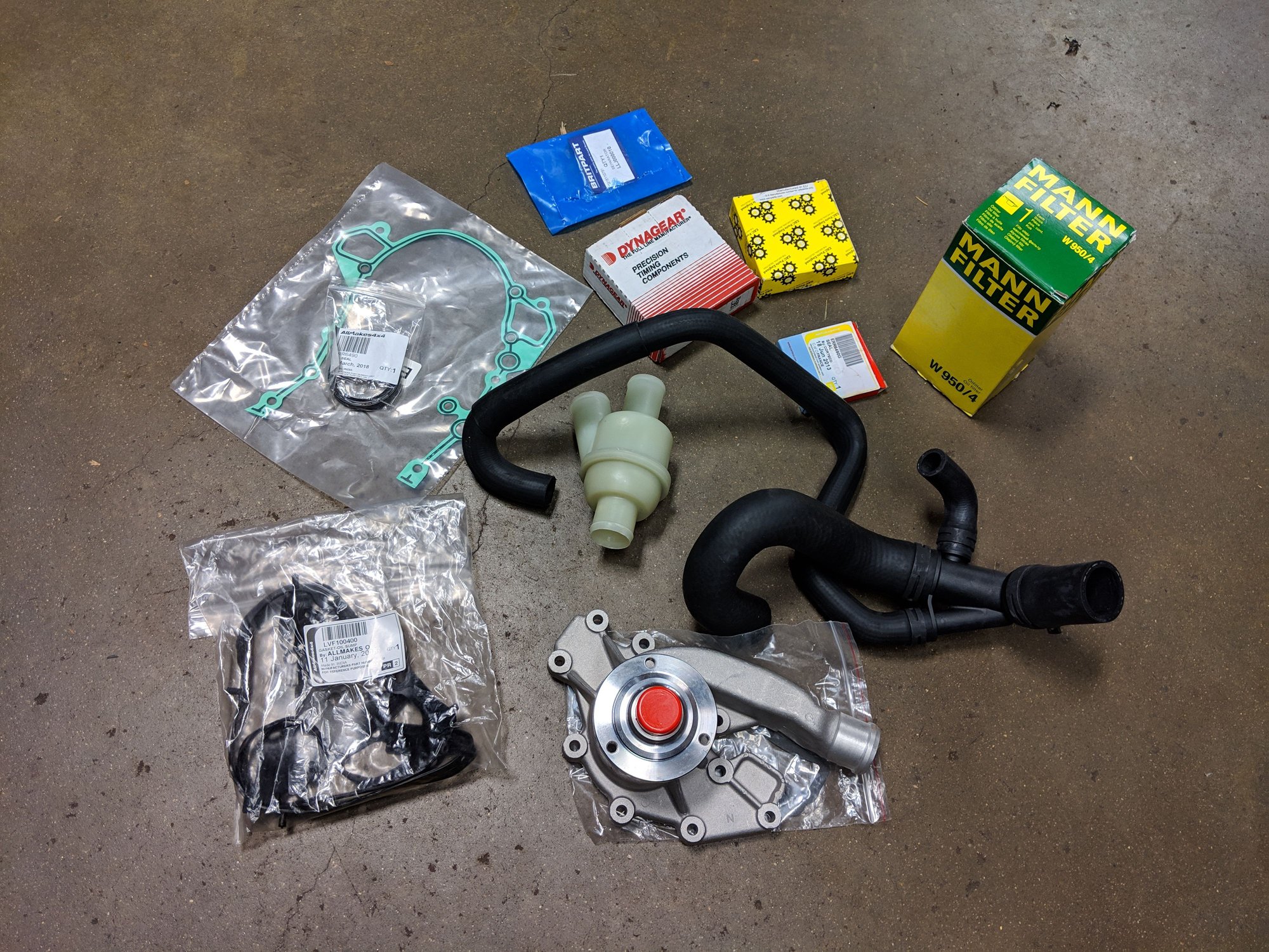

Had a oil leak from the front cover so decided to tackle that yesterday. Oil pump gears, timing chain, clean the pickup tube screen. Water pump, T-stat, hoses, gaskets, etc... Now will see where else it's leaking from.

Damn there's a lot of garbage in that screen. When I did mine at 310000 km I had virtually nothing on the pick up screen, and I was shocked at how clean my internals were. That front cover job can suck it though, I wish you the best of luck

Yeah, I was really surprised too. Everything went well. Only thing I'm not thrilled about is my coolant temp now. It had a 180 tstat in before. The one I had already is a stock one. Now it's 195-200 all the time, which is normal. I just liked being at sub 187 all the time. Degreased and person washed it all this morning. Now to see if there's any other oil leak remaining.

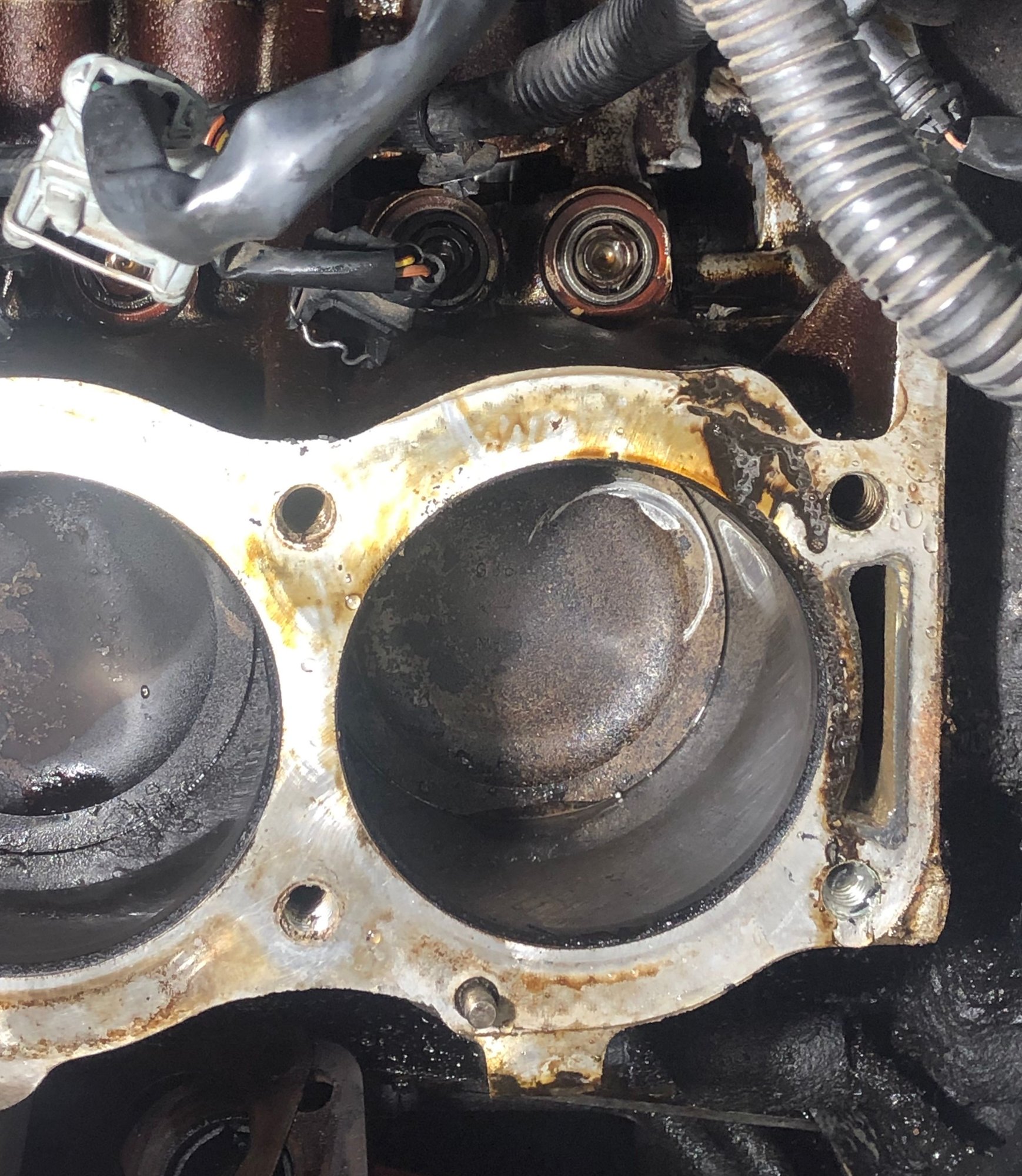

Originally Posted by RossN99
Well it appears cylinder 7’s misfire goes deeper. After a few days of not being able to work on the car I got around to getting the heads off and discovered that somehow this piston came in contact with the valve/head.
this is a broken, or otherwise comprised valve spring. Ask me how I know! 😂
