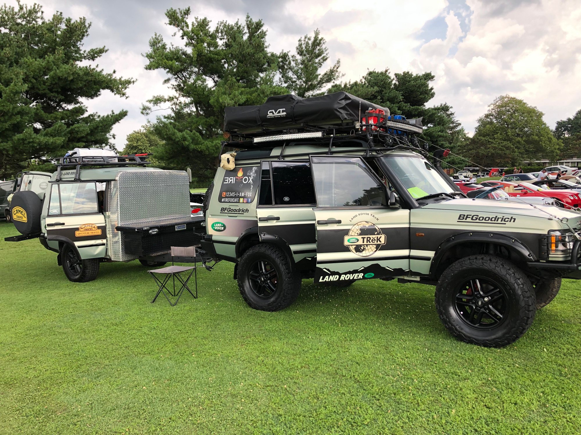

Was at the vintage Grand Prix in Pittsburgh over the weekend and saw this , pretty well done

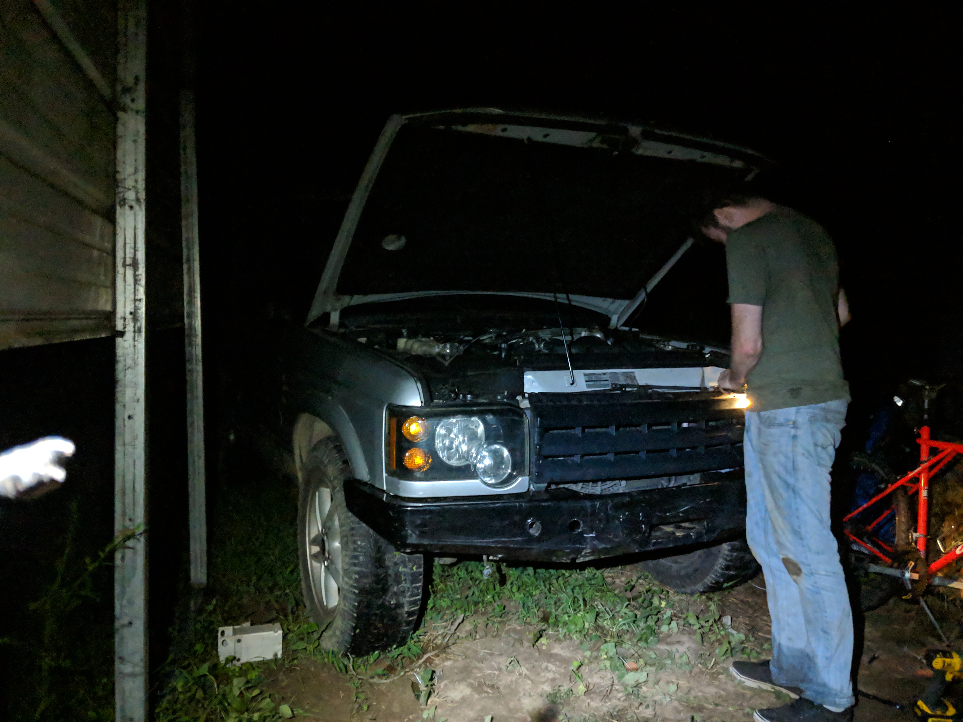

Just spent the last 3 or 4 hours modifying a terrafirma bumper for a P38 Range Rover for a Discovery 2. Buddy already had the bumper for his range and didn't want to buy another for the Disco, so we whipped out the grinder and welder and sure enough, we got it on there.
It was a bigger undertaking than expected, and it's not winch ready just yet, but it's good enough to drive around on for the time being. Looks way cooler, too, and I got a good factory bumper out of the deal.

Chris, of Dark Crow designs out of Ohio was the fabricator for both that truck and the trailer I believe.. Kinda funky and over the top, but also pretty cool. I think every ARB interior switch ever made may be wired inside that cockpit..

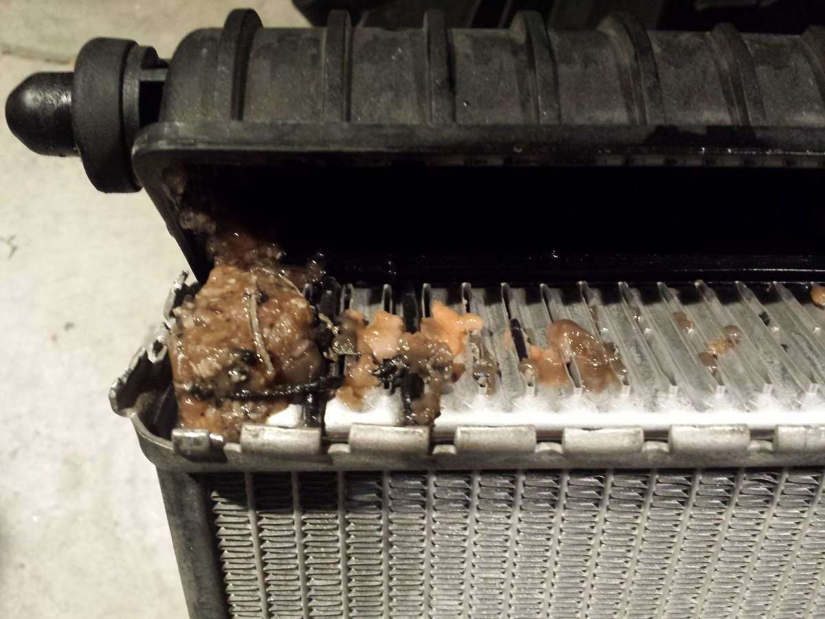

I installed a new radiator, here is the old one.
Opened radiator.

@Discorama What brand of radiator is that?
