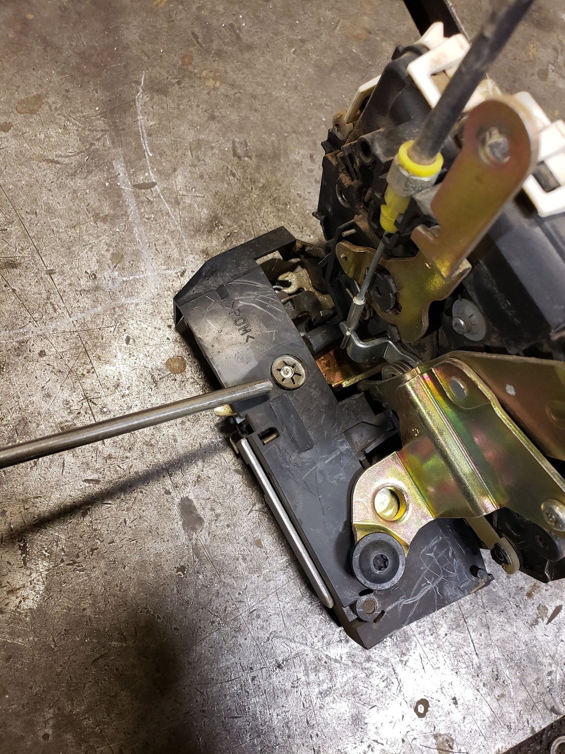

I have a 2004 discovery 2, I have had it about a year and the rear hatch has never worked well but with constant cleaning and lubrication of the latch assembly, linkage and hinges it functions, until today.
The lock and unlock actuator seems to be functioning properly both manually and electronically, I pulled the door panel off and disconnected the rod to the latch release lever, when I try to release the latch by moving the release lever nothing happens. I pulled the weatherstripping out of the way and moved the child lock to lock and unlock so I do not think that is the problem. I held the release lever in the unlatch position and used a 2-foot pry bar between the door and the doorframe to apply a little pressure to help open the door and again no movement, So I know the door is not locked- the child lock is in the unlock position- release lever seems to have full range of motion and the door is still stuck closed.
Is there any other way to manually force the latch to release?
I do not care if the latch is destroyed, I can replace it if I get the door open.
Thank you

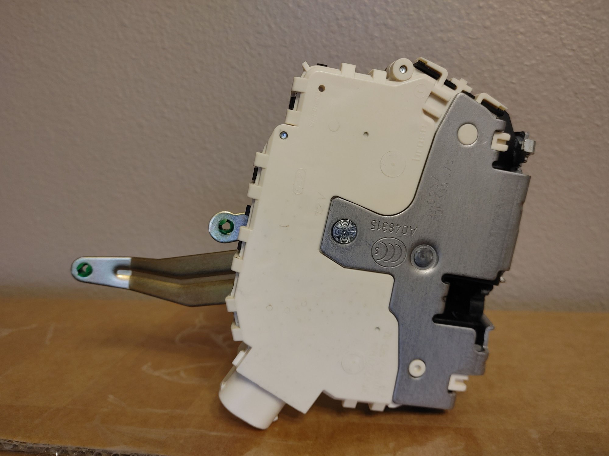

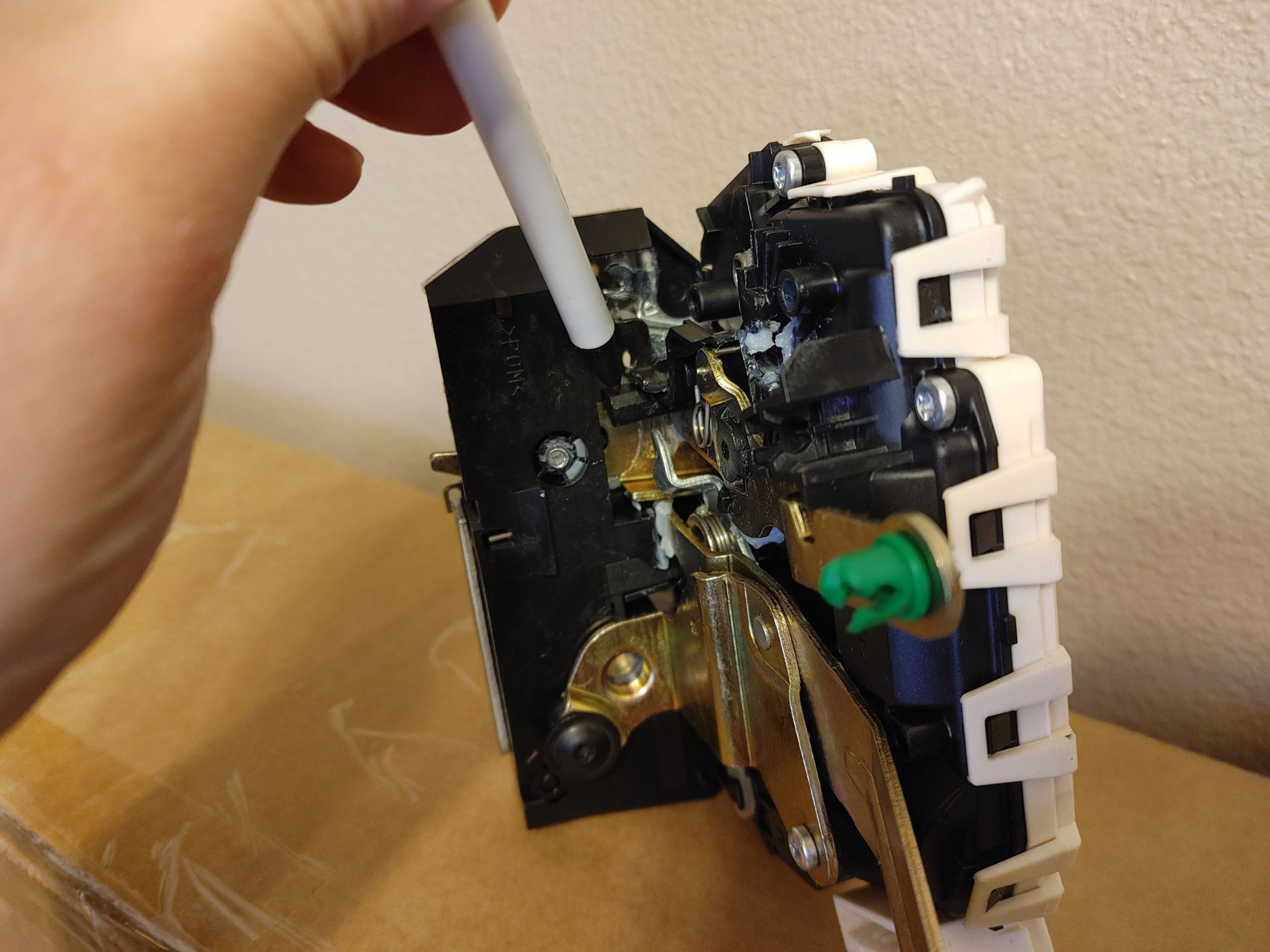

Sounds similar to the issue I've been experiencing, but I've come to find that the child latch lever is the culprit for me (I think). New latch assembly p/n FQR100570.
In the attached, if you press down on the part that the tip of my pen is touching that should unlock it. Without going to my D2 and feeling around, I don't know if any sheetmetal or whatnot may prevent you from reaching it. This is all from just observing the new part I have on hand. Can any of the more knowledgable forumites confirm?
I can get my finger on that tab, pushing down (it does not move) and does nothing, you can push it upwards and that does not seem to do anything either. Thank you for the pictures, Guess I am going to have to buy a new latch assembly and figure out how it functions to find out how to force it to unlatch. I genuinely appreciate your response.

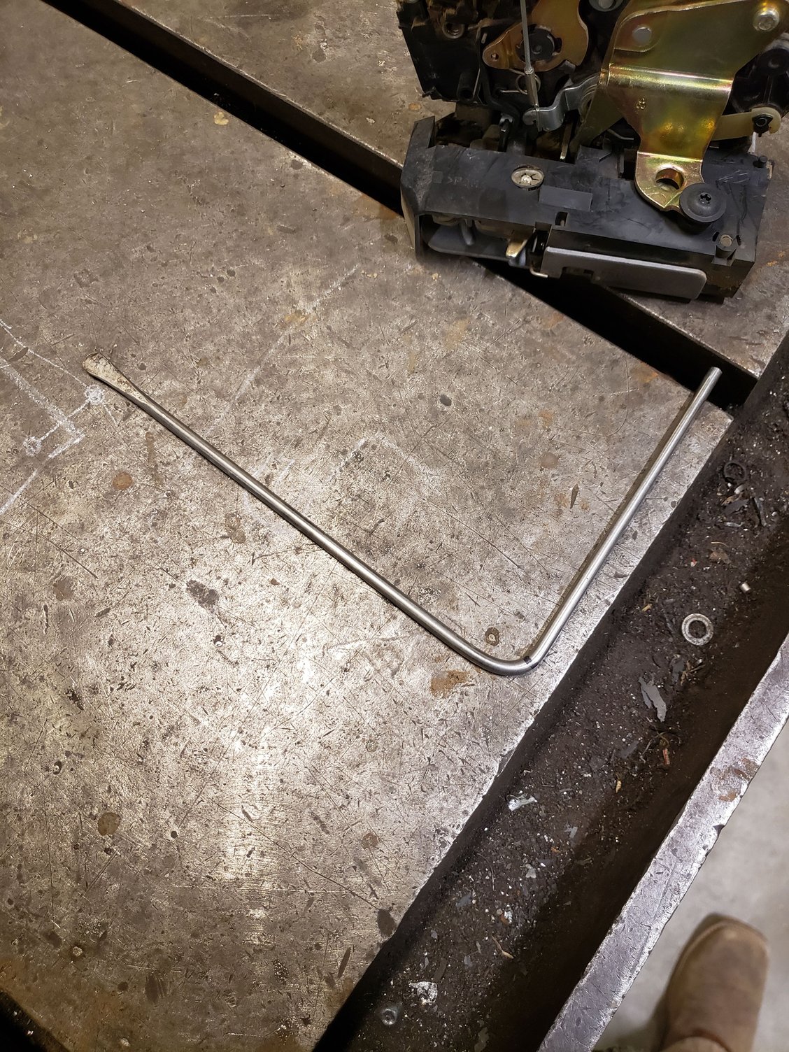

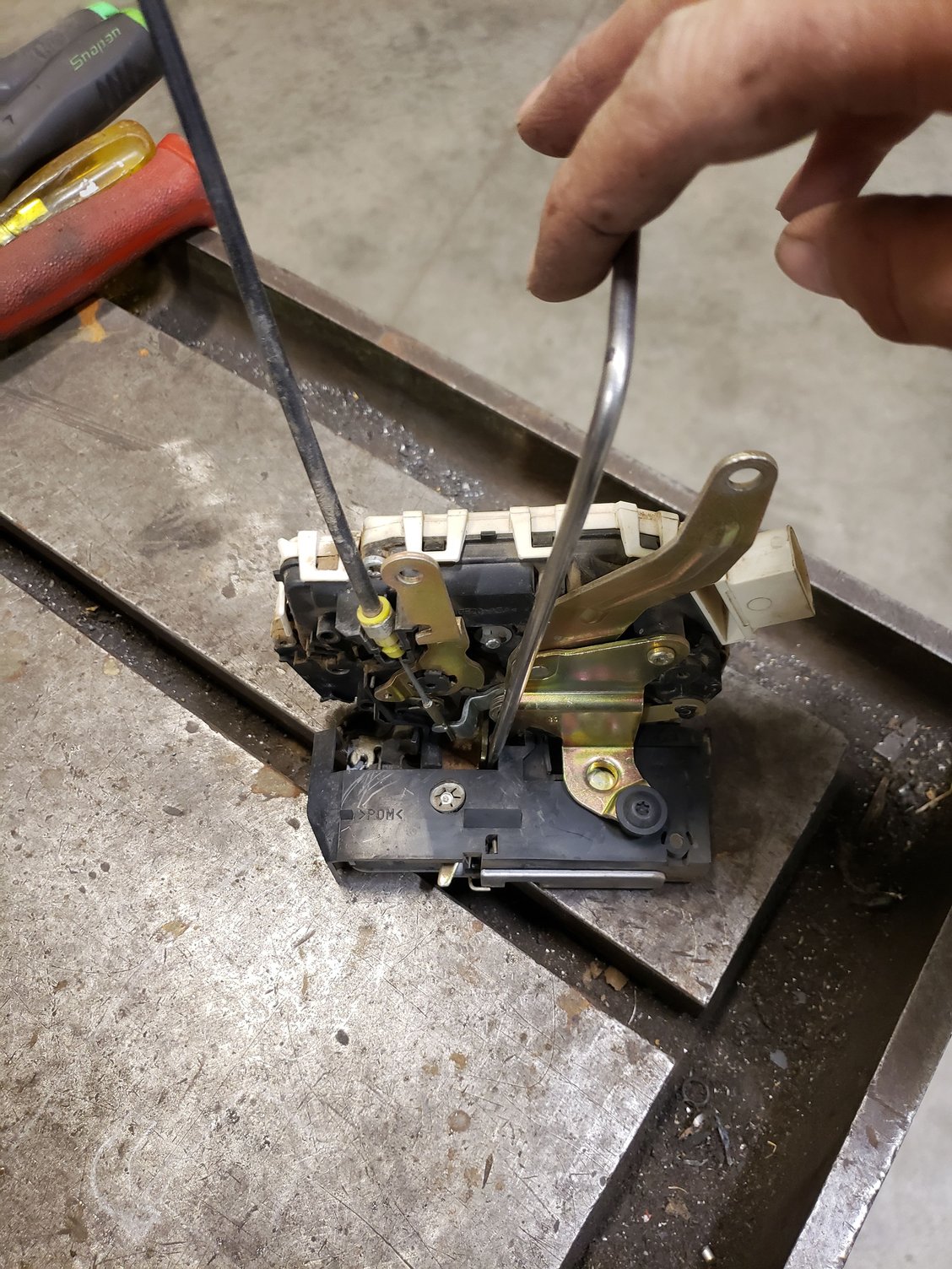

Pin came out of the keeper, preventing full movment
Made a tool that would fit inside door to manipulate the latch
Insert between plastic housing and release lever
Pull down and to release latch
