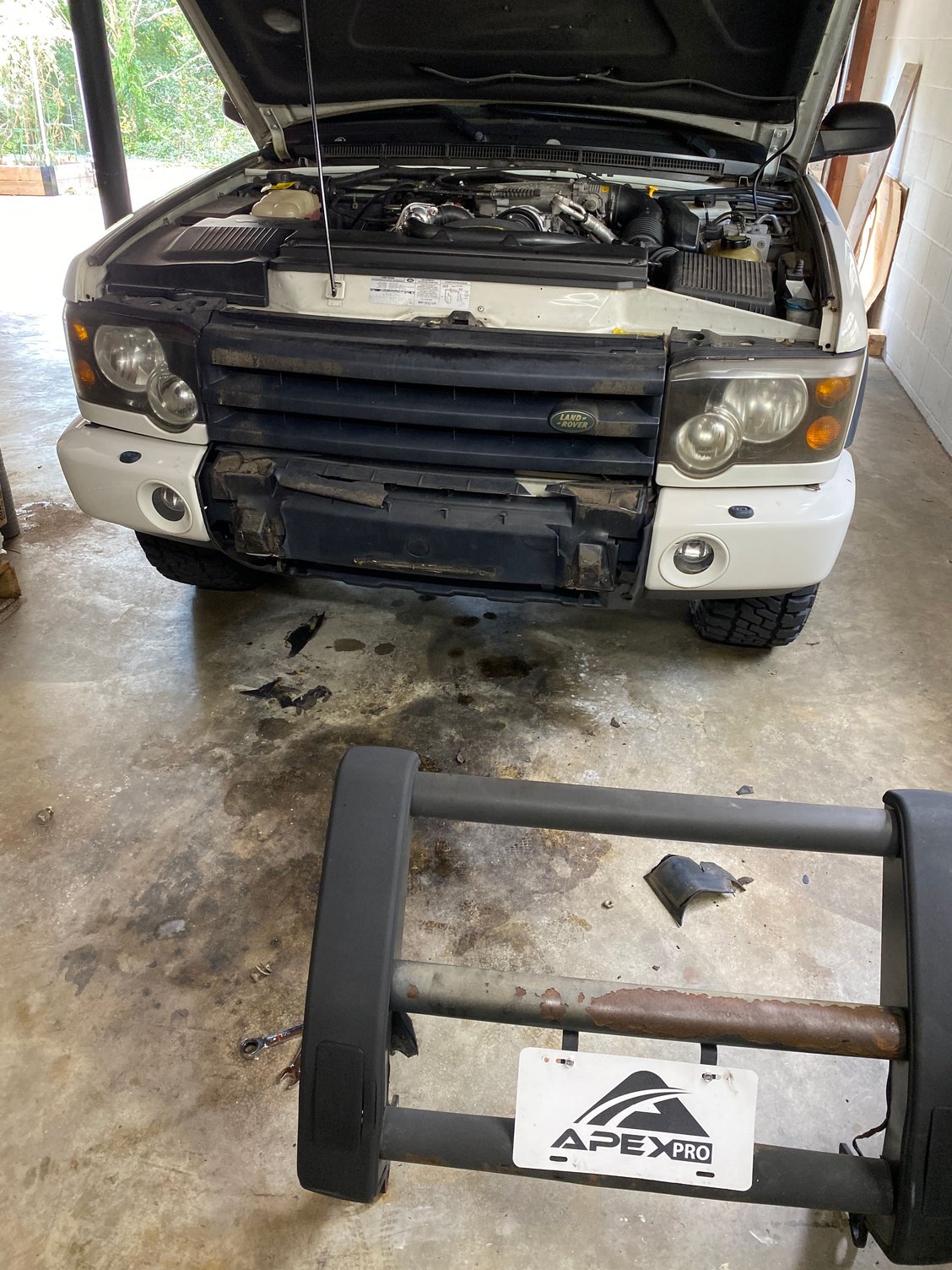

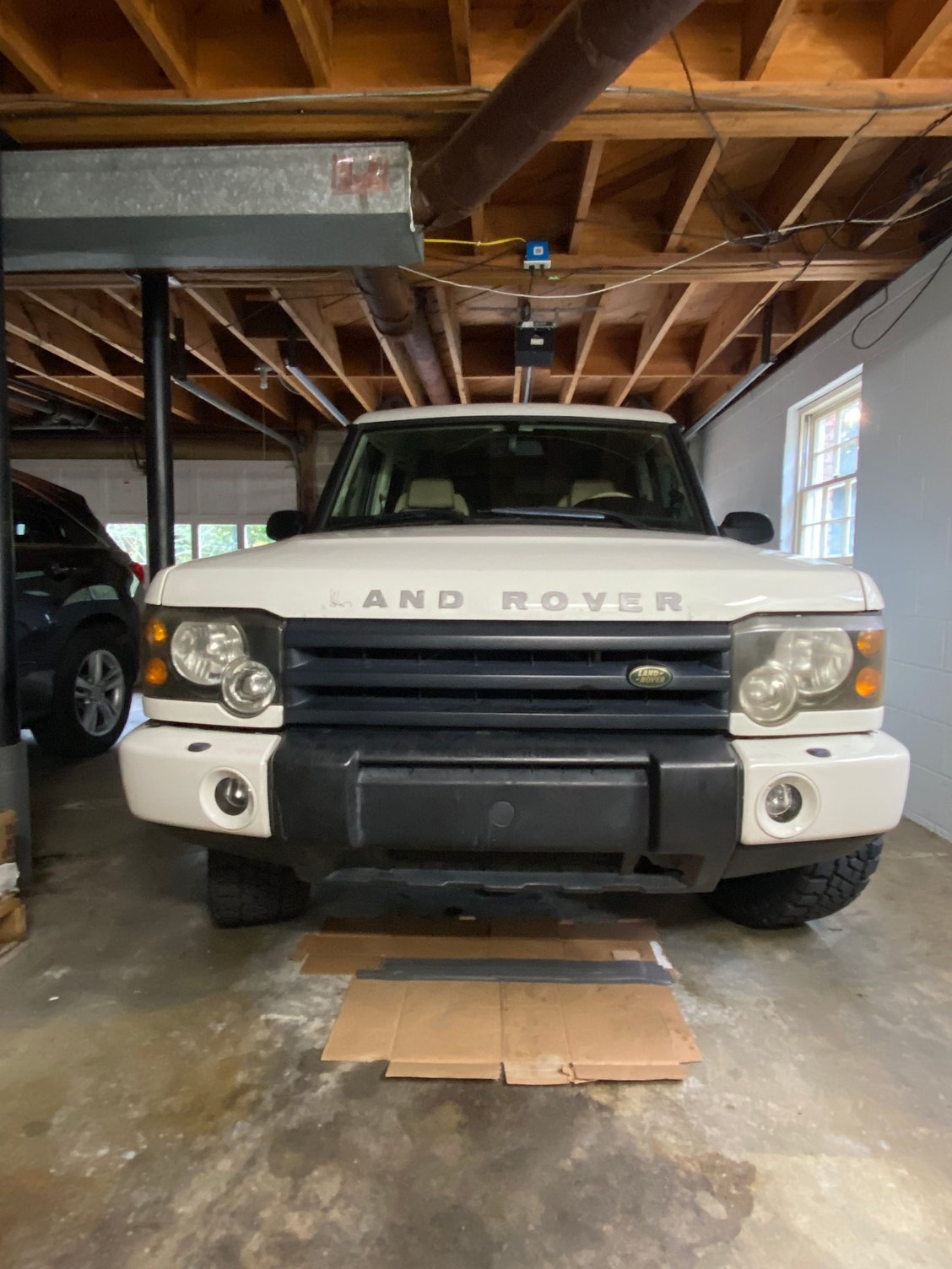

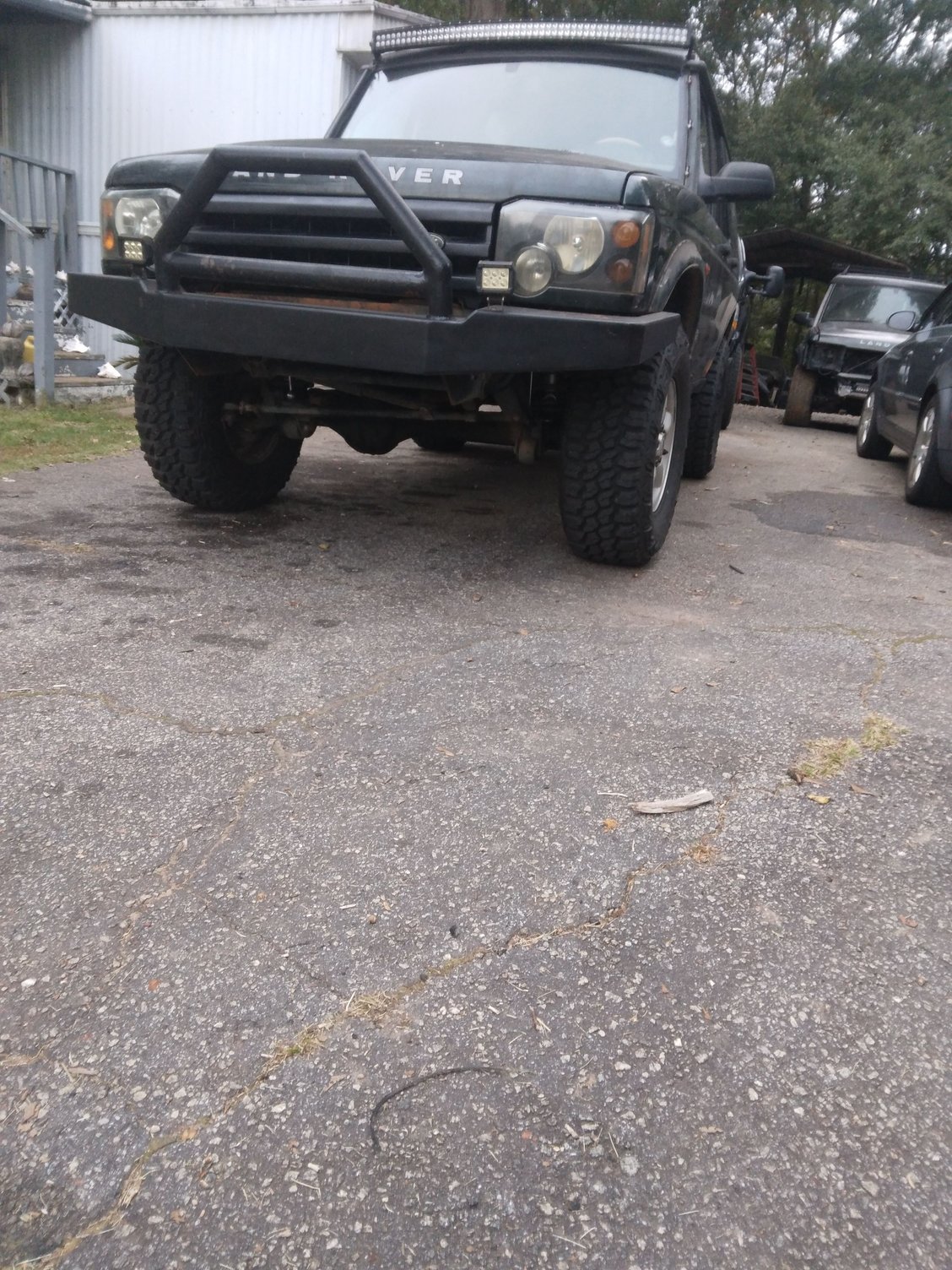

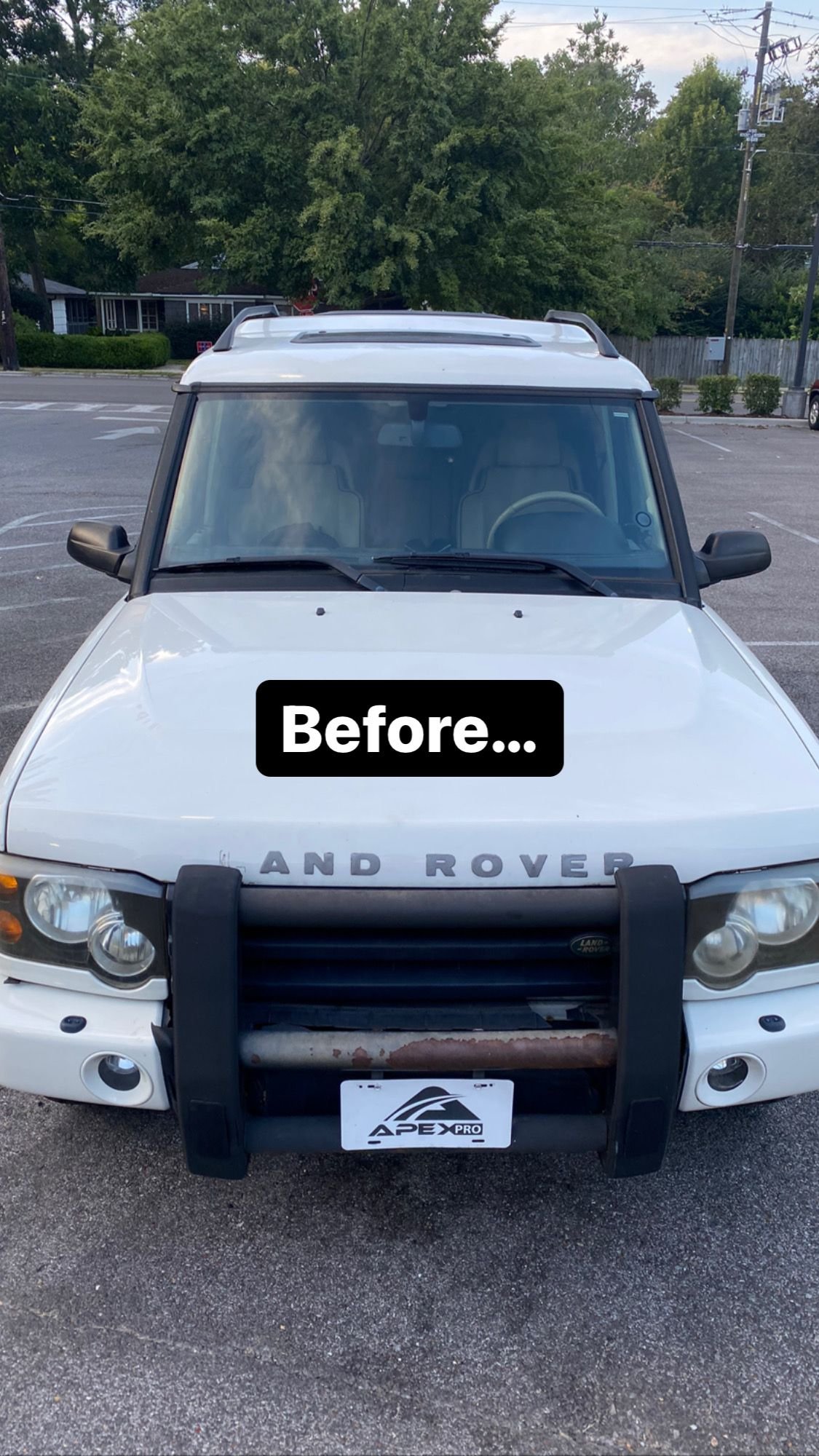

The PO of my truck gave me a decent factory bumper when I bought it it. Apparently the owner he bought it from used the Nudge bar more than once and shattered the plastic bumper cover.
I pulled off the factory nudge guard to repair the rust and paint it, and installed the bumper he gave me that’s in better shape.
Did all that yesterday, today I did Option B after reading my abs codes and having the shuttle valve fault.
Anyone have a spare Land Rover hood emblem? Just the need the letter “L”!! Haha

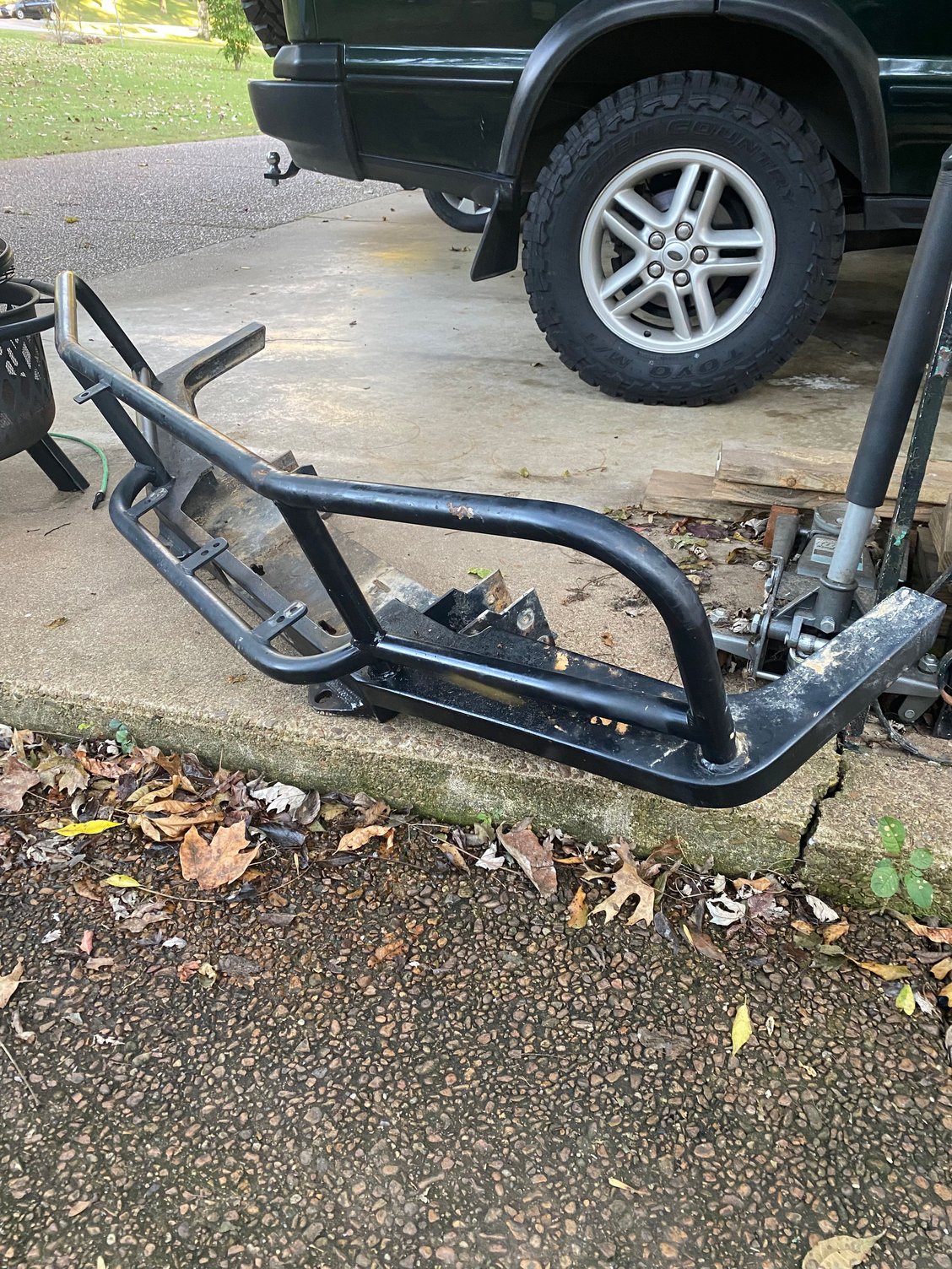

Picked this RTE bumper today. Overall not bad condition. I’ll probably strip it in the spring and re-spray it with some rattle can paint. The powder coat is a little chipped in places. I could sandblast and powder coat it again but at that point it would’ve made more sense to buy new.

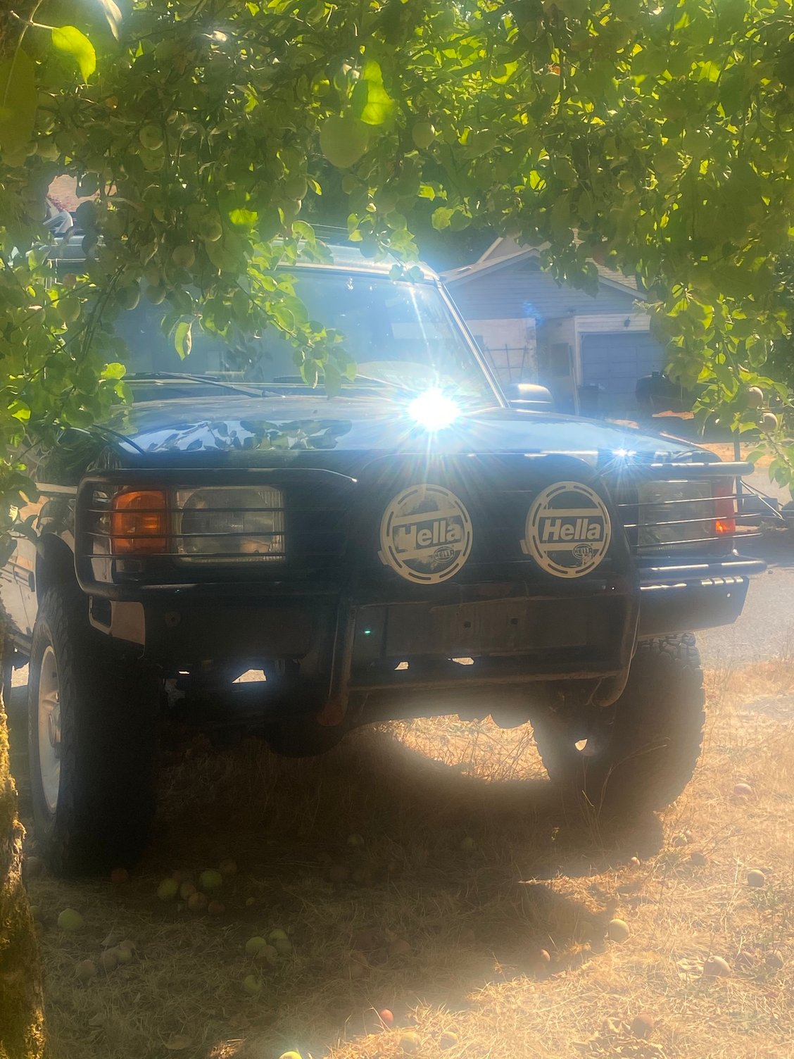

My front bush bumper is a bit rough, with pealing plastic and rust here and there. I think its a stock item at the time.
Since I do go in the bush, brushing on some Tremclad is my friend.

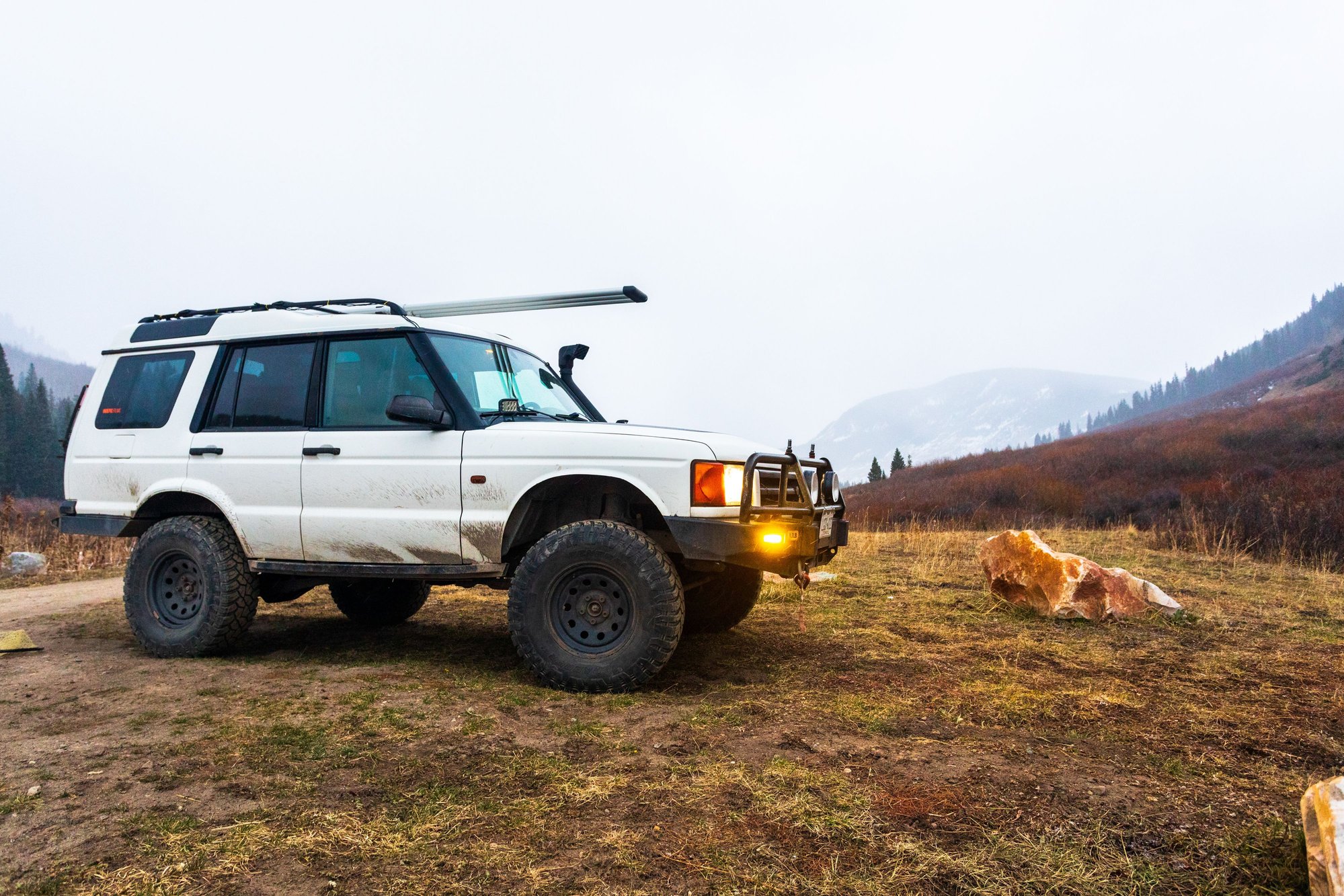

flogged the truck to and from Crested Butte over the weekend. Truck did awesome aside from a gnarly headwind coming home that gave us fits for 20 miles or so.. Got a little exploring in but was mainly a relaxing weekend and the rover was on pavement duty most of the time. While out a snow storm did come barreling down the valley which was pretty wild.

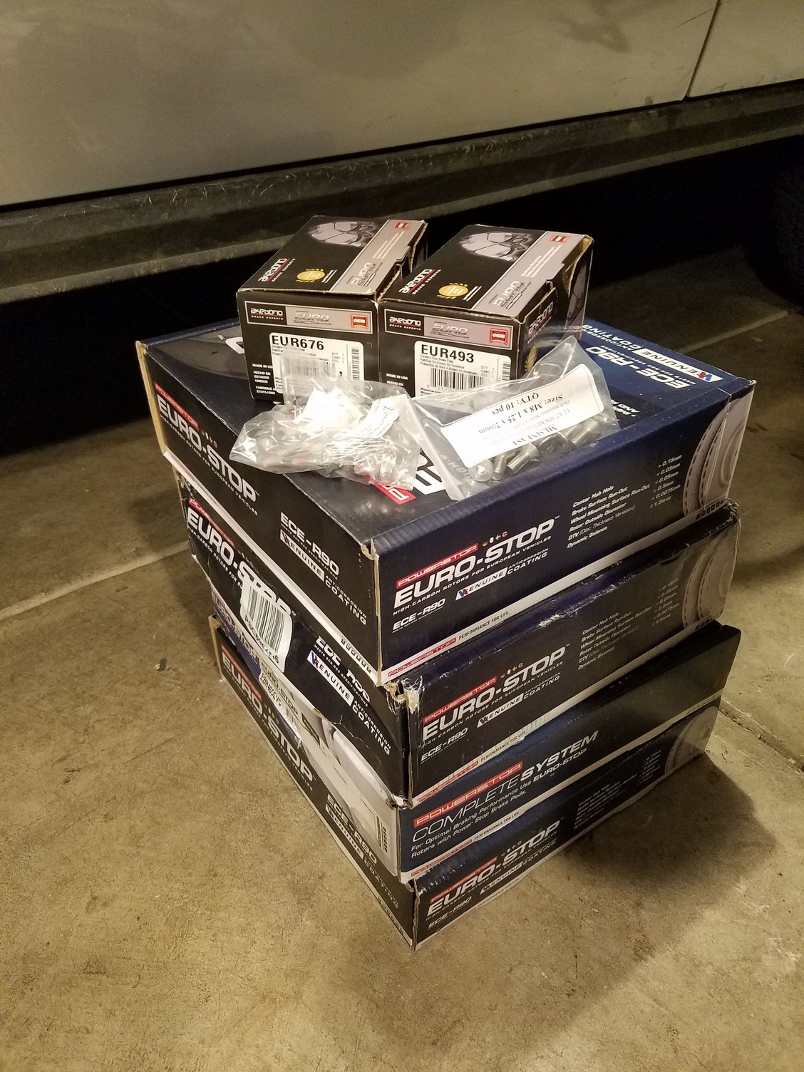

New pads and rotors installed. Front locator screws were missing (less headache), but rear ones had been reused (more headache). Nonetheless all bolts and screws came out the normal way without damage, but requiring breaker bar and impact screwdriver. Got some nice stainless steel M8x20 flat top with Allen key for the locator screws (ebay 10-pack for under$6). 19mm and 13mm 12-point short sockets worked well, long sockets or extension were not needed. Disassembly and assembly went fast, cleaning took most time.

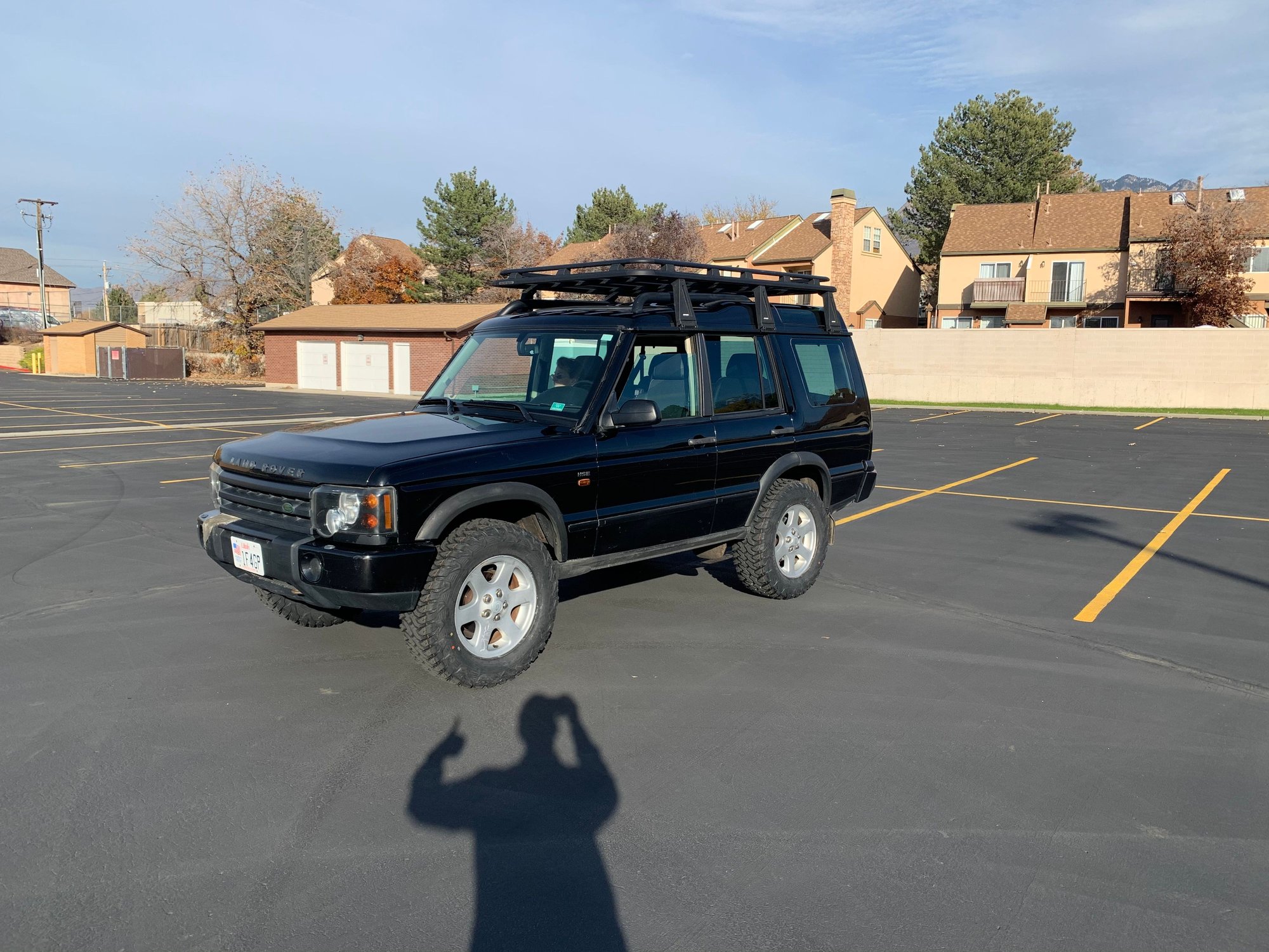

Default Lift & Tires
New Hankook Dynas 275/65 R18 on the stock Comets w/2” spacer
