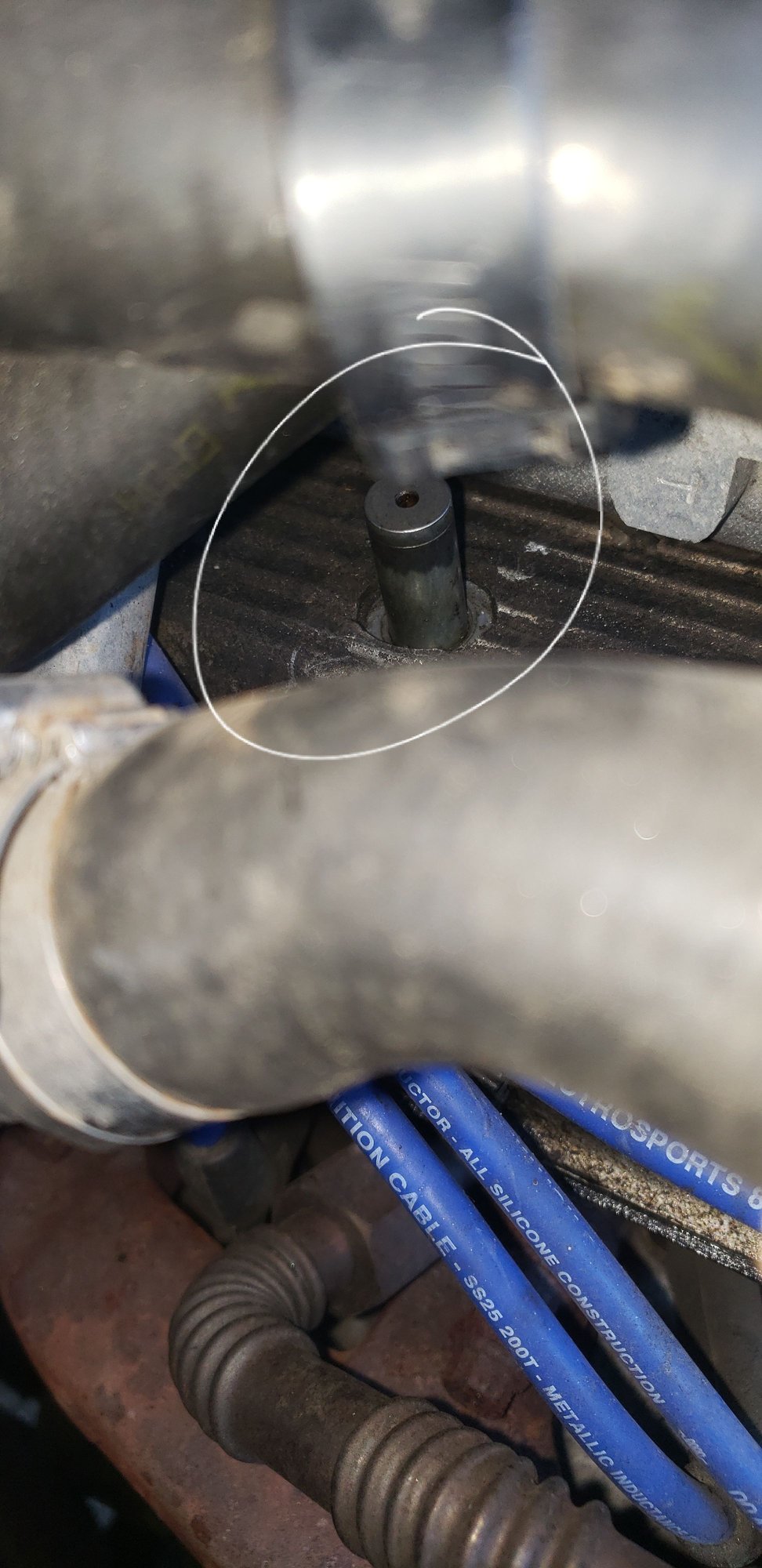

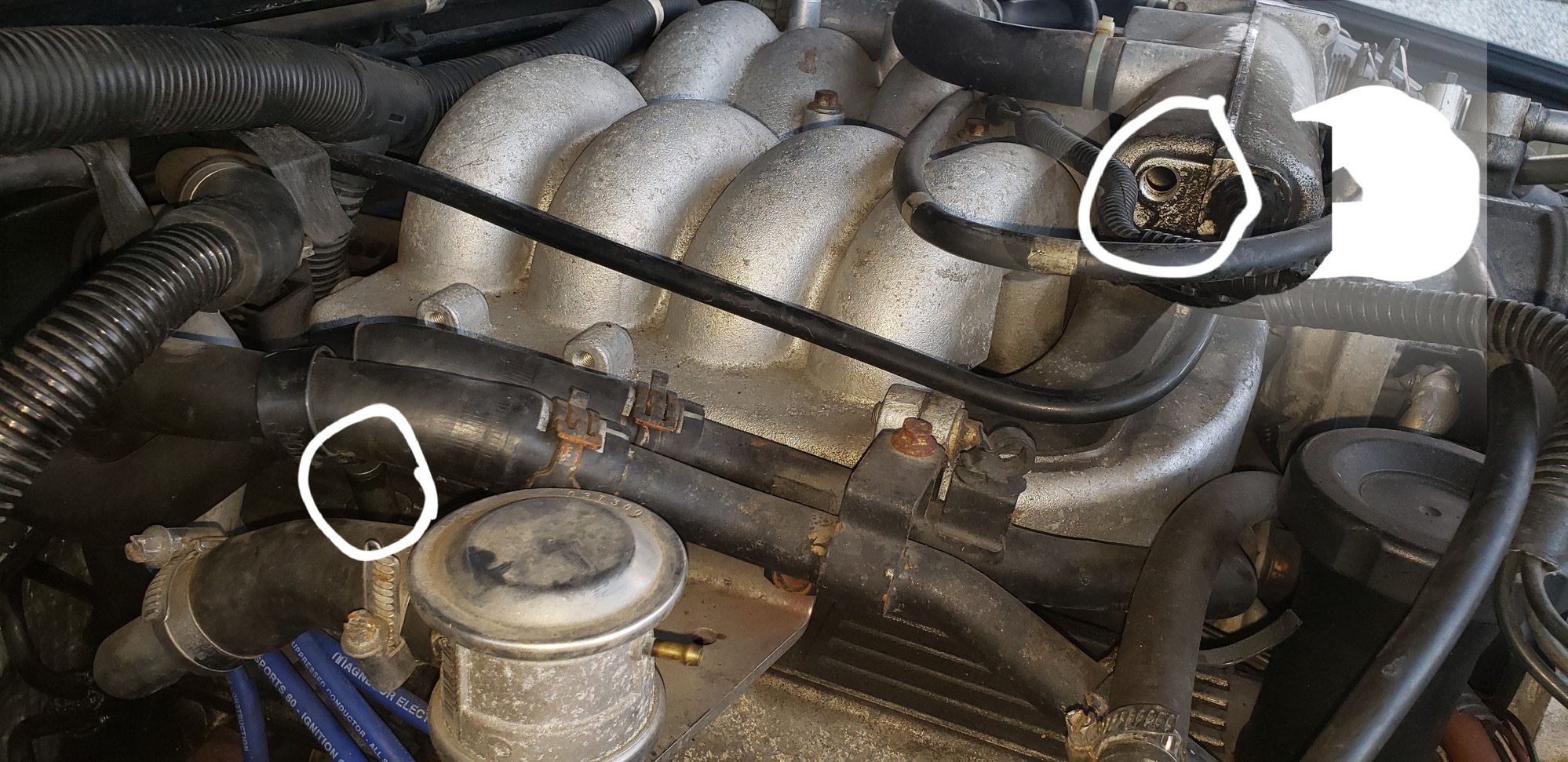

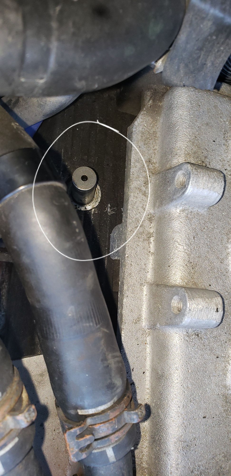

Default Whats this? 04 Discovery HSE US model
Was checking for a vacuum leak or clogged intake. Pulled off passenger valve cover hose to intake. This is what I saw. See photo A metal insert. I was expecting plastic AND if clogged was going to bore it out. I removed the plastic intake connector but didn't install the metal pcv just yet until Identify the part in photo if its a previous mod or genuine part. Or if I should remove then what to insert to use the pcv mod? Mine isn't clogged at least. I have gone 9yrs amigo free now it likes to show up on start up intermittent. I can shut it off and restart and 99% of the time it won't be back until the next cool down start. But swapped out the shuttle valve I had a spare and it still happened today. So will attempt some other diagnostic with a scanner later. And reattached rear 3rd brake light. Someone hit the rear end and it came off and dangled. Some reason it was never added to the insurance claim. Changed some turn signal lights that got knocked out but they are led and hyper flash not sure if that is excepted here in MA. No major issues tackled today. Still have frame work to do rear 1/4. Update found the answer in the best 4x4mod under someone's 03 post on the pcv mod shows that metal is the baffle but under a metal cap which needs to be pulled out then drilled out and remove the plastic insert and press back in and attach hose.

Posts: 3,823
Likes: 1,339
From: Mission BC Canada
Genuine D2's had that style
That is factory equipment in 03-04. Starting in 03 California significantly tightened emissions controls and LR put that restrictor in the valve cover tube with the baffle. It can easily be removed by grabbing the top of the tube with a pair of pliers and twisting it loose from the valve cover. Once removed use a tubing cutter to cut the restrictor disc out of the top of the tube.

Default What i am doing today is the best4x4mod pcv mod
Thx for all responses. Finished post will be up at some point. And using the tube cutter is a cleaner way to do the 03/04 version. Mine is an 04 4.6l.
