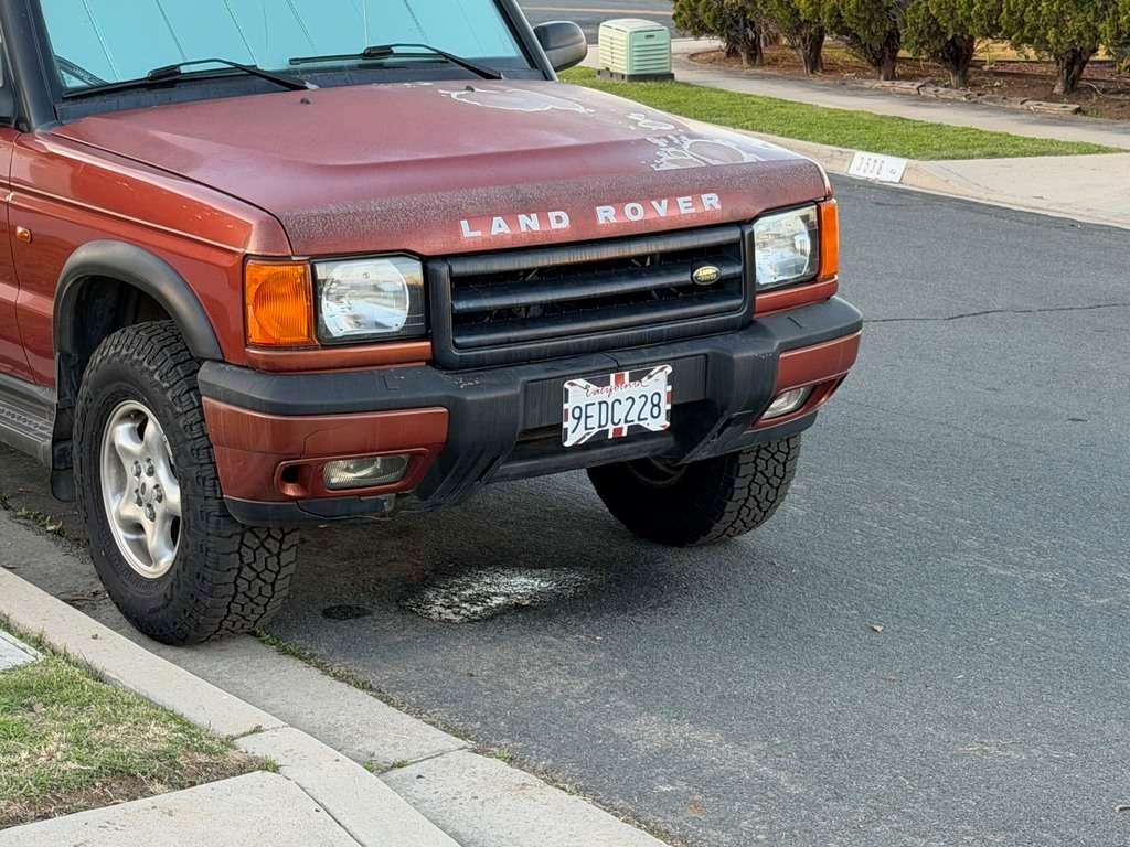

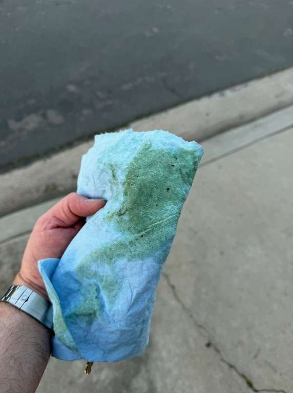

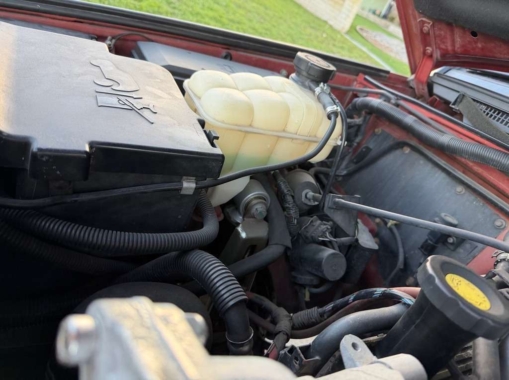

Went out to run errands and found a puddle under her. (Inset typical Discovery unreliability joke here). @longtallsally and I went over it via Facetime and I cannot figure for the life of me where the coolant is leaking from. When I drove it the day before I decided the power steering pump is on its last leg but that can't be it. On the last drive, she never got over 178.2 and rarely gets over 182 since installing the inline thermostat from @Extinct
I looked underneath and a few things look to maybe have some dampness but nothing to show the source. There is no fluid around the new Flowcooler water pump. The plastic line from the expansion tank to the radiator is solid. None of the radiator hoses look to have any issues and were all replaced when I installed the thermostat. My next plan is to pull the upper radiator shroud, fan and clutch, and lower fan shroud and run it for a few minutes to see if I can spot a leak.
Does anyone have any thoughts or area to look at before I tear her down?

Get the pressure test kit from advance auto and it will make it super easy to find, usually you can hear it.

That puddle is centered under your radiator. You sure you didn't accidentally puncture the radiator fins when replacing your water pump?

I don't think so. I could not figure out the leak so I had it towed to my mechanic. He pressure tested it and both ends of the plastic pipe that runs from the expansion tank to the radiator are leaking but not enough to cause that puddle. He's backed up but will dive in soon. He's also replacing the power steering pump
