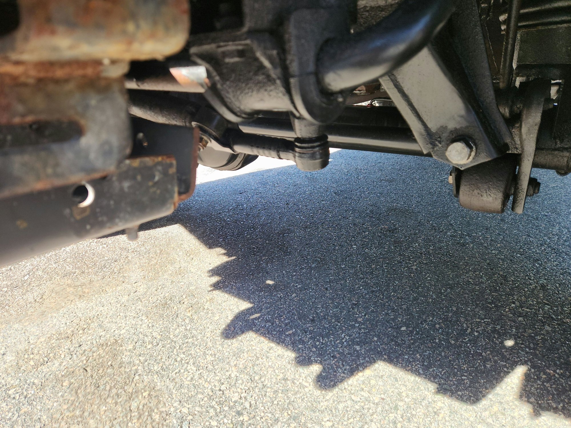

Finally NO DRIPS! Getting ready for upcoming 1200 round trip highway and lots of sand driving. Wanted to just get these last leaks done before going. Thursday getting it undercoated.
Now I can move on to fun stuff, like interior cleaning and installing the windscreen decal I made. Thanks to all in the many years of posting here, I dug up a lot of old threads to finish this chapter of repairs!

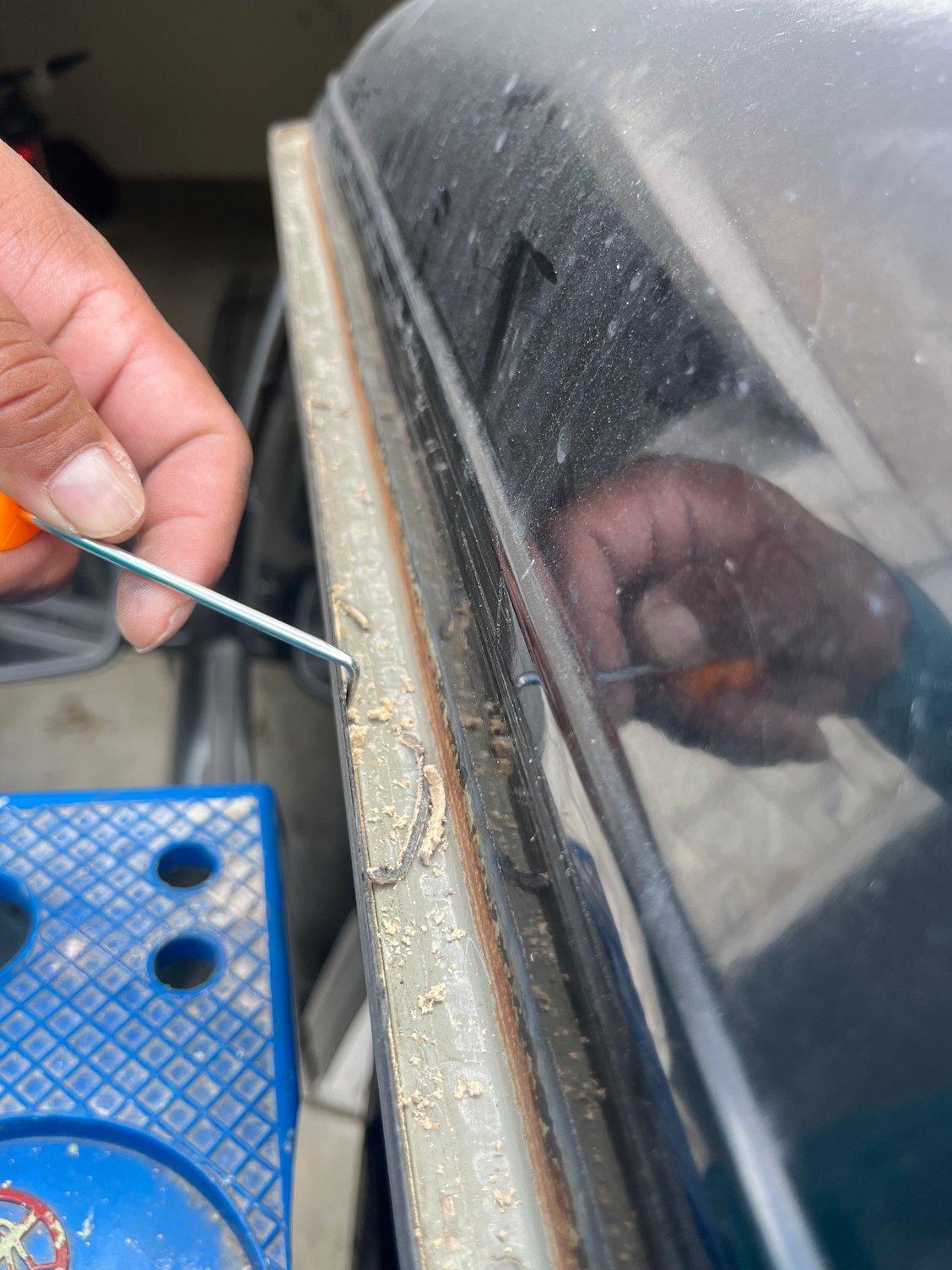

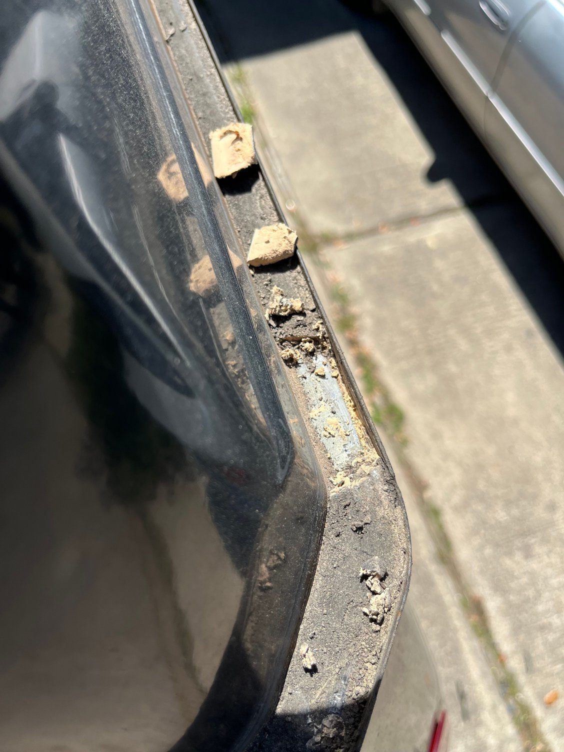

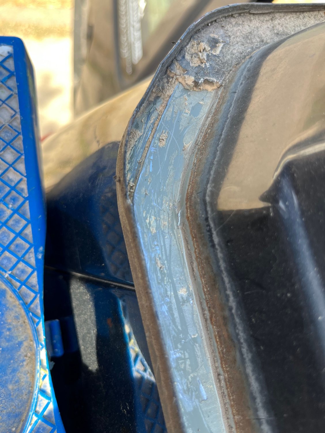

Finally! And such a simple fix and saved me a few hundred dollars or even a thousand. I managed to fix my AC by swapping out the original fuse box with another I had and just like and a press of a button the dang blower motor kicks on. This after spending $$$ buying and swapping out parts. And it’s all because of some rain water that leaked in from outside but oh I’m not stopping at the ac that was a quick and easy fix. I’m currently working on redoing the gutter and everything else that has a potential for leakage.
Then afterwards I went over the finer parts with a pick. Wasn’t much work to do for those of you thinking about doing it. I still haven’t gotten to the part of resealing it.
This honestly wasn’t too bad. It helped with a tool from harbor freight. It was a pack of nylon chisels that you can resharpen with a file. I got the smallest one but had to file the sides in order to fit snuggly in the gutter. Then you scrap it all out. I thought it faster than using a flathead our pick.

Alpine window are candidates for leakage.
