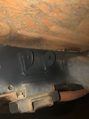

If you do add frame supports, make sure to allow for flex since they are also attached to the body. On mine, I just used a poly bushing in between the support arm and the frame side bracket. Also, my frame side mounts are welded on plate that's welded to the frame, so spread out the load on the thin frame rails.

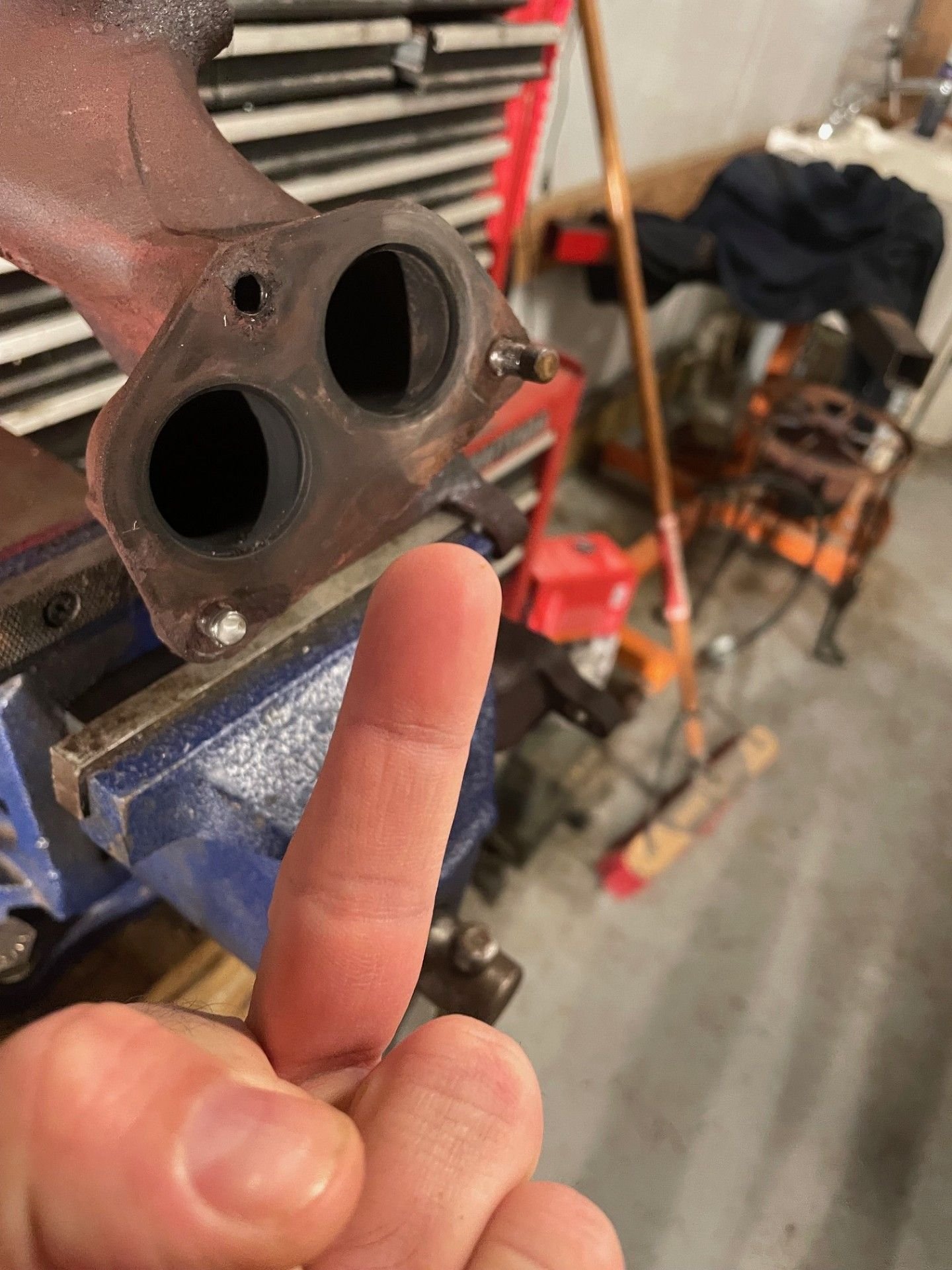

Removed the broken exhaust studs from the manifolds.
