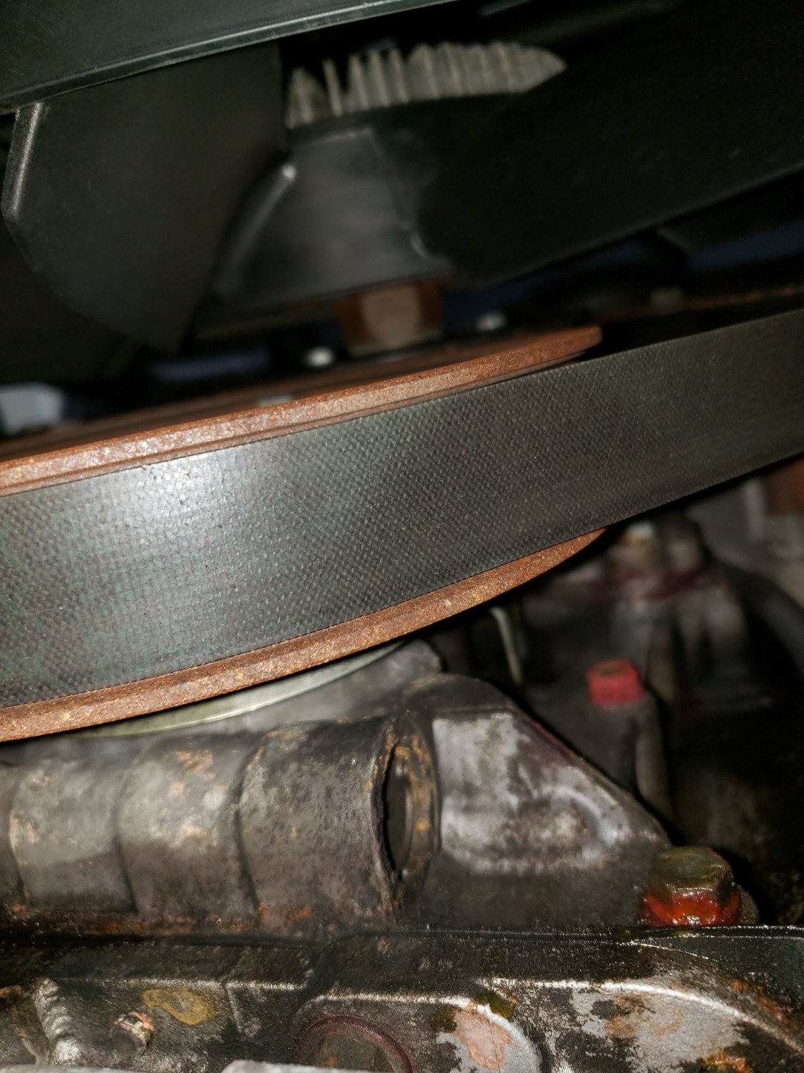

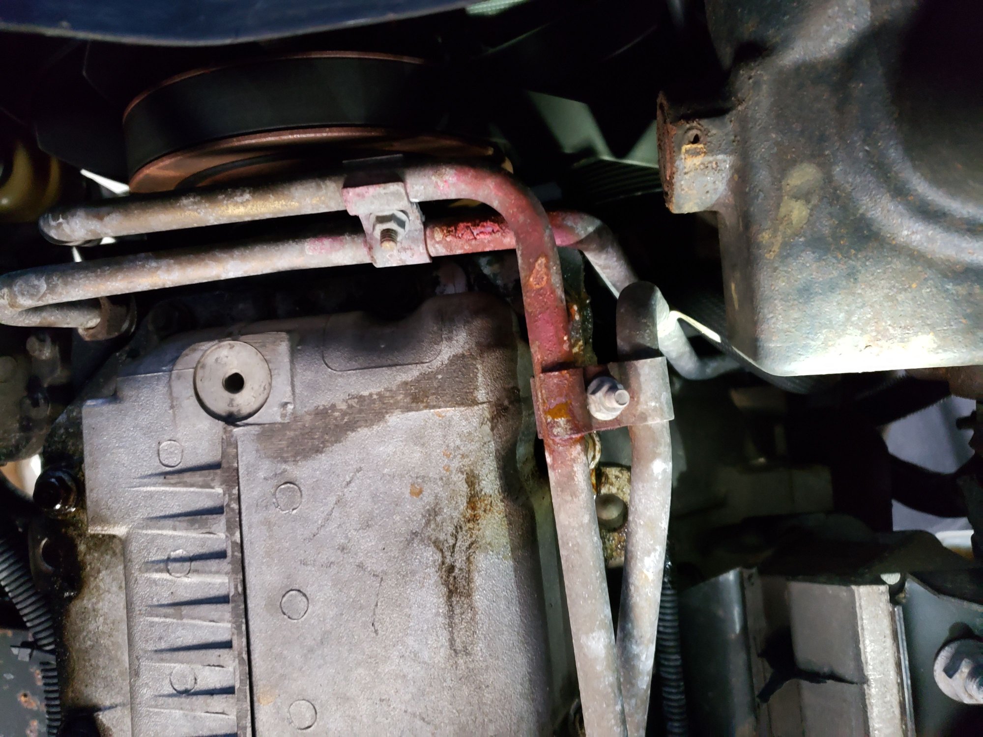

I have a 2001 Disco II. No ACE. ~70k miles. Excellent condition. After the extremely wet NY winter passes, I will be doing a number of jobs myself on it, mainly following a combination of @Disco Mike 60k suggested service and AB's schedule maintenance sheet/kits. However, right now I brought it to a shop to do an oil change near my home (they used a Quaker state filter... next time I do it myself) and when the guy put it on the lift, we noticed some red (probably coolant) stains. I think it came from the water pump... But when I run the car in my driveway, regardless of time, there are zero drips from the vehicle. And so, it's hard to tell where the problem might be. Here are pics I took from under, including sliding my phone above the pan that was blocking my view. What do you recommend? Thanks

That is an awful bright red for rust, it looks more like you picked something up off the road. Do you use a bright red Anit-freeze ?

No. The guy that was working on my oil change said he thinks it was coolant from the water pump area, not rust.

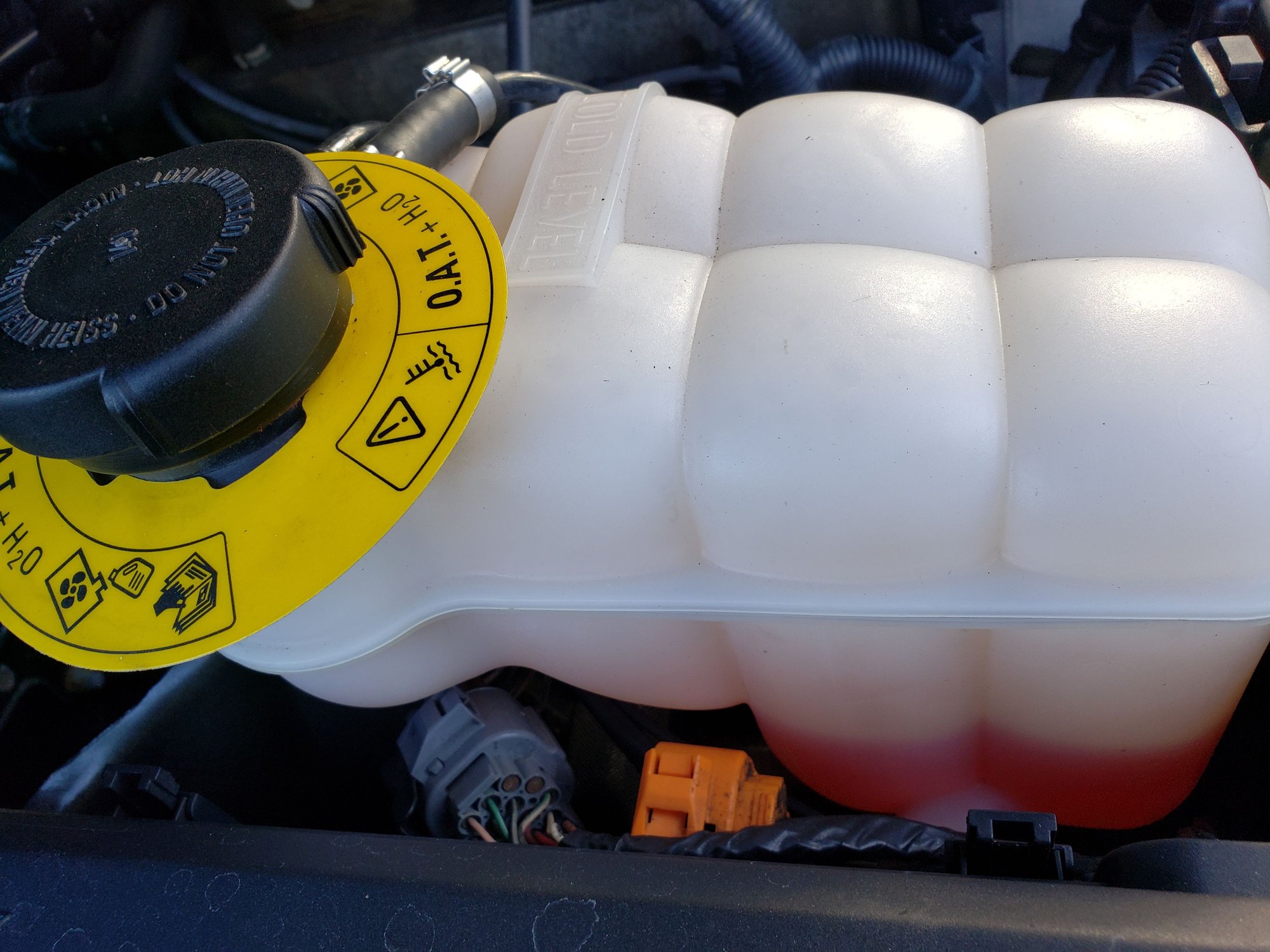

What color is the coolant in your overflow tank?

It's looks orange/reddish

Boy, that's pretty clean under neath, rust wise, for a rover that has lived its life in NY state. Looks like the water pump is leaking. Look down from the top, between alternator and a/c compressor (upper-passenger side) and you will probably see the same redish fluid stains coming from the weep hole on the pump.
The hardest part of the water pump job is getting the fan off, but usually a couple good whacks with a long punch, on the lobe of the nut in the right direction breaks it loose, righty tighty - lefty loosey. Then the rest is duck soup. There are three long bolts, 11mm heads, that go into the block...the rest are 10mm heads and just bolt to front cover. Get yourself a wire-wheel attachment for a cordless drill...makes cleaning the gasket off a breeze. Use Prematex gray ultra on the gasket, both side.
When refilling, refill through the T above the radiator, first the long hose that goes to the rad, then through the T to the upper intake and thermostat. Reassemble hoses and finish filling through reservior. Run to temp, let it cool down and check fluid, usually have to top off a little more coolant, run again and recheck.

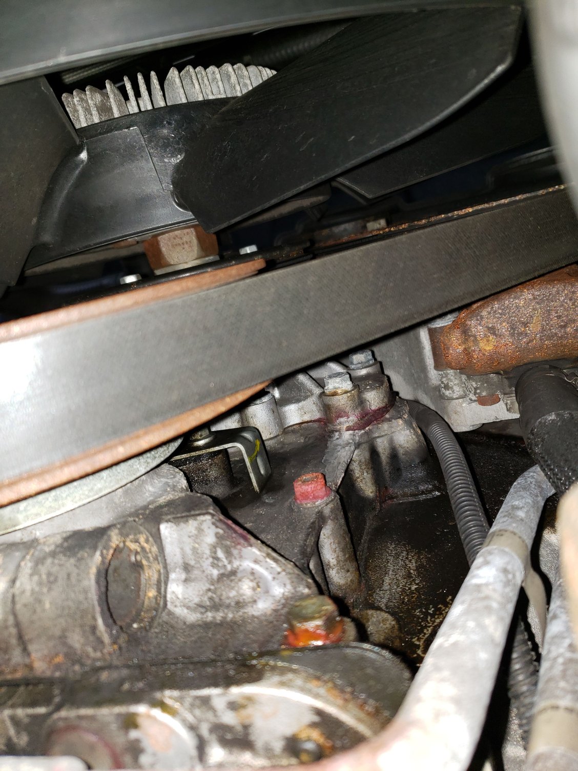

Am I looking in the right place? I am not seeing any stain or drip with that color. Perhaps this is the very early stage of water pump needing a change?
Here is the color of the coolant.

I've been told by TD5 owners that the orange DexCool coolant turns pinkish when mixed with water.
Then it turns reddish at an area showing signs of a coolant leak.

I’d personally tighten the 3 long bolts on the waterpump (bolts that go thru the timing cover & into the block/water jacket). Leak seems pretty small, top off the coolant (it’s low), and then keep an eye on it. Then if it leaks again replace the water pump.

If you can point me into the direction of three bolts that would be great.
