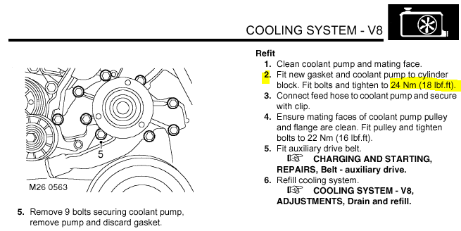

Torque specs are great, but on a water pump I’d personally say #1 & #4 are the most critical. Bolts can be at properly tightened & it can still leak like crazy if #1 & #4 aren’t done properly.
I’ve honestly never got a torque wrench out for anything besides HG TTY Bolts, Lug Nuts, and a few other misc things. The rest I use good judgement. My dad on the other hand would just tighten something & then go grab a 3ft cheater bar lol & snap crackle pop! 5min repair turned into $$$$. I did in fact learn from him = don’t do that!! lol

Where is this documentation from? This stuff would be useful as I take on the DIY projects.
Old Feb 21, 2019 | 05:36 PM
  #34
Llamasayswhat's Avatar
Joined: Nov 2017
Posts: 450
Likes: 81
From: Kailua Kona, HI
thats out of the Rave manual
