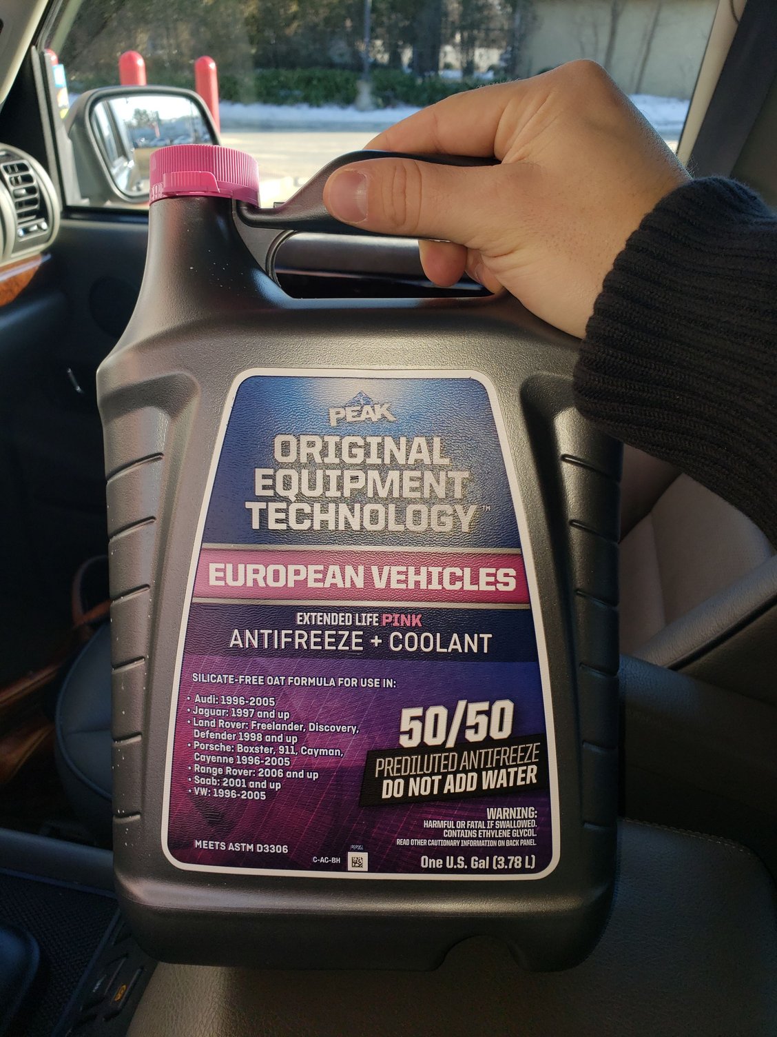

Is this ok to add?

I personally think your color looks more red like Toyota coolant, G40(the pink stuff) does not usually look that dark when it leaks and leaves deposits. But photos are deceiving.
Odds are yes, that is the right stuff. Most euro shops will be using that for almost everything besides BMW and some Mercedes vehicles

Is there any harm in topping off with this stuff, even if it ends up that I had the Toytota red stuff in it? I plan to change it probably in the next month anyway.

No, that's the wrong coolant. You need Dexcool for GM vehicles.

I wouldnt waste money adding any when you're going to wind up swapping coolant.
drain that trash out, flush it, and add green at your earliest convienence.
