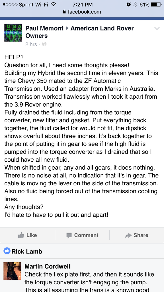

Just read this. Thought of you.
He has a dipstick so that's a hydraulic zf. Yikes. He's a worse mechanic than me!
