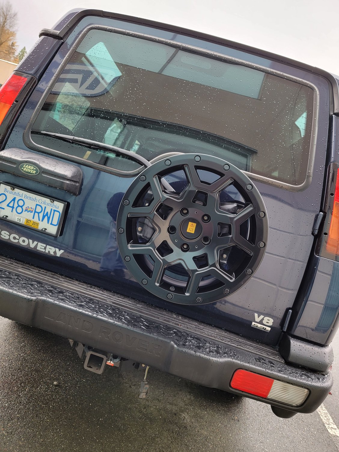

I recently purchased a set of wheels, and I am worried that the lug hole in them is only 12mm.
Wondering if anyone has dealt with this before and what to do if they are 12mm. (D2 is 14mm, wont fit)
Ideas in my head;
Safest/Smartest? Knock out the studs on the hub and replace with something like this
Amazon Amazon
or drill out the wheels.
I think what I ordered is non refundable and I'm worried I just boned myself.
Any suggestions are appreciated, Thank you!

I think talking to an actual good tire shop, drilling would my choice. But that may not be an option.
I know this late but almost nothing aftermarket fits a D2
If they were stated to fit you may be able to force a return via your CC

Well, hopefully I have a leg to stand on with a return...I just ran it through the website again with my vehicle selected and it says it will fit.
From what limited information I have been able to find about this brand though, I have a strong feeling they are 12mm and wont fit.
These are some nice lookin wheels so I hope they do actually fit..

Well according that they should fit. The thread they fit is supposed be M14x1.5 which is what a D2 has so with luck you are good.
Black Rhino website says this fits 1780VRL355120M76

It Fits!!
Only problem, which was expected...Stock Lug Nuts do not fit. I have a set on order but dont have them yet, should be fine.
So these were 17x8 Black Rhino Overland with 35 offset.
Should have my exhaust and lift installed within the next 2 weeks...Then we'll get some sexier pics posted

Chevy lug nuts are M14x1.5 and are available almost anywhere. I also have a set of Black Rhino wheels on a D2 & zero issues.
Old Nov 10, 2021 | 06:21 PM
andino's Avatar
Joined: Apr 2021
Posts: 346
Likes: 124
From: sfbay
Most aftermarket wheels won't be able fit stock lugs nuts as they're designed for tuner lugs or acorn style nuts instead of the OEM style.
